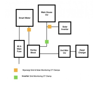

The sure way to stop your Zappi discharging your home battery is to fit it in such a way so that the inverter doesn't see it as house load - This is done by fitting a Henley block which splits the feed coming out of the smart meter - one feed goes to the house, the other to the Zappi charger - I don't think the extra CT clamps will help.Jonesey wrote: ↑Fri Mar 01, 2024 11:30 am I'm having the same issue, ordered zappi from Octopus EV and charger was installed by sub contractor and not an Octopus installer as expected.
Zappi discharges home battery first unless I charge home battery at the same time, not easy when IOG has charging sessions outside of 23:30 - 05:30 window and as the lighter days are approaching I don't want to charge the home batteries every night. Called Octopus EV and complained and was asked if the installer had installed an extra 2 CT clamps which I confirmed they hadn't, just the one that came with it. Octopus customer advisor expressed surprise that this had not been done and has confirmed that a revisit will be required to install 2 more CT clamps. Revisit will be foc as normal practice to install extra clamps when solar/batteries are on site. I'm still waiting, now over 3 weeks for the revisit to be booked.
i've attached a schematic which shows this, hope it helps.

Yes it is the addition of the Henley block that splits the two feeds, the CT clamps would already be fitted but because the inverter is seeing the load from the Zappi as house load it will discharge the battery.Digger wrote: ↑Fri Oct 11, 2024 3:05 pm I have the same problem with an Octopus installed Zappi and wonder if either the 2 extra CT clamps or Henley Block solved the above? It would be good to know before I engage Octopus Customer support.

If you add a Henley block to the live tail from your smart meter and split it so the house load and inverter is on one side, and the Zappi on the other (as per that diagram), your inverter will no longer see the Zappi as load.
