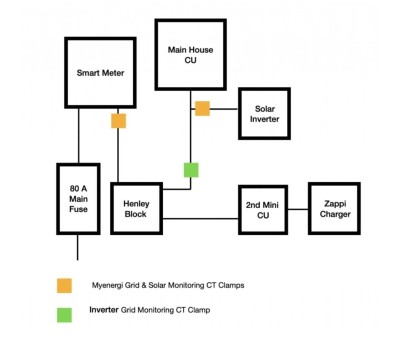

The sure way to stop your Zappi discharging your home battery is to fit it in such a way so that the inverter doesn't see it as house load - This is done by fitting a Henley block which splits the feed coming out of the smart meter - one feed goes to the house, the other to the Zappi charger - I don't think the extra CT clamps will help.
i've attached a schematic which shows this, hope it helps.

Yes it is the addition of the Henley block that splits the two feeds, the CT clamps would already be fitted but because the inverter is seeing the load from the Zappi as house load it will discharge the battery.
If you add a Henley block to the live tail from your smart meter and split it so the house load and inverter is on one side, and the Zappi on the other (as per that diagram), your inverter will no longer see the Zappi as load.
