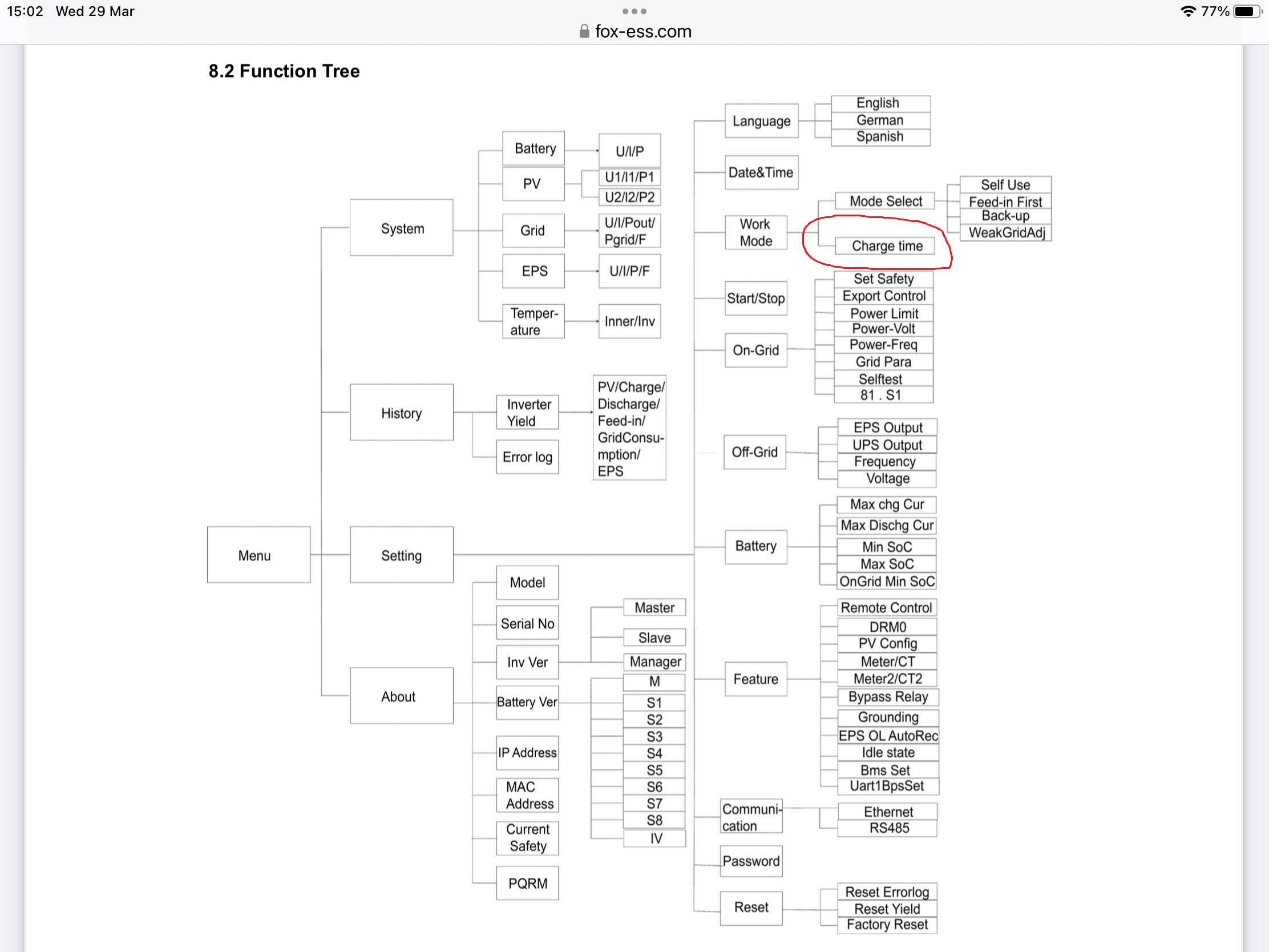

Luckily I have quite easy access to the inverter and can set my charge from grid times and SOC on there.
From the display on the inverter.
Page 32 in the user guide contains the menu tree how to get to charge times and SOC settings.
I have the H1/AC1
Menu > settings > work mode > Charge time.
Menu > Settings > Battery > min SOC, Max SOC, ongrid Soc.
I have the H1/AC1
