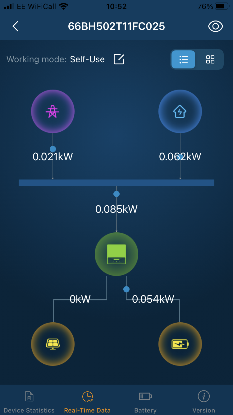

PV, inverter and batteries work perfectly, but charge shows on App as coming from load rather than from PVs. Have been talking to Fox, but unresolved. Have tried reversing ct, which totally threw system. Any clues?

Many thanks, the ct for the inverter is the white one, the black one goes to ev charger. As I say system works perfectly, just doesn’t show the PV charge as coming from PV
Your CT clamp is in the right place, but as you say the app is not showing any solar generation - the question is, is it a graphical 'app' problem or a system problem in which case we need to have a look at the solar output of the inverter.

Thanks for help. Not much sun around this morning, but here are the two device pages. Will wait for sun to do Pc1&2
No matter which way I look at it, not much sun this morning, the PV output registers as negative on the load rather than positive on the panels. It does work however ie charging my battery.
Ok I would normally say that the CT clamp is fitted the wrong way round as you are showing power coming from the house load which is impossible, but what throws me is that there is absolutely no activity showing from your solar - as you say there isn’t much today but i’d still expect 50-100w from your array.
The PV (solar) is an internal sensor to the inverter and if it is getting those measurements wrong then the only possible answer is that there is a fault within the inverter on it’s DC current sensor.
