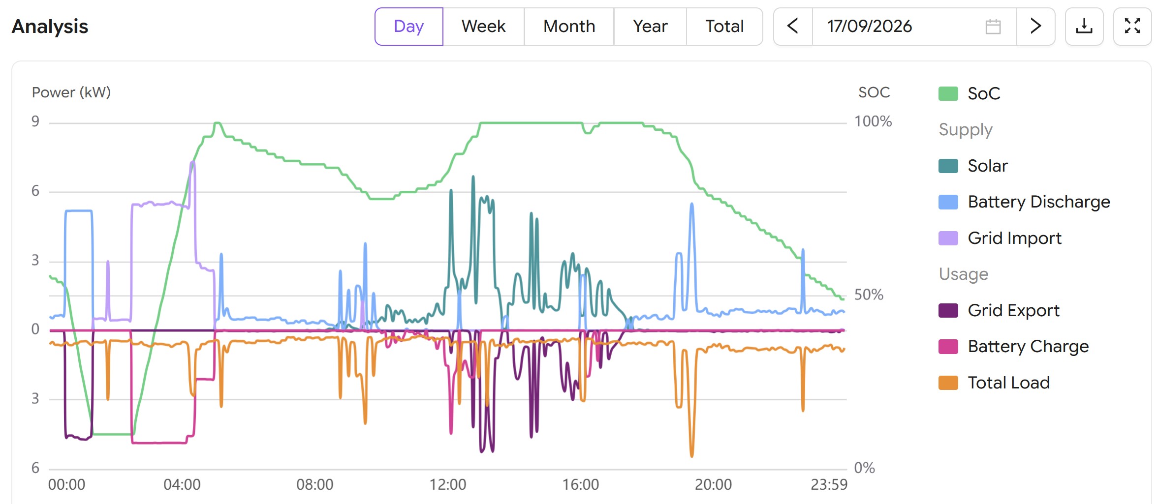

I have a system comprising 14 x 475W new this year Aiko panels in 2 strings of 7, all facing south with no shadowing at all....I am finding that early morning and late afternoon the PV falls off dramatically
example from this morning - and apologies for the disgusting state of my windows! - I am generating a lowly 345W
literally 10 minutes later and I am generating 2.8kW....same apparent level of sun, no cloud, light level looked the same
In the afternoon it is the same in reverse.....plenty of sunlight left although it is not now shining on the panels, generating over 3kW, 10 mins later maybe 500W then nothing
I would have expected to see it dropping off more gradually over a longer period

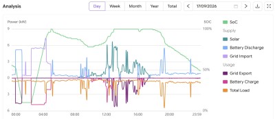

Best to show a power graph for the day in question, and some previous day(s) that show the nice curved generation if you can find one. You wouldn't normally generate that much power so early in the morning, only if the panels were cold would you see the 2.8kW. Viewing the power graph would show that as being a 'Spike' I would think, and much lower either side of that time stamp.

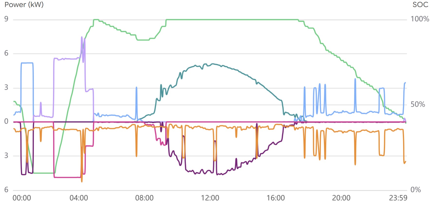

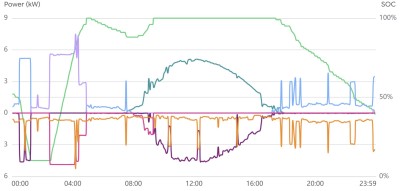

I was a bit sidetracked this morning with front door, and I see Dave has replied, I will post the pictures I made to show a visual representation.
Here are my screenshots I took for readings for a few days ago (perfect solar start)
You can see the Inverter does not make Power until ~07:40, it tries to start the solar generation before this point as you will see in the Voltage picture, only when the current reaches ~0.5Amps does it generate power.
PV1 - Power PV1 - Voltage, note the repeated attempts to start the string before 07:40 PV1 - Current
Thank you for your previous image, the overall picture was exactly what I was expecting to see (spikes)
