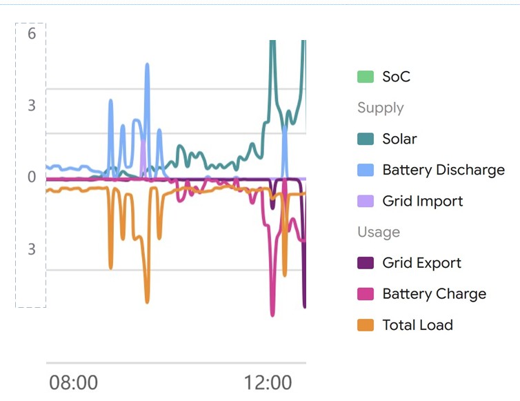

I have a system comprising 14 x 475W new this year Aiko panels in 2 strings of 7, all facing south with no shadowing at all....I am finding that early morning and late afternoon the PV falls off dramatically
example from this morning - and apologies for the disgusting state of my windows! - I am generating a lowly 345W
literally 10 minutes later and I am generating 2.8kW....same apparent level of sun, no cloud, light level looked the same
In the afternoon it is the same in reverse.....plenty of sunlight left although it is not now shining on the panels, generating over 3kW, 10 mins later maybe 500W then nothing
I would have expected to see it dropping off more gradually over a longer period

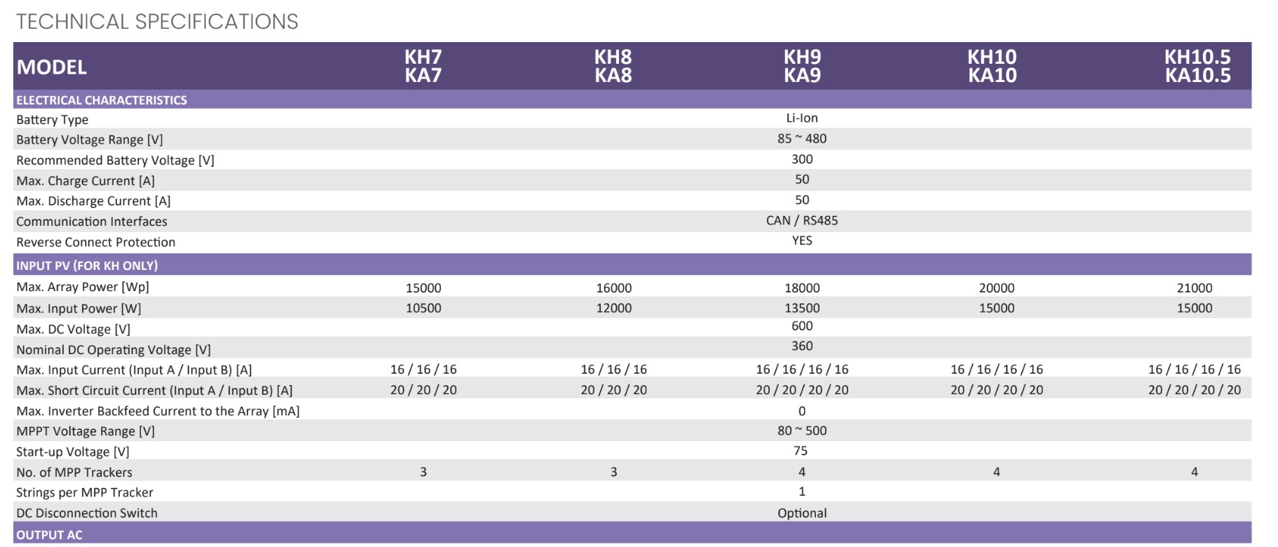

I am not convinced the MPPT settings are working as I happened to notice the specs for the inverter say the startup voltage is 75V, the MPPT input is 80 - 500V.....but even at 8am when the panels show 200V there is no no current or power draw

Best to show a power graph for the day in question, and some previous day(s) that show the nice curved generation if you can find one. You wouldn't normally generate that much power so early in the morning, only if the panels were cold would you see the 2.8kW. Viewing the power graph would show that as being a 'Spike' I would think, and much lower either side of that time stamp.

I appreciate that there isnt much solar early in the morning but the live section in devices shows around 200V on the panels and the spec says it will start to generate at 75 - 85V ....so as I read it there should be enough to generate more than it is.....remember we are talking about 14 x 475W panels which is a vast area of PV to only be generating the few measley watts that it is

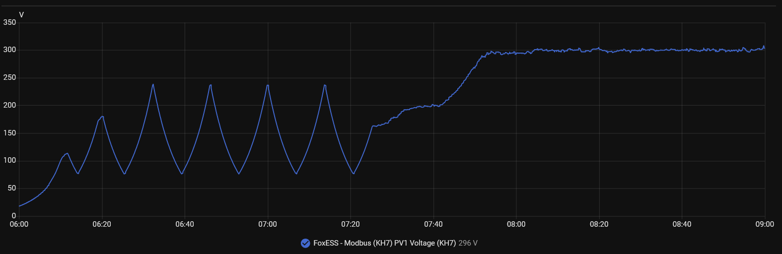

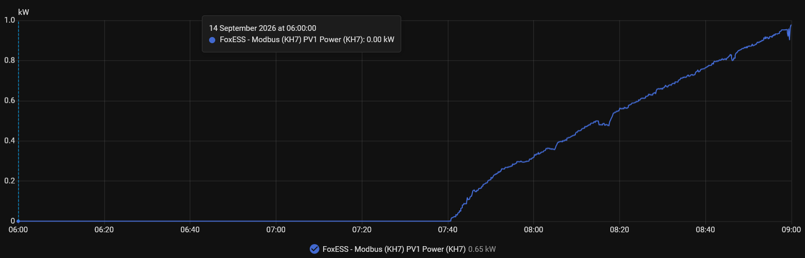

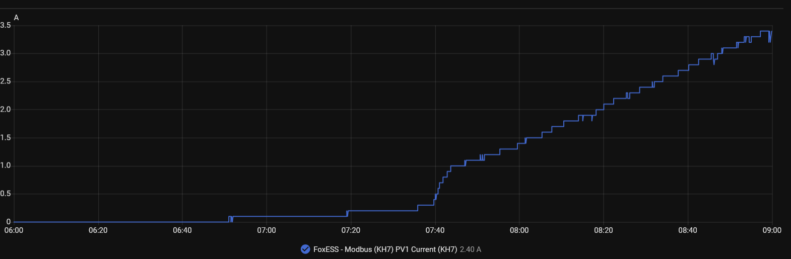

Sadly start up voltage and power are 2 distinct things and you need both to start, the inverters MPPT balances the voltage vs current to get the highest power point but if there is not enough current the voltage will collapse and the string won’t attempt to start up - that’s why you can have enough voltage but no power, the panels are effectively connected open circuit.davidwf15 wrote: ↑Fri Sep 18, 2026 12:46 am I appreciate that there isnt much solar early in the morning but the live section in devices shows around 200V on the panels and the spec says it will start to generate at 75 - 85V ....so as I read it there should be enough to generate more than it is.....remember we are talking about 14 x 475W panels which is a vast area of PV to only be generating the few measley watts that it is
