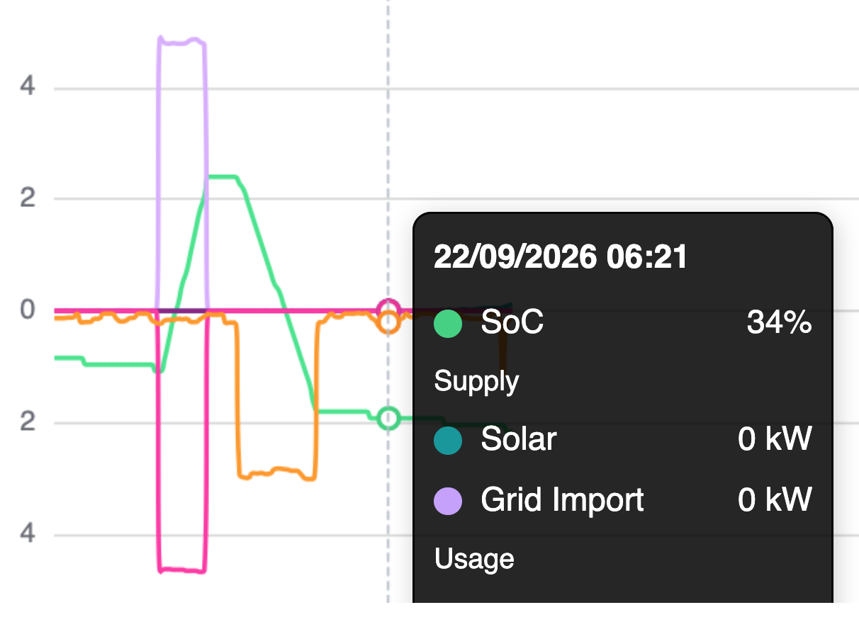

Set Forced Charging for my battery SOC 60% night-time cheap electricity: 0000h to 0530h.
Woke up this morning - battery at 30% only.
Checked battery stats - it had charged to 60% but dishwasher, washing machine etc. on timer subsequently drained battery in early hours of morning.
Newbie error - inverter defaults to Self-Use when my SOC 60% is reached? Thus, my later timed wash drained the battery?

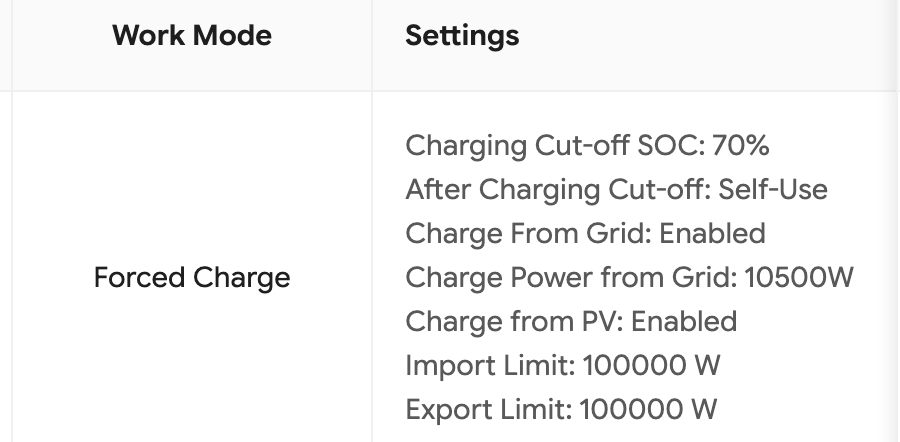

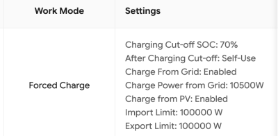

I had the similar problem. The battery was set to force charge between 2am and 5 am, with self use selected for after discharge.
But my hot water was also set to heat up at 3:30am till 5am. I thought that my battery would keep charging from the grid whilst the grid also powered the hot water.
What actually happened was that the battery charged from 2am as planned but at 3:30 when the hot water heater came on it took all of it's power from the battery?

In your situation where you have a force charge (low import rate) slot where you also are running a high drain device you need to set "After Charging cut-off" to "Standby". This will stop the inverter feeding the load for the remainder of the force-charge slot, preserving battery charge and ensuring your load is supplied with cheap rate electricity.
With it set to 'self-use' as you have seen once the battery reaches the charge cut-off point the inverter switches back to self-use and then feeds any load.
A very rough general rule would be to set cut-off behaviour to "Standby" for force charge slots and to "Self-use" for force-discharge slots.
