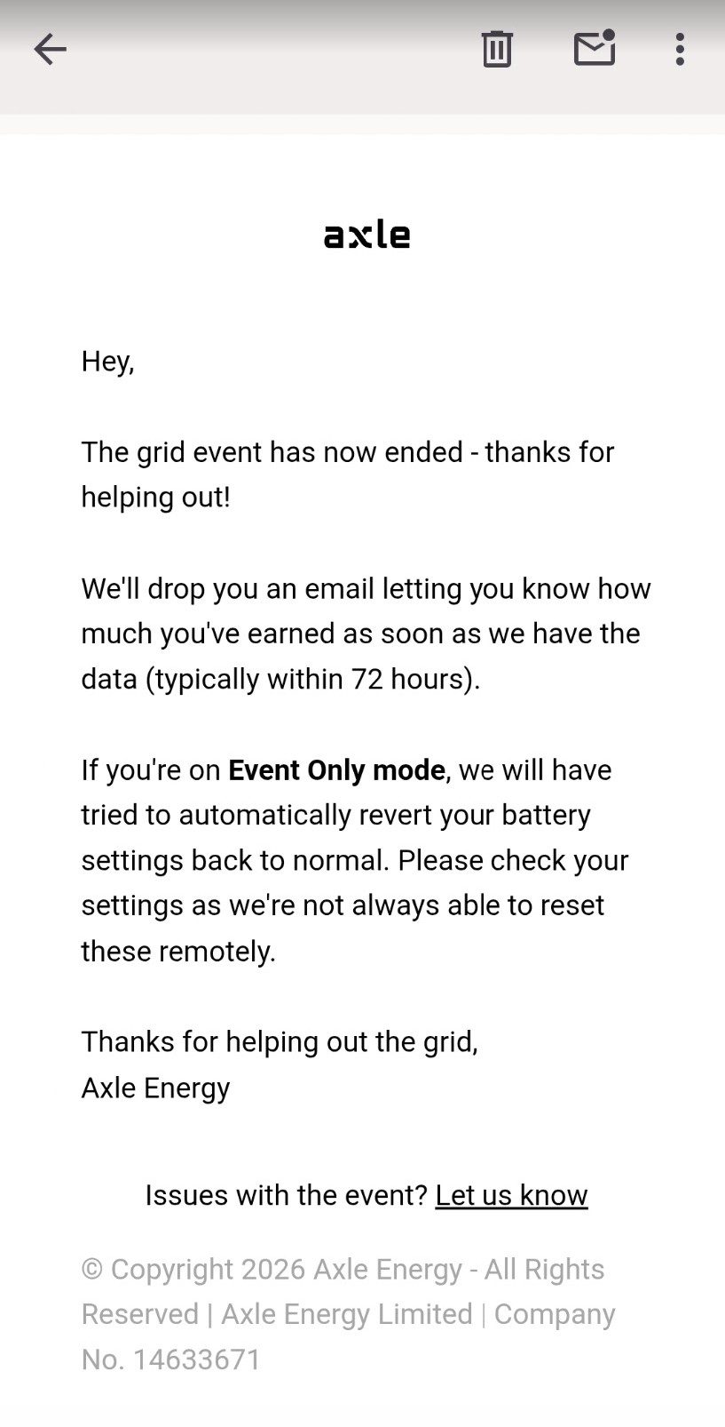

All they could offer was this

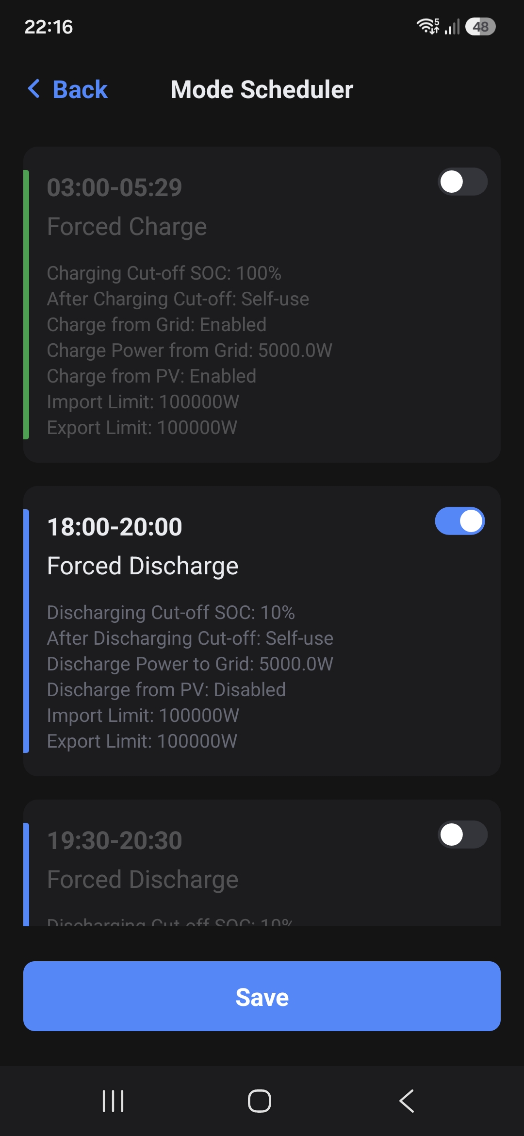

For me, in the FoxCloud2.0 App, the existing time slots programmed are not removed. They are 'turned off' via a slider, so next time you see an event, and it finishes, can you take a picture of your mode scheduler and see what is there?

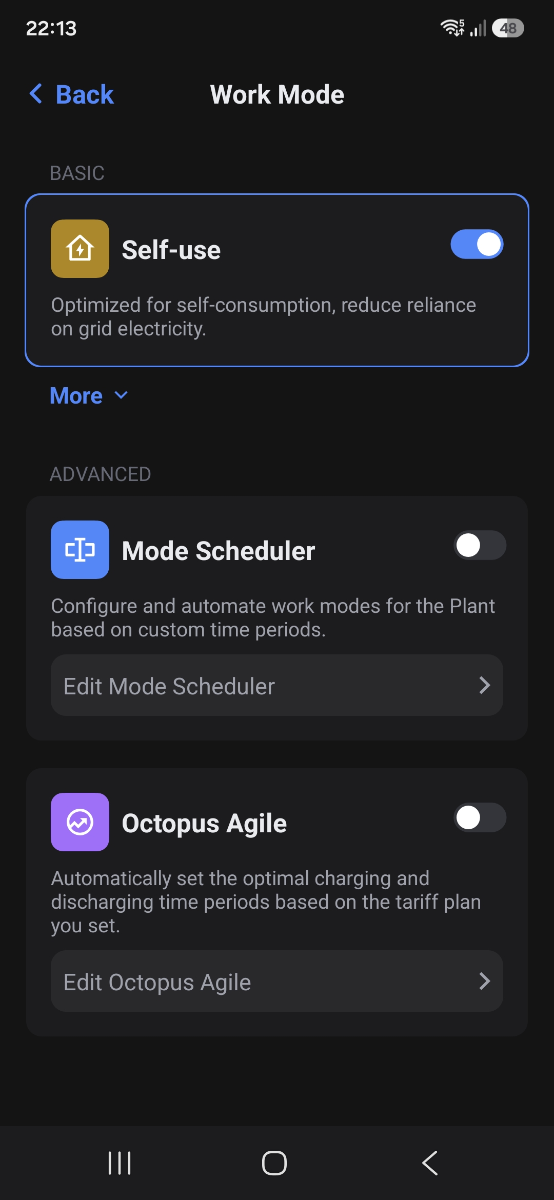

It has returned to self use.....surely it should be mode scheduler IN self use mode.....
FOX KH7 7kw hybrid inverter
EN-EPS-BOX-SP gateway
Mine pops back to Basic Self-use, seems that yours does too.
At least you just need to enter the advanced mode and just toggle the exist schedules on again (you can erase the 18:00 - 20:00 they added)

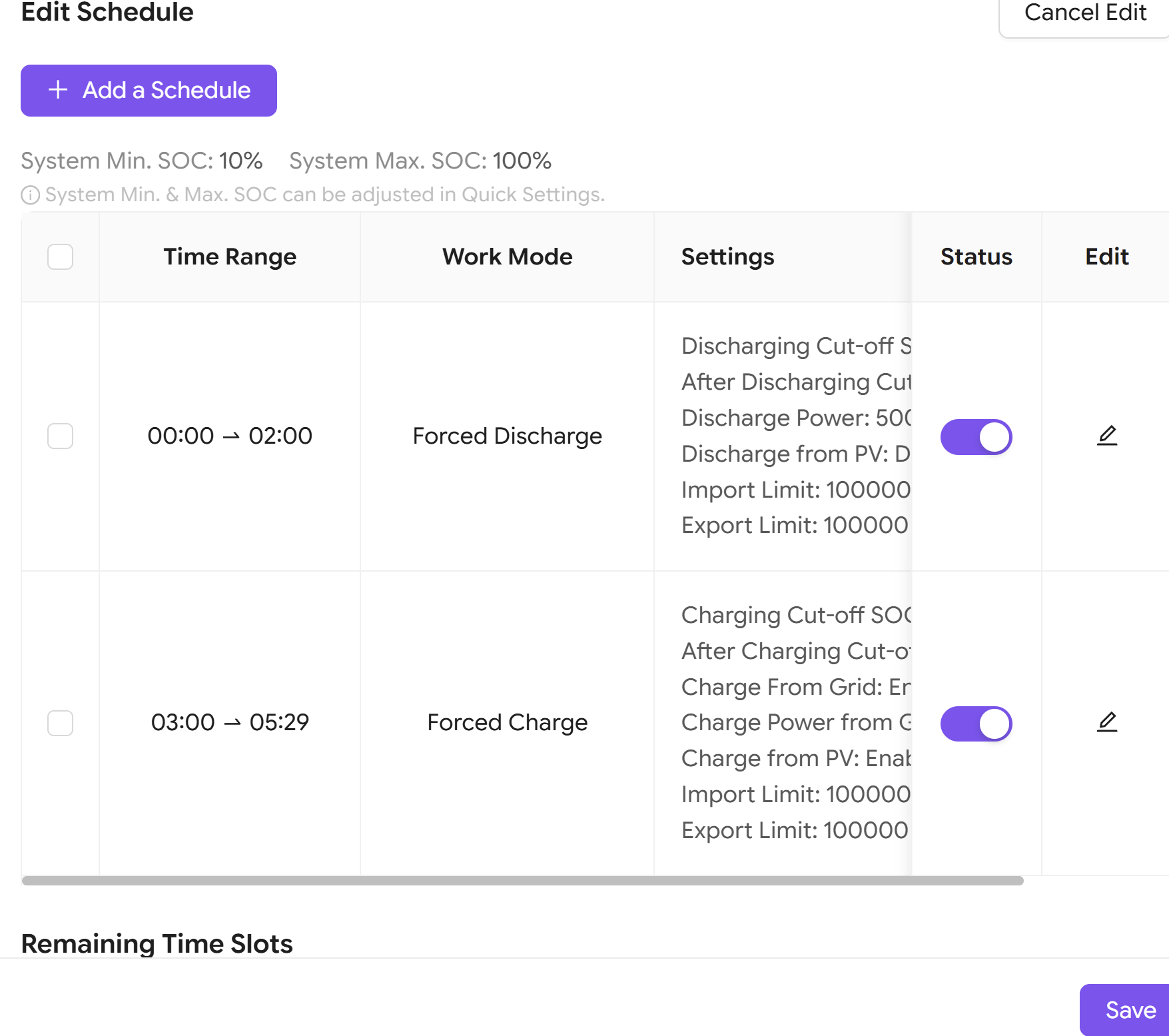

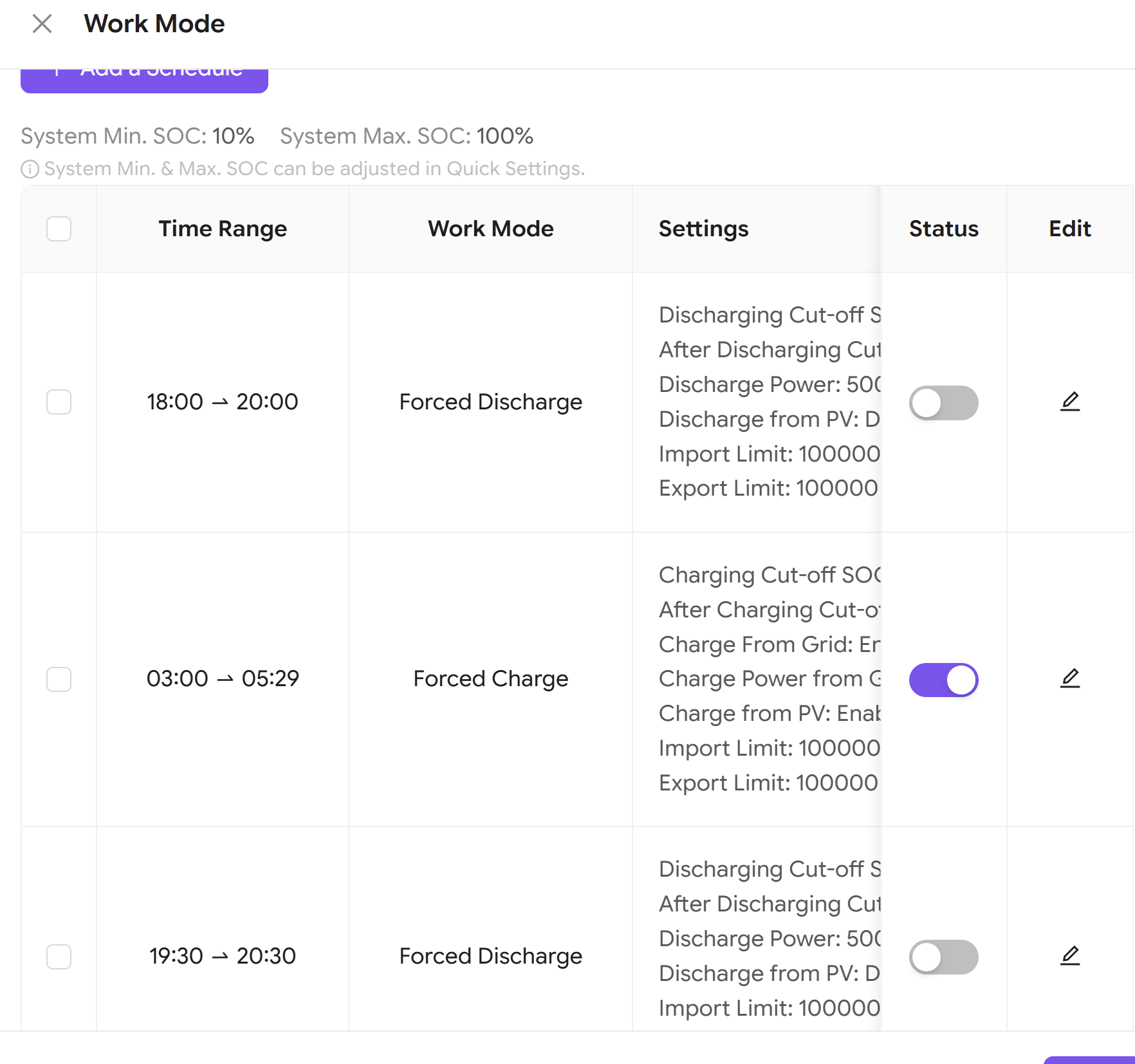

After tonights discharge the Axle system has again deleted (or changed) the forced discharge schedule I had set up.....and also set it back to self use rather than returning it to mode scheduler as I had it.....
PRIOR to the event I had a forced discharge set between 00:00 and 02:00 and a forced charge set between 03:00 and 05:30 as below
After the event it has changed (or deleted???) my forced discharge schedule and also left previous Axle schedules in the list although not active
