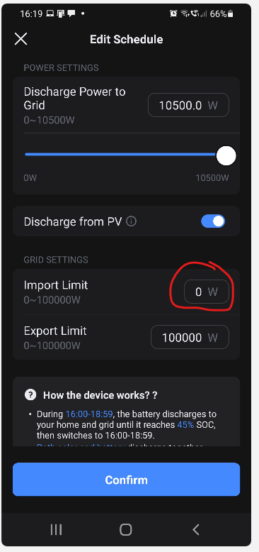

I thought that the export clitch had been fixed in the App update a few weeks ago? But no it hasn't. The export doesn't stop based on the battery % it still waits for the end time of the Mode Schedule Any ideas or are we back to manually turning the schedules off based on our battery charge % prior to the Forced Export period?
Re: Force discharge setting overrides battery
I now have this setting in the Forced Discharge config - the max import power. I set it to 0 W and lo and behold my system now runs off battery when min SOC is reached during forced discharge, rather than drawing from grid.
