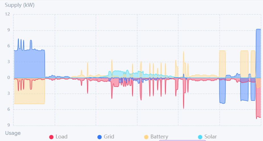

After getting the force charge working again due to the mode scheduler randomly switching it off, I now have a new problem. The mode scheduler all looks correct (looking on app and on website). But I noticed yesterday evening when it should have been in a forced discharge period, my smart meter showed it was drawing from the grid.
In the evening, I have three forced discharge periods to get the battery down to 10% in time to recharge fully overnight. At 8pm It discharges for 2 hours or until 48%, then at 10pm for 1 hour to 24%, then at 11pm for 30 minutes till 12%. When not discharging because it has reached the level, it then used to supply the house from the battery as expected (see pic 1 from 27/2/26).
But since then, when it's not actually discharging, the battery doesn't supply the house - the inverter instead draws from the grid, at the expensive rate (see pic 2 from 3/3/26 - between the three yellow peaks on the right above the line it is now dark blue instead of yellow - it's using the grid, not the battery). This is not what I want, and not what I set it up to do.
Is this another problem from the latest software update? It certainly coincides date-wise. It doesn't seem to be a mode scheduler issue as that all looks correct. It's discharging during that period, but then when it reaches the cut-off threshold it then doesn't behave correctly.
Any ideas please?

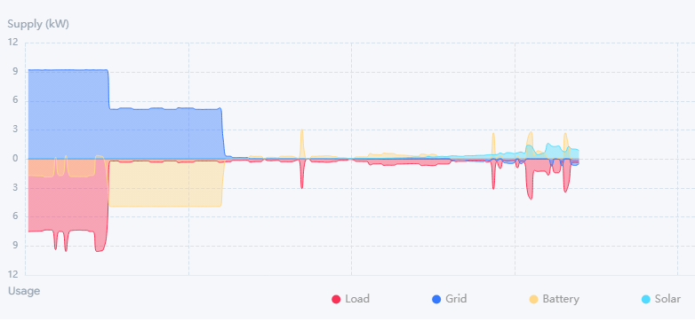

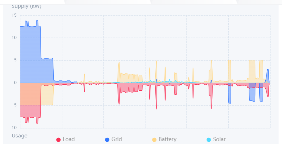

In fact, it's still not charging properly either. Again it's kind of doing the right thing according to the mode scheduler, but if you look at the early hours of the morning of graph 1 above, you'll see the EV charging at 7kW, and the battery at 5kW.
Compare that with this graph for this morning (below). While the EV is charging, the battery isn't so much - it only really gets going when the EV stops.

You may need the reboot on your system, but you should go to your Inverter menu ideally and check the Import/Export limits are set correct, and the Battery charging/discharge limits are correct.
It seems your system has limited grid Import, this will be why your battery was limited and then increases as the car charge finishes.
