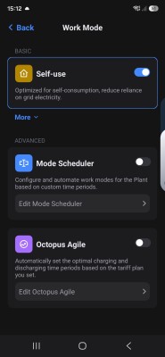

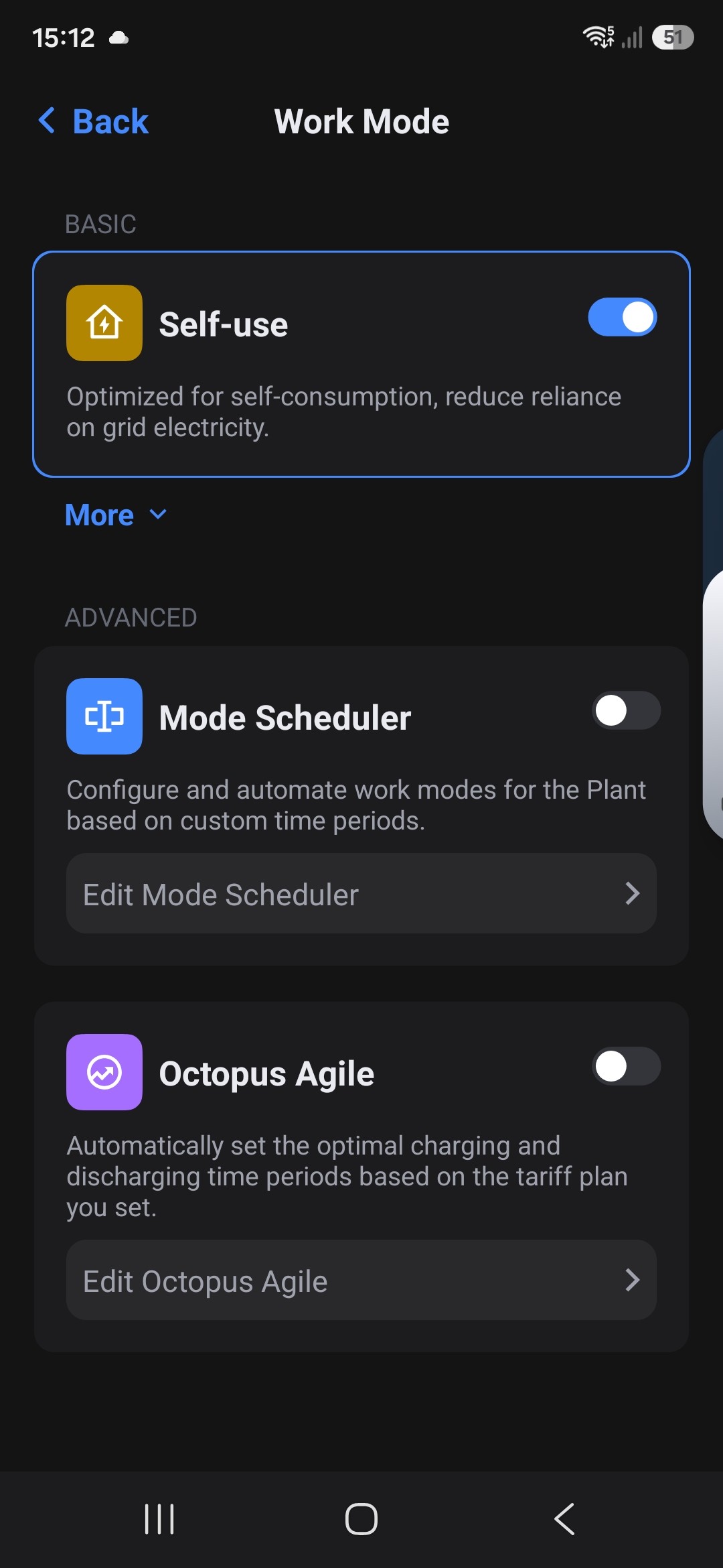

could someone please tell me if this is the correct way to have this work mode.
regards Dave
Re: picture
Cannot say I understand what you are asking with your post.
The picture shows you have selected 'Self-use' mode which is the default out of the box work mode.
It tries to charge the battery to 100% before it exports surplus energy to the grid.
A good work mode if you want to reduce your grid dependence as much as possible.
