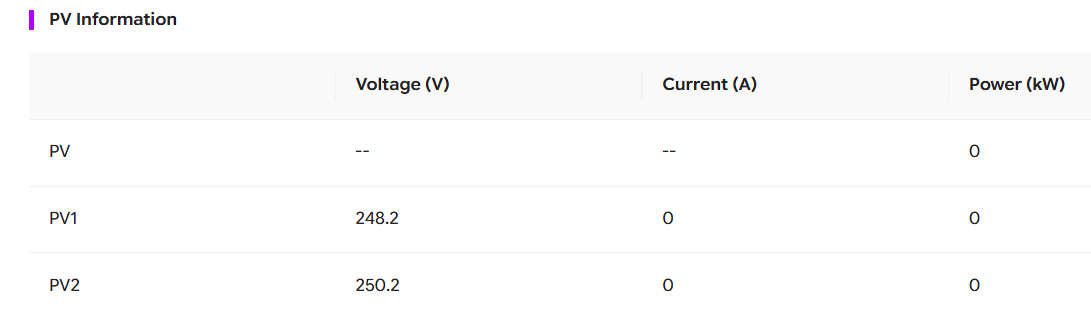

my system comprises 2 strings of 7 x 475W Aiko panels and a KH7 inverter, all new in April this year
I have noticed on many occasions that even with a "reasonable amount" of daylight the inverter is producing no solar
This morning for instance at 8am the it was bright cloudy with a light level of 13,000 lux, the inverter said the panels were at 205V but ther current (and power) was zero
A short while later the light level had increased to 17,000 lux and the panels were producing around 500W on each string
The panel cottage always seems to be around 220V and never really increase although their current and power does (presumably under mppt control of the inverter)
Does that sound right ?????
Surely the inverter should produce SOME output with a string voltage down to around 80V

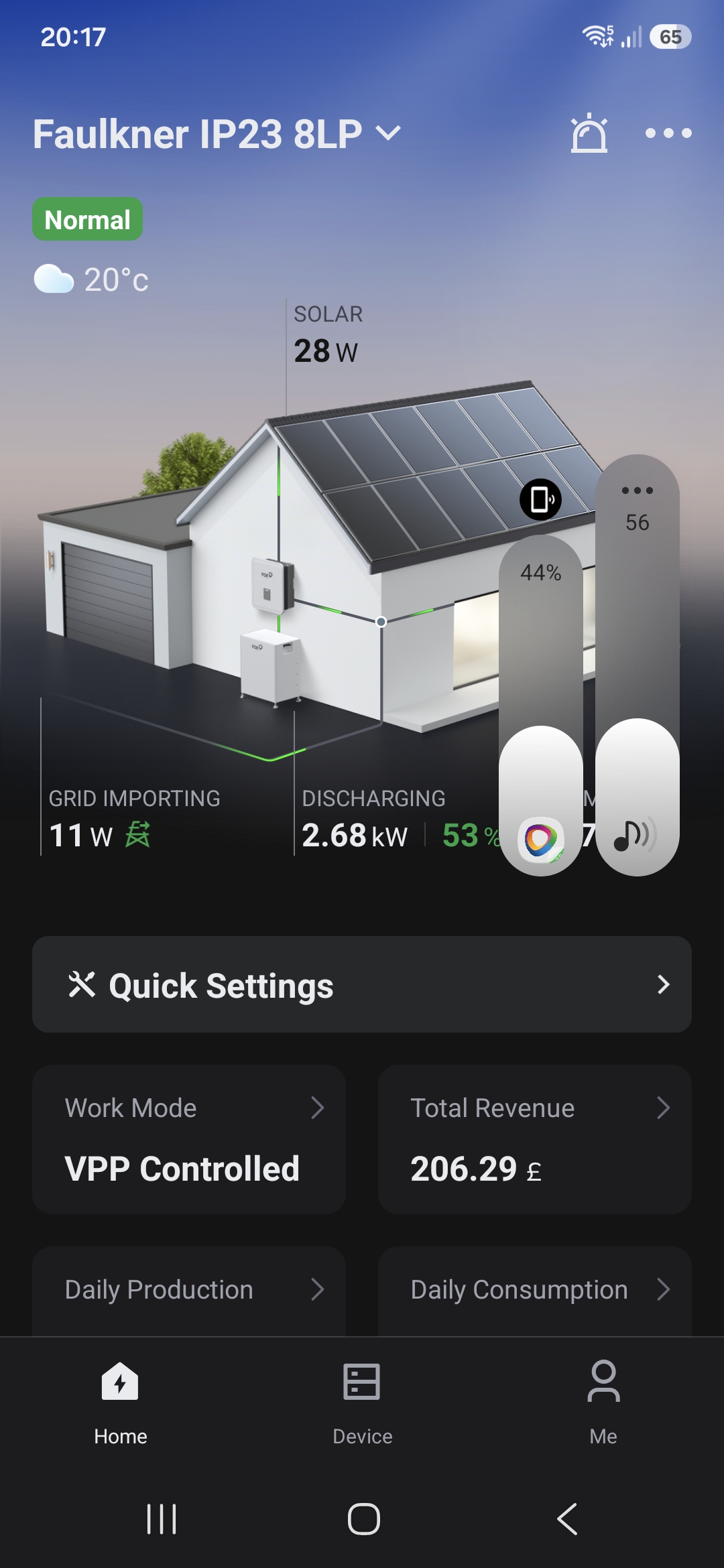

am seeing an mere 31w now
FOX KH7 7kw hybrid inverter
EN-EPS-BOX-SP gateway

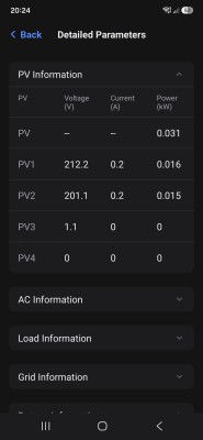

.....but this morning nothing at all then suddenly 1kw .....that can't be right.......but why are the panels still showing 200V now at sunset with no generation

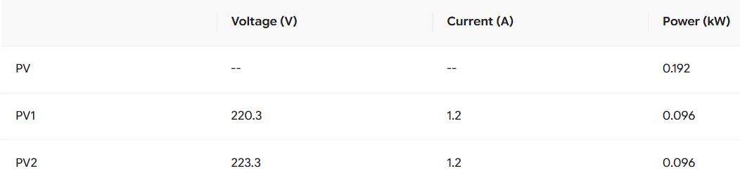

...and literally a few minutes later nothing despite the light level being 1700 lux which is still quite bright ![Image]()

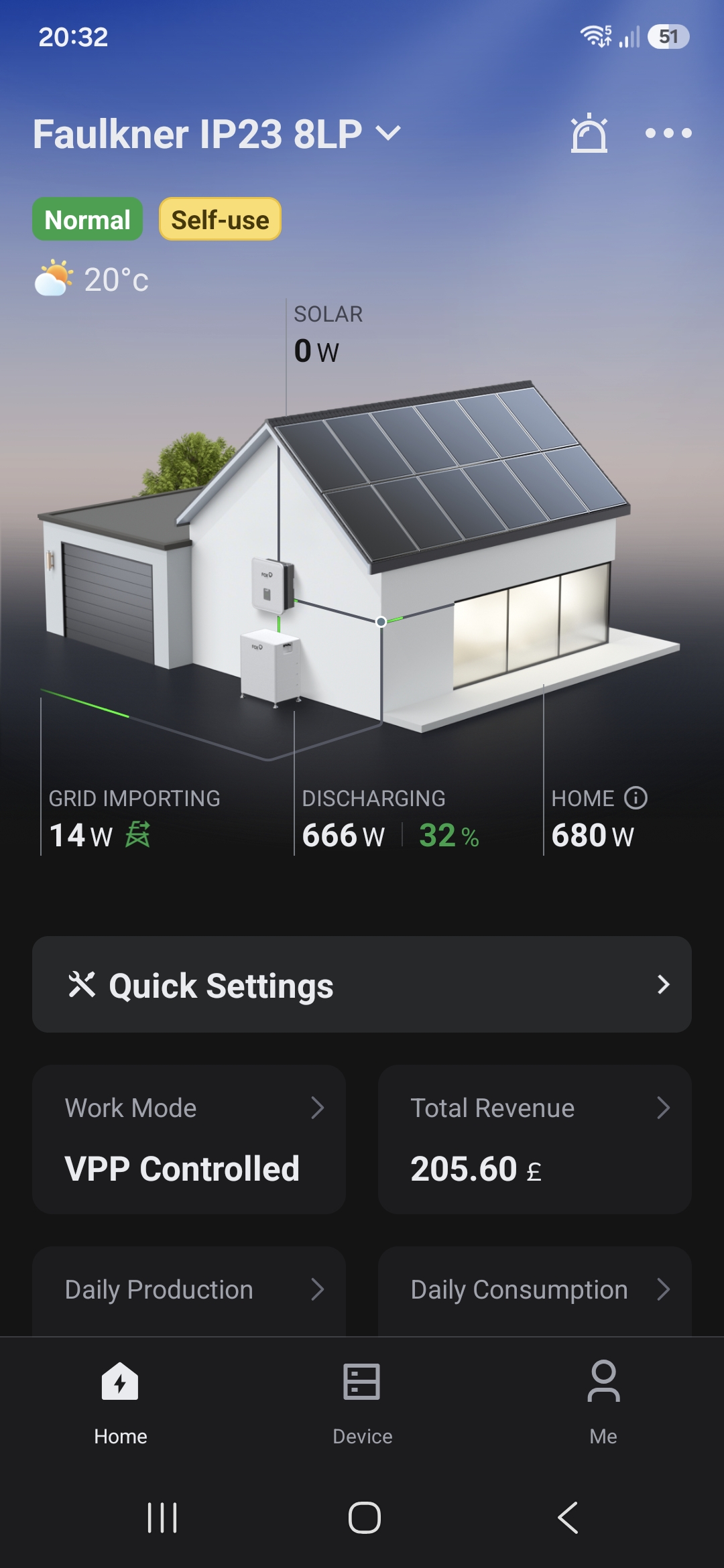

Earlier this evening.....
Now the battery is on high discharge to grid, the panels are showing a higher (presumably open cct) voltage with zero power

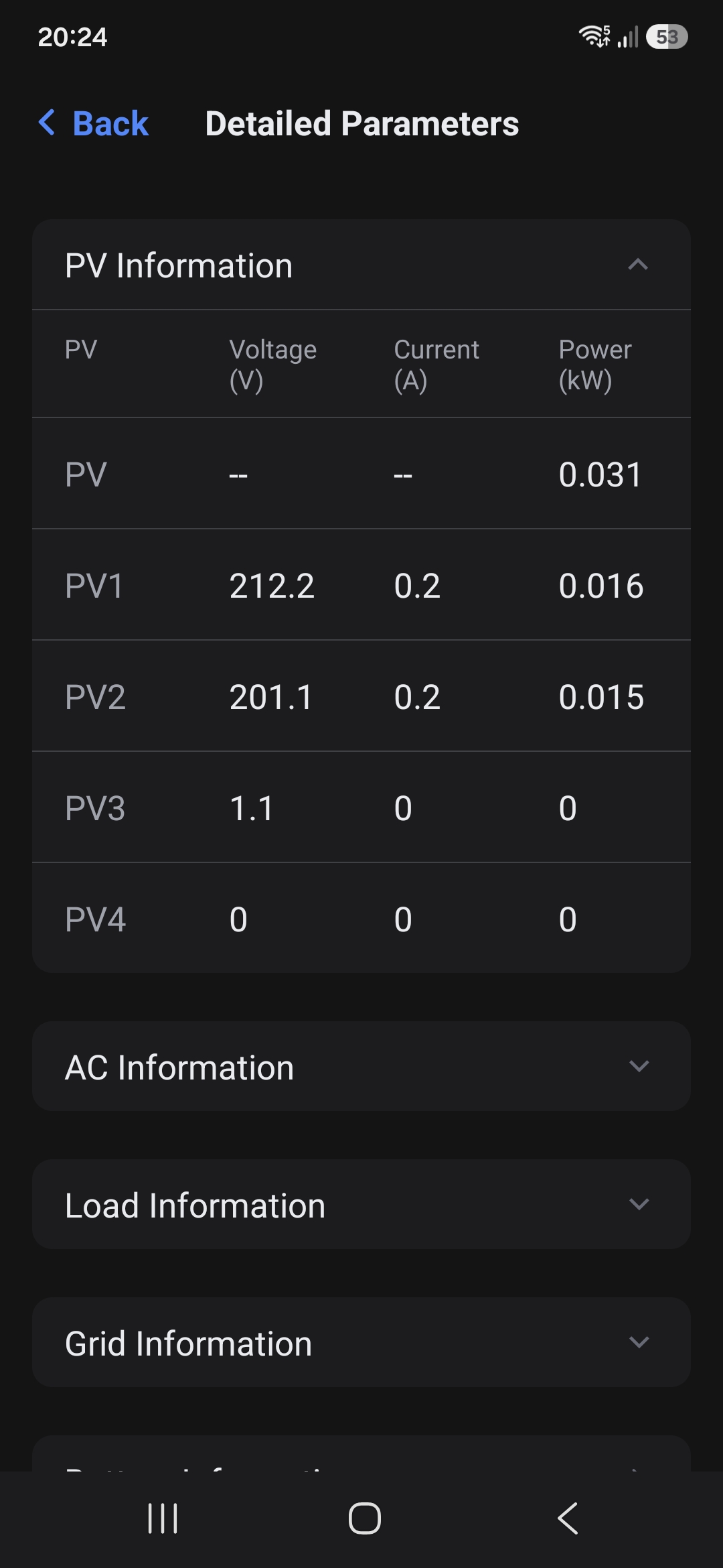

Hmmm....never seen this before....
...28W...

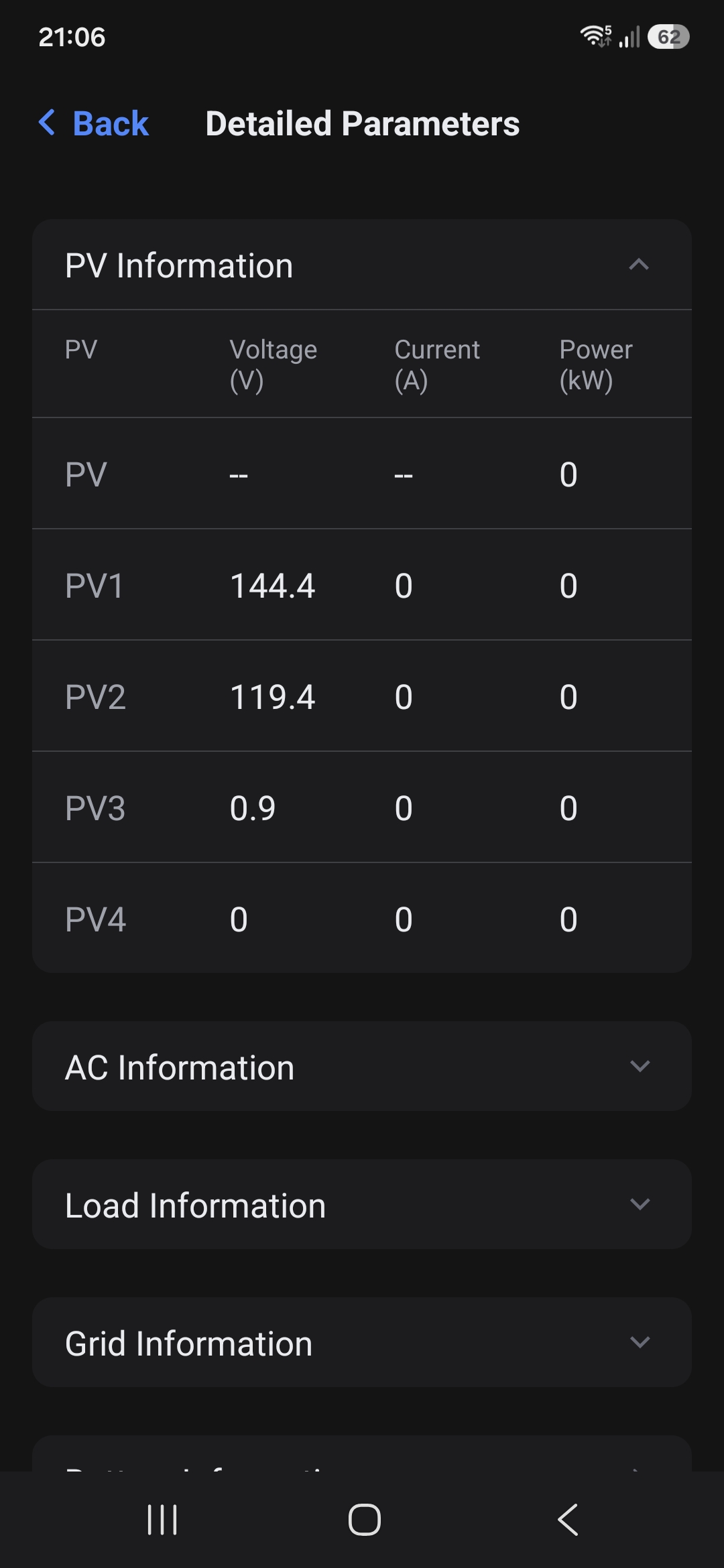

This is what i was mainly querying.....the panels are still showing well over 100V but not providing any power as it is now dusk .......but the inverter spec says it starts generating at 80V input .....
