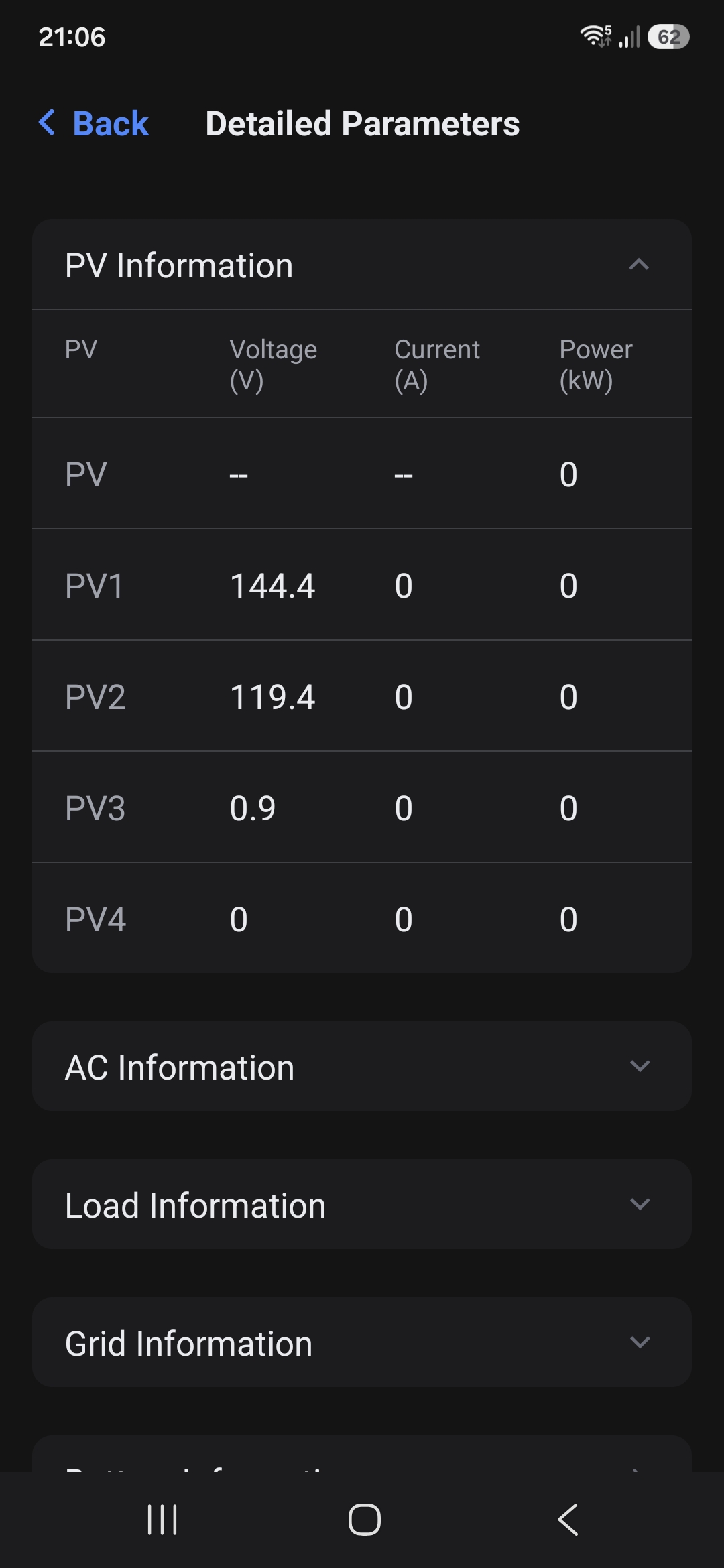

Re: light level vs inverter output
This is what i was mainly querying.....the panels are still showing well over 100V but not providing any power as it is now dusk .......but the inverter spec says it starts generating at 80V input .....
