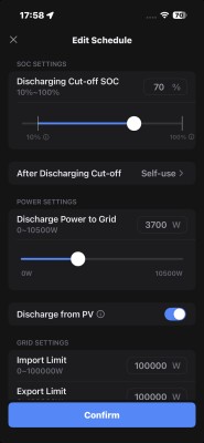

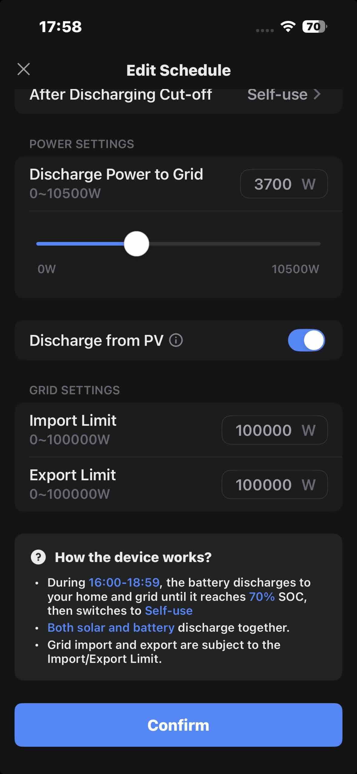

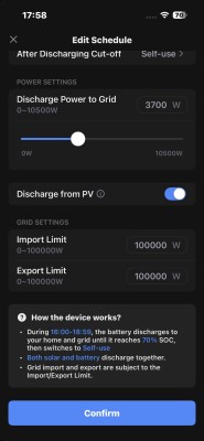

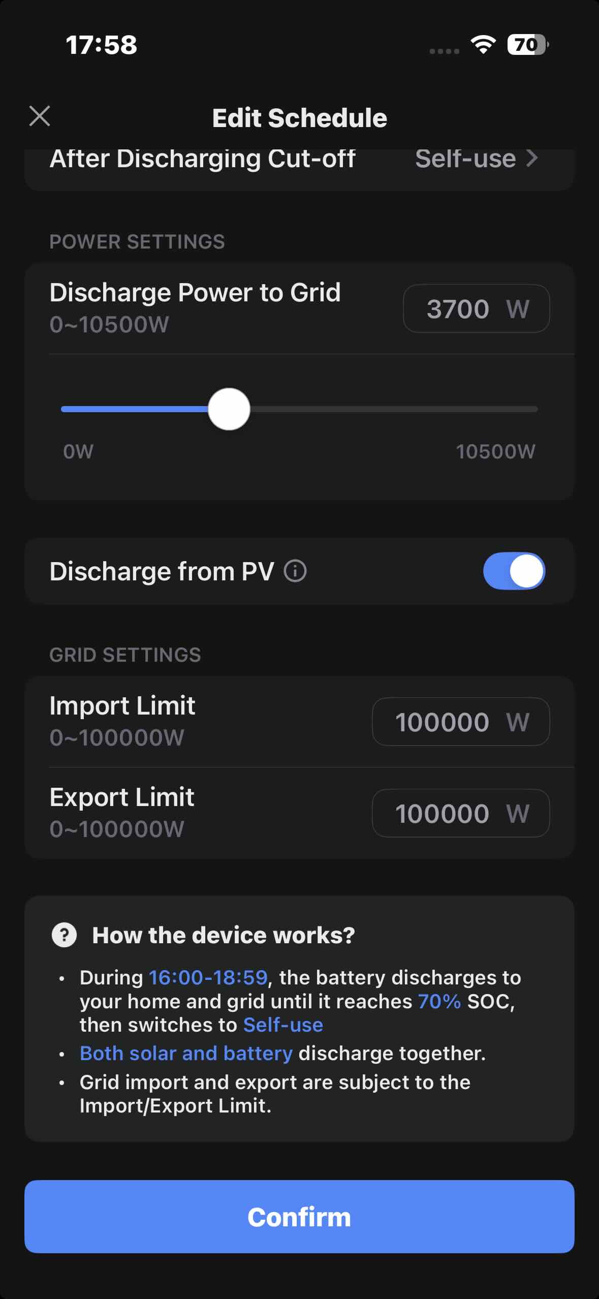

Dependant on your hardware/firmware versions this has been fixed with he latest version (2.2.18) of the app.
Manager(ARM):1.76
Master:1.57
BMS:1.012

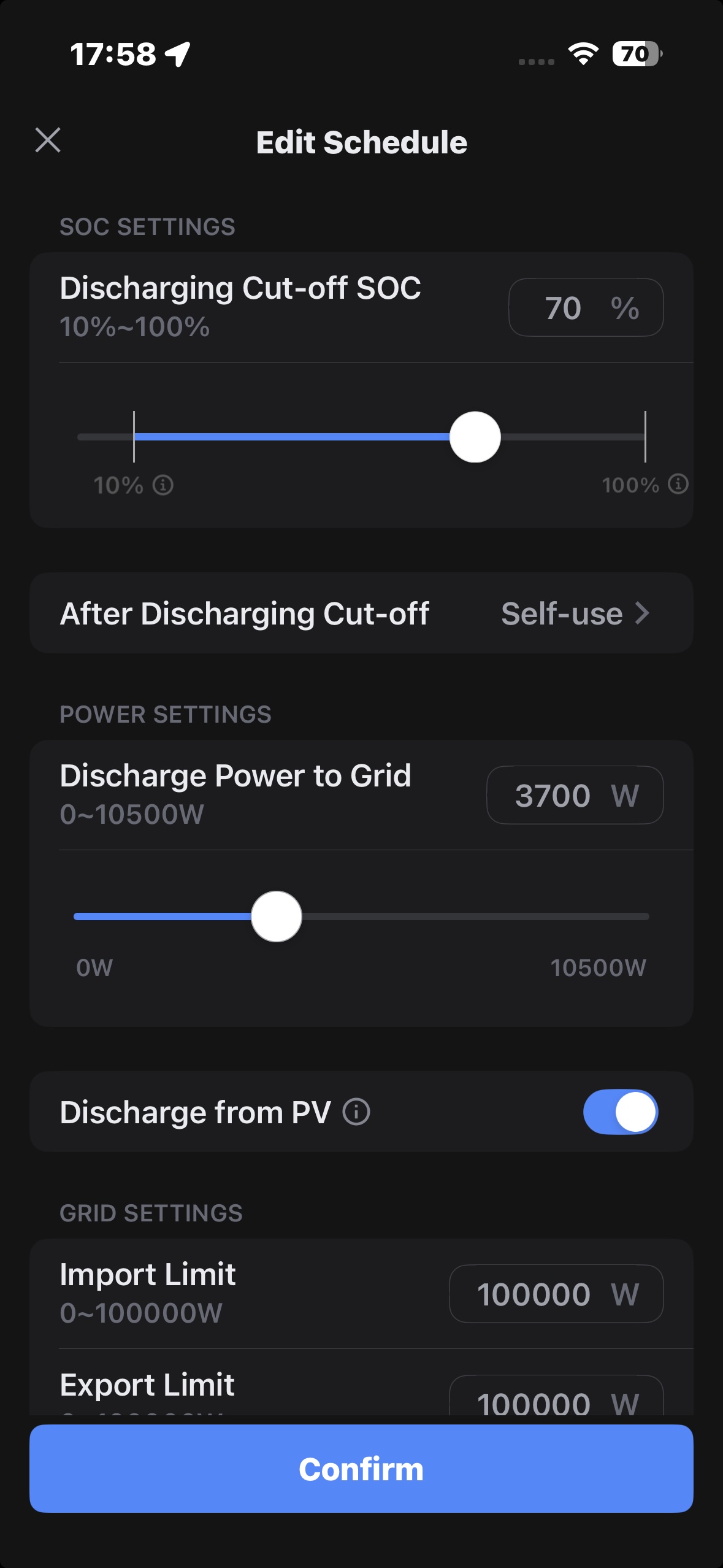

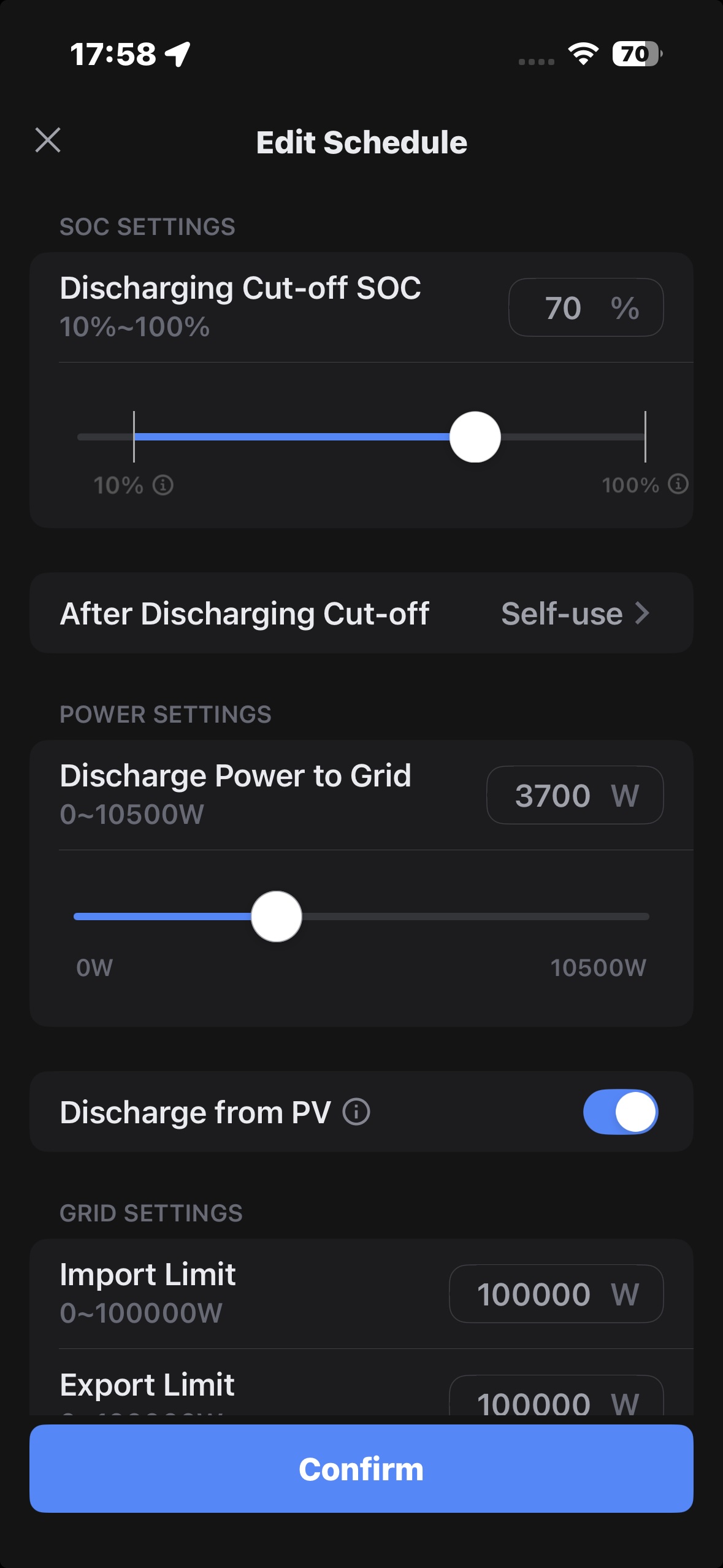

nrb501 wrote: Fri Jul 17, 2026 6:01 pm Dependant on your hardware/firmware versions this has been fixed with he latest version (2.2.18) of the app.
Perfect. I'll have to check for the update.
Edit: Just looked and in the app I'm missing the "After discharging cut-off" option.
Although at the bottom of a Schedule it states the following:
How the device works?
During 23:30 - 23:59, the battery discharges to your home and grid until it reaches 15% SOC, then switches to Self-use.
Both solar and battery discharge together.
Grid import and export are subject to the Import/Export Limit.
iOS app: v2.2.18
Inverter:
Master - 1.60
Slave - 1.02
Manager - 1.58
Battery:
Version_BMS - 1.012
Edit 2: Just doing an Export test to see if it cuts off at the correct SOC and reverts to Self-use.
Edit 3: Seems to have worked. Exported until hit set SOC and then reverted to Self-use. Just strange to have the missing option, but happy it works again.
