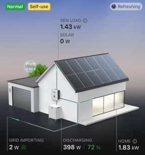

The Fox App is correctly showing the output from the GoodWe under Gen Load, but it is also adding to the Home Load
This show the Gen Load, the Load is the sum on Discharge (actual home load) and Gen Load:

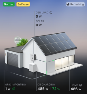

Turning the GoodWe Invertor off via ac isolation it shows:

Most likely the position of the main meter (or CT1 R/S/T), as this is 3 phase you will have a meter that reads each phase but if the single phase inverter is up-stream of those meters then the inverter won't be able to see the effect that it is having and it will assume the power is being consumed by the house load. The 2nd CT looks to be reading ok.
The single phase inverter should be connected so the Fox main meter can see the power it is producing (but it cannot tell how much is being consumed by the house on that phase), CT2 tells it how much power is being produced by the single phase inverter and the inverter does some maths to work out how much is load, how much is exporting etc..
