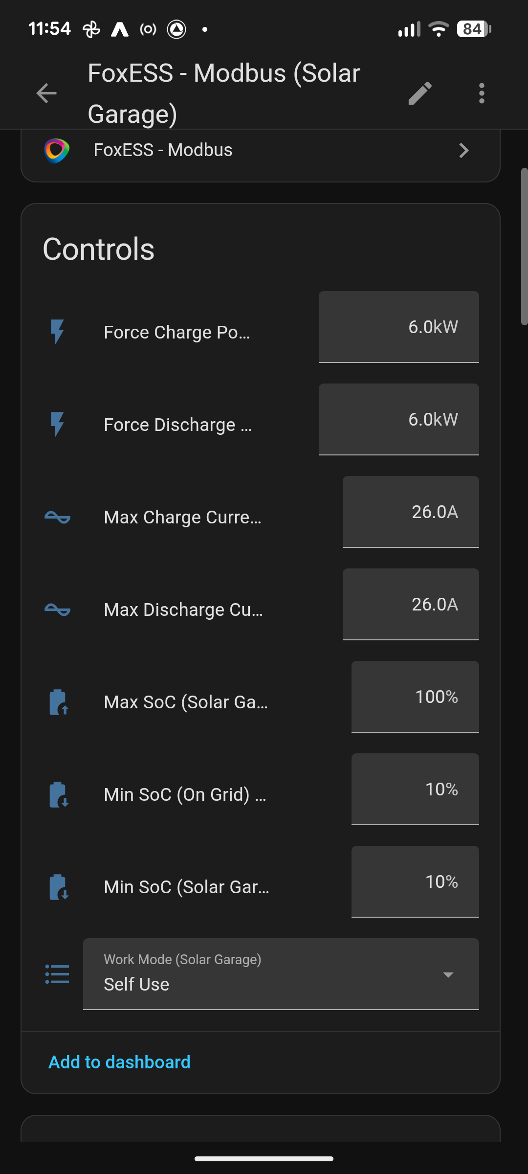

Can you look at your modbus information and see what Modbus Max Charge & Discharge rates are set to ?
3 * EQ4800's only have a nominal voltage of 134V, from memory the G2 has a 40A charge/discharge limit - so max power should be 5.3kW (at 25C) but that will reduce at lower SoC's and temperatures.

Hi, I've posted a screenshot of the rates which are set. Should the discharge current be higher?
Re: FoxEss H1 G2 6kW inviter with 3x EP4800 batteries, only at 3.6kW peak discharge
Yes, the recommended (continuous) charge/discharge current is 30A, but they have a maximum of 50A.
The H1 G2 has a maximum (default) of 40A.
If you are not looking to have long sustained high discharge periods (as some users do that dump their batteries to the grid), I would suggest going with the default setting of 40A for both charge and discharge.
