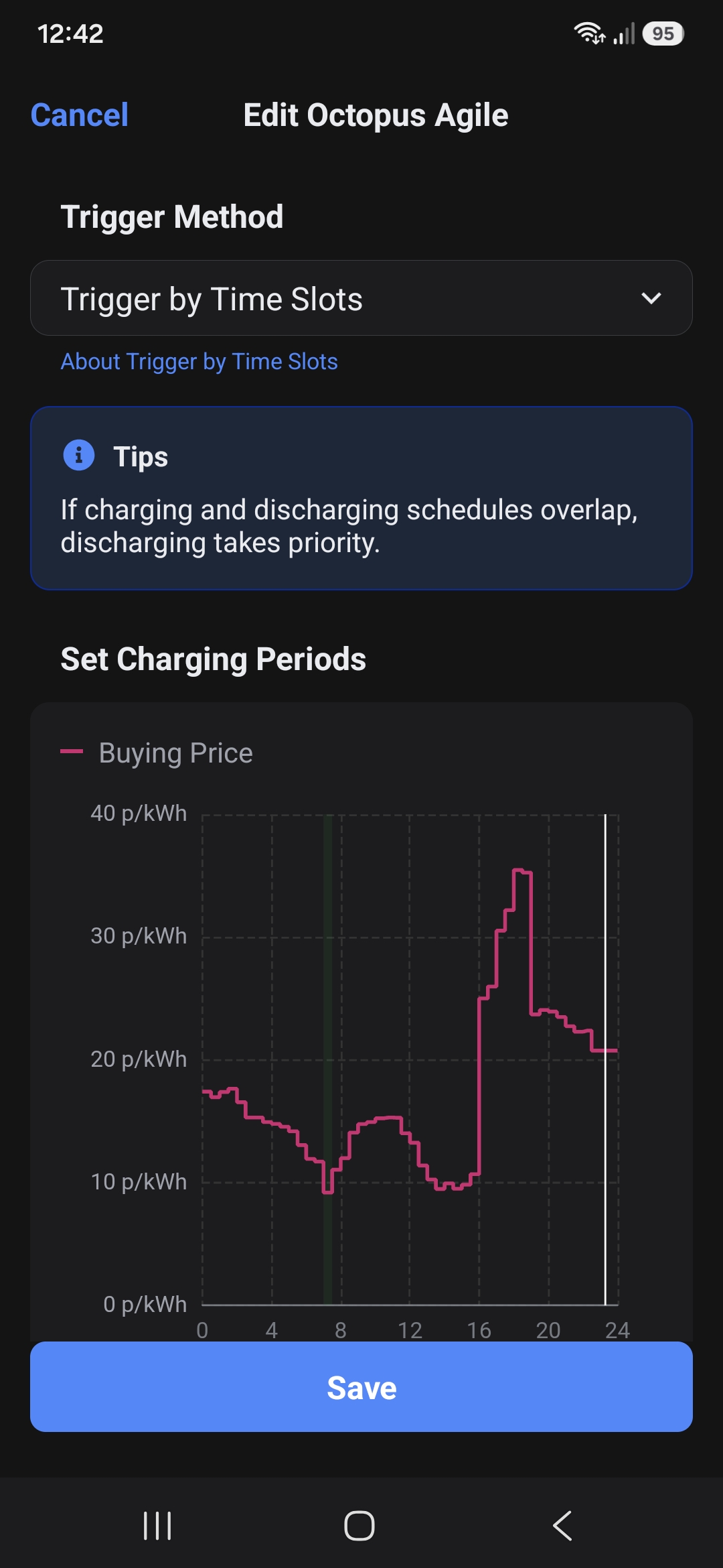

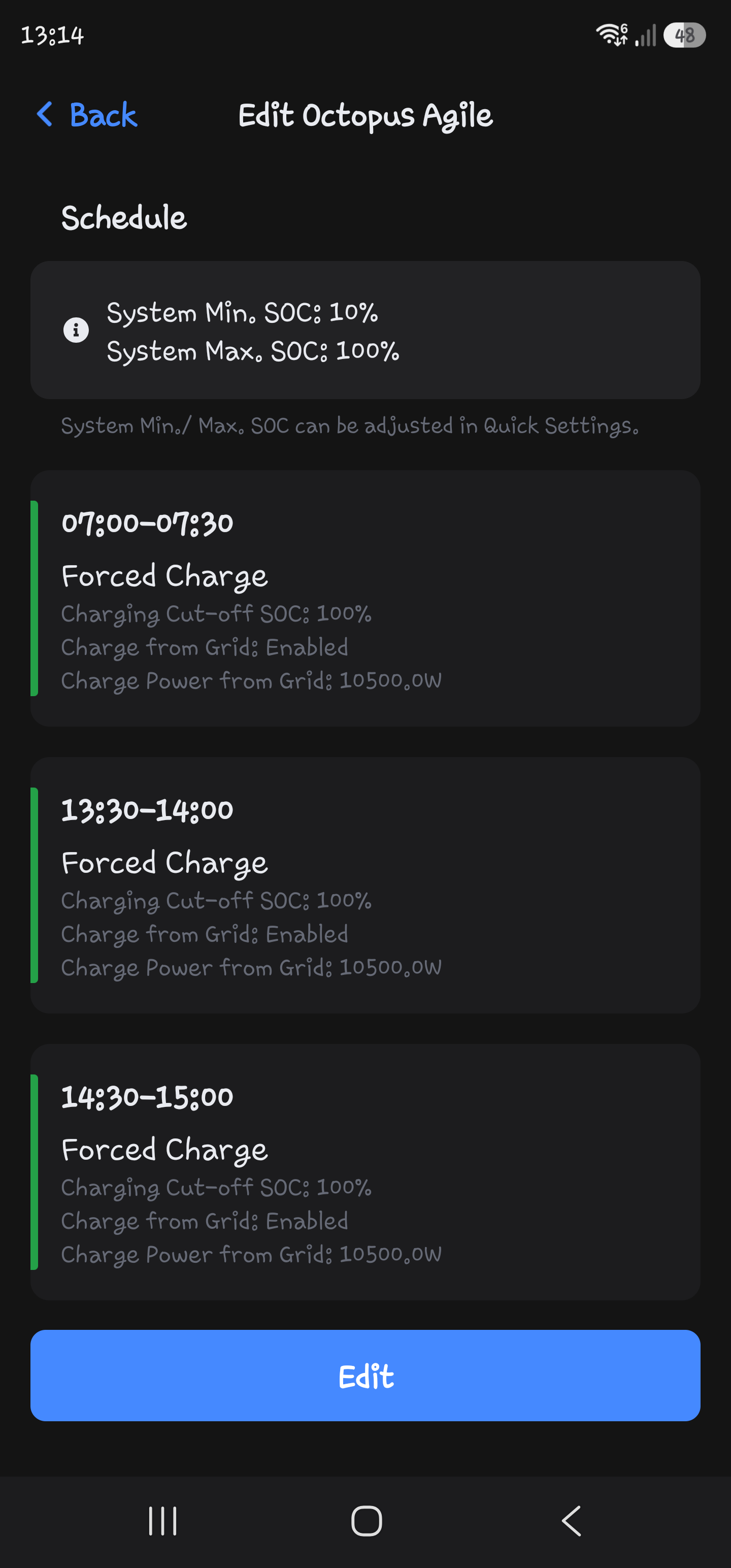

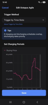

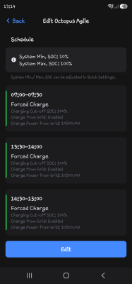

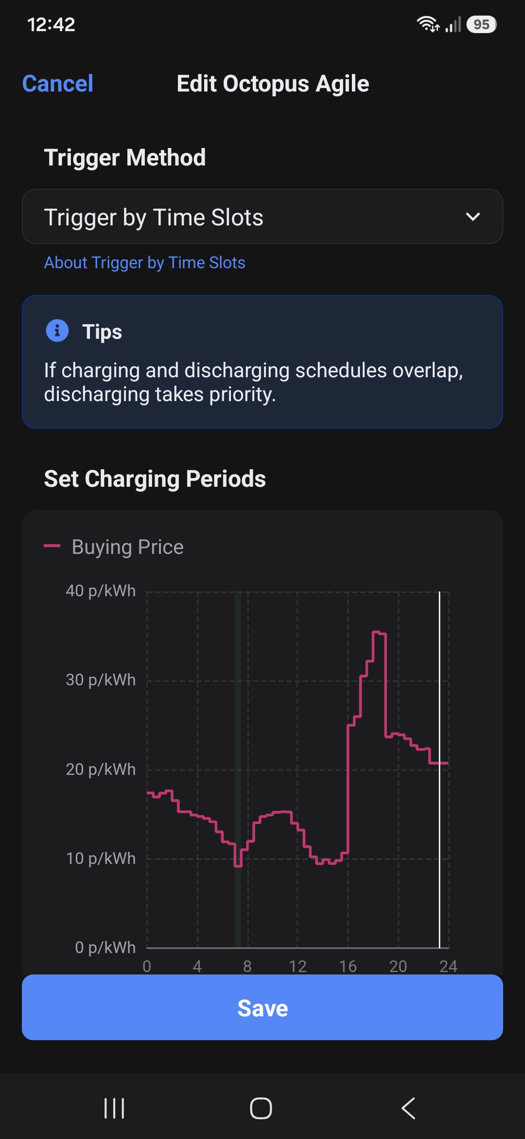

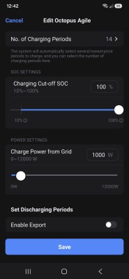

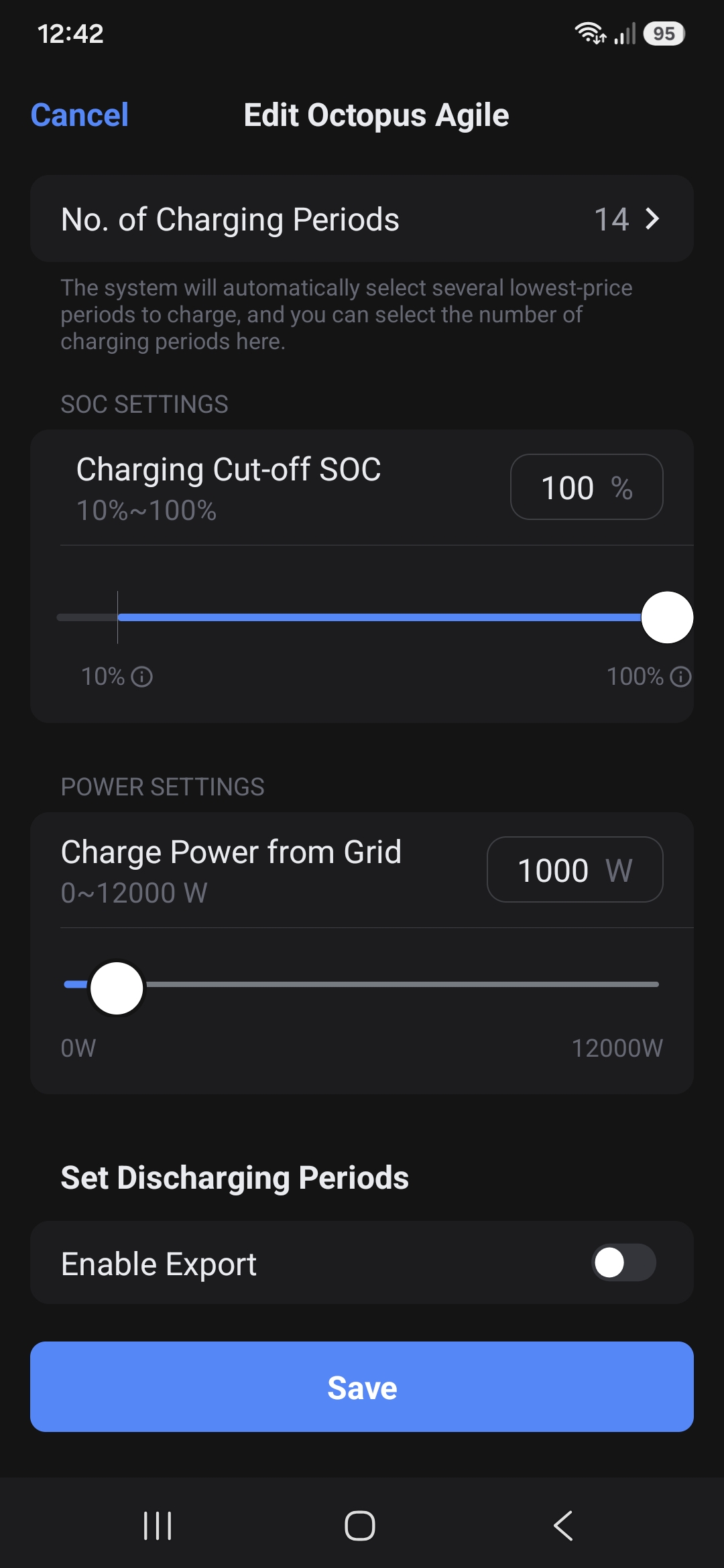

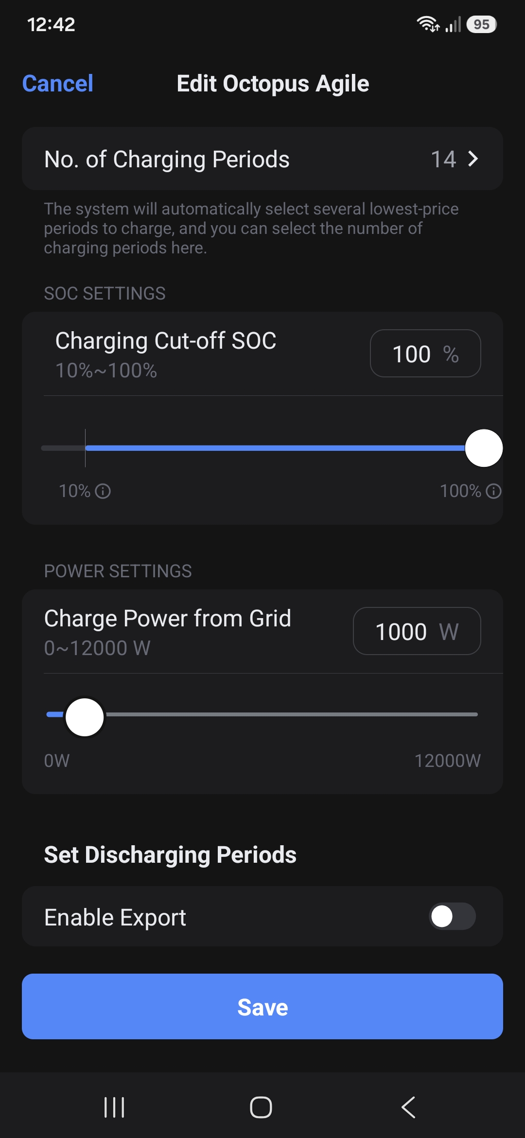

Can you post screenshot of your Agile mode settings, so it can be checked?
Re: Octopus Agile

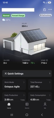

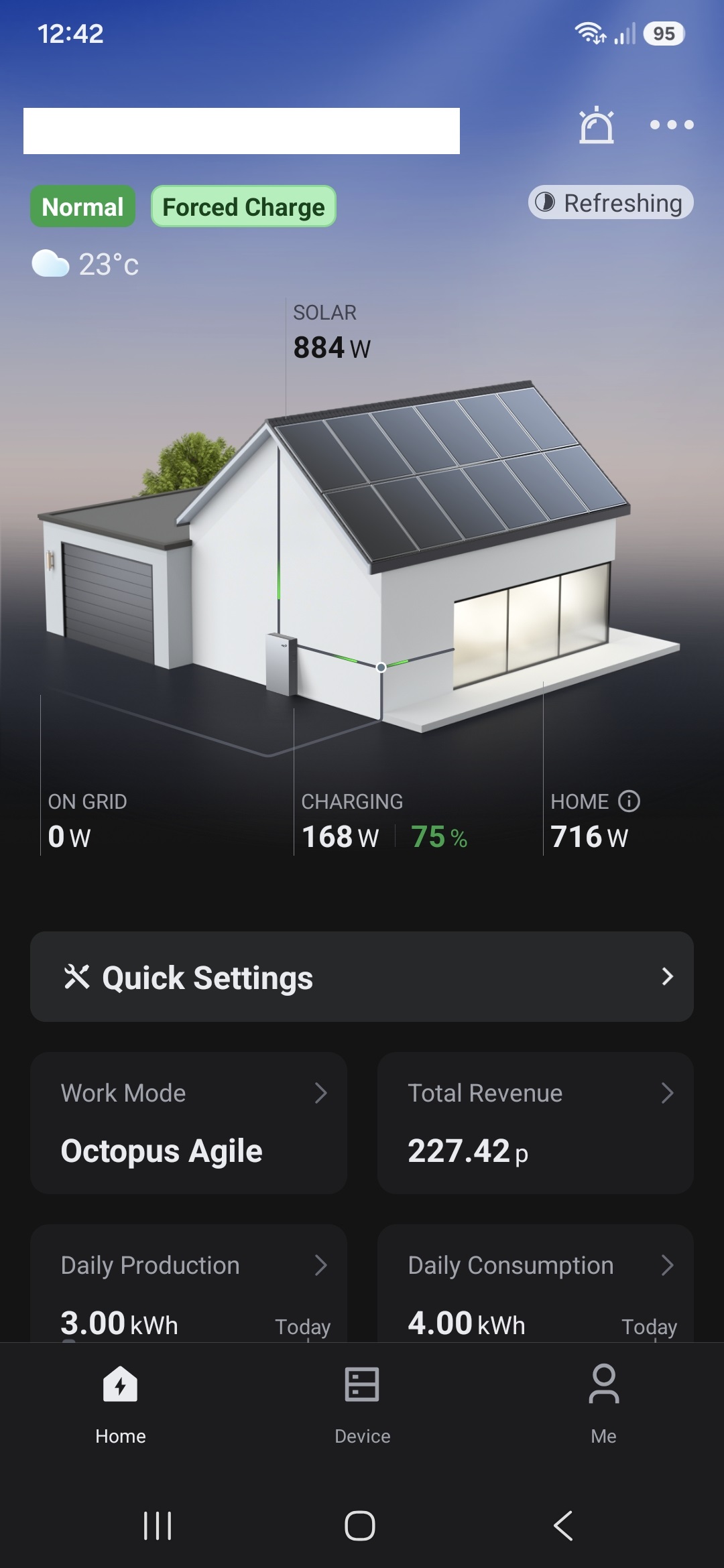

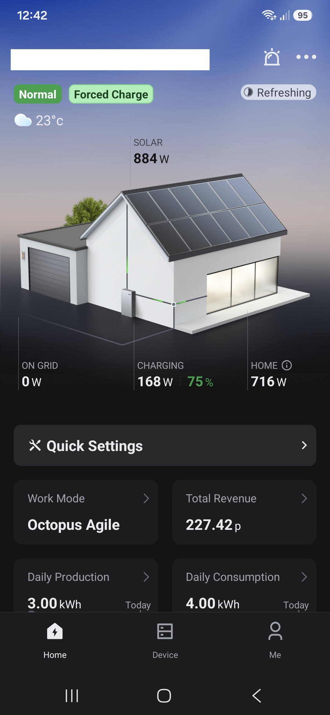

Screenshots attached. As you can see the current mode is "forced charge" so the schedule from Agile is working as it should but the inverter isn't pulling 1000w from the grid.
The inverter is working as it would in "self-use" mode not "forced charge" mode

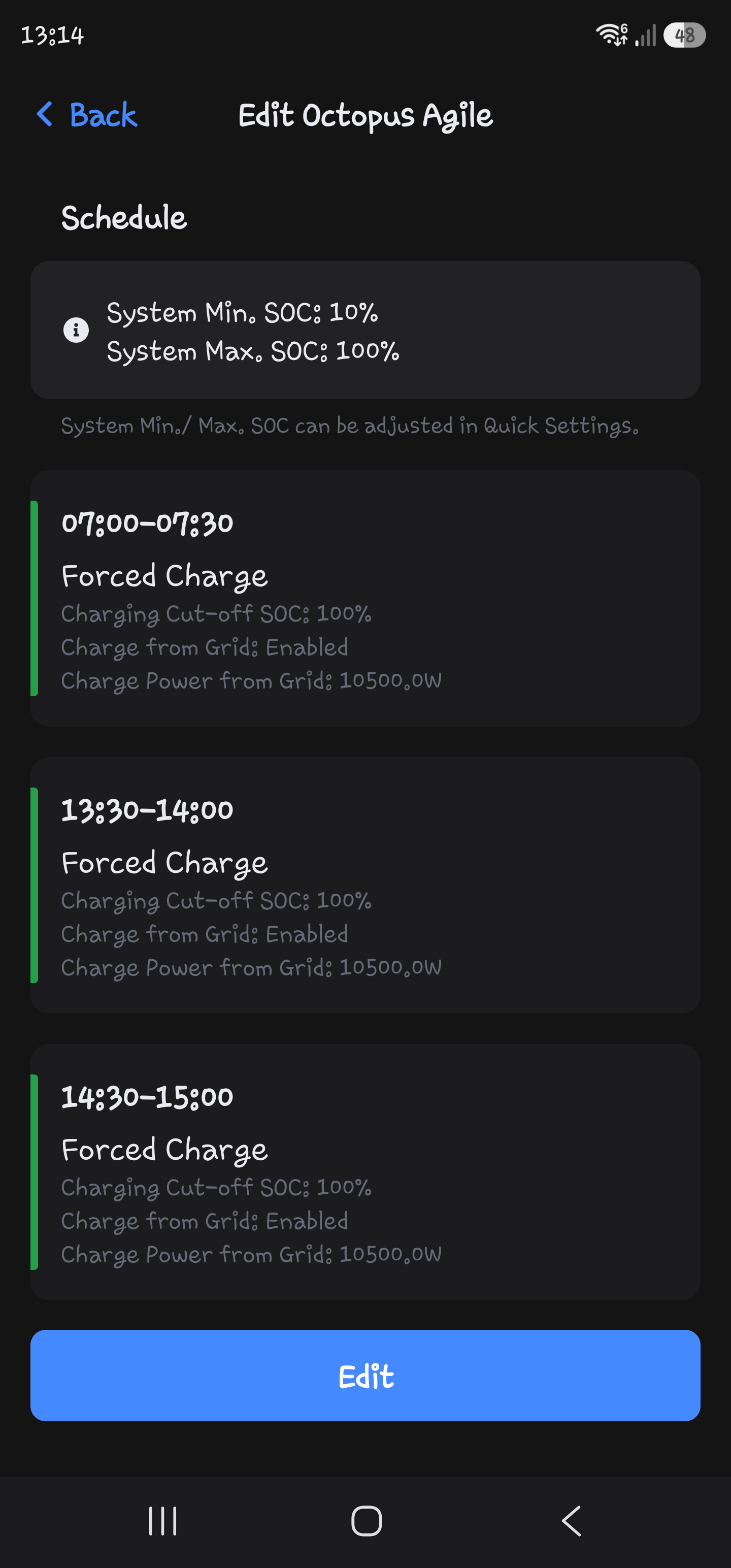

I asked for 3x slots, and I have it set as you to get the 3x cheapest slots for the day.
When I exit, and enter the Agile section again, I get 3x charge sessions populated.
Maybe your power rate is too low, and I am not sure you need 14x charging sessions.
If you don't see the charge slots listed after setting, you may have to delete your tariff and load it again perhaps?
Gogetta wrote: Sun Jul 05, 2026 12:54 pm Screenshots attached. As you can see the current mode is "forced charge" so the schedule from Agile is working as it should but the inverter isn't pulling 1000w from the grid.
The Inverter firmware could be interpreting this as not to pull 1000W from the grid, but operate the Inverter in "make 1000W of power in total"

I set 14 slots to try and get it to charge at the current time. I've tried many different W amounts. Everything from 10W up to 13000W.
