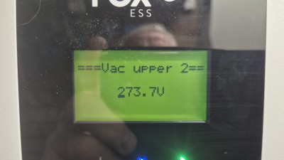

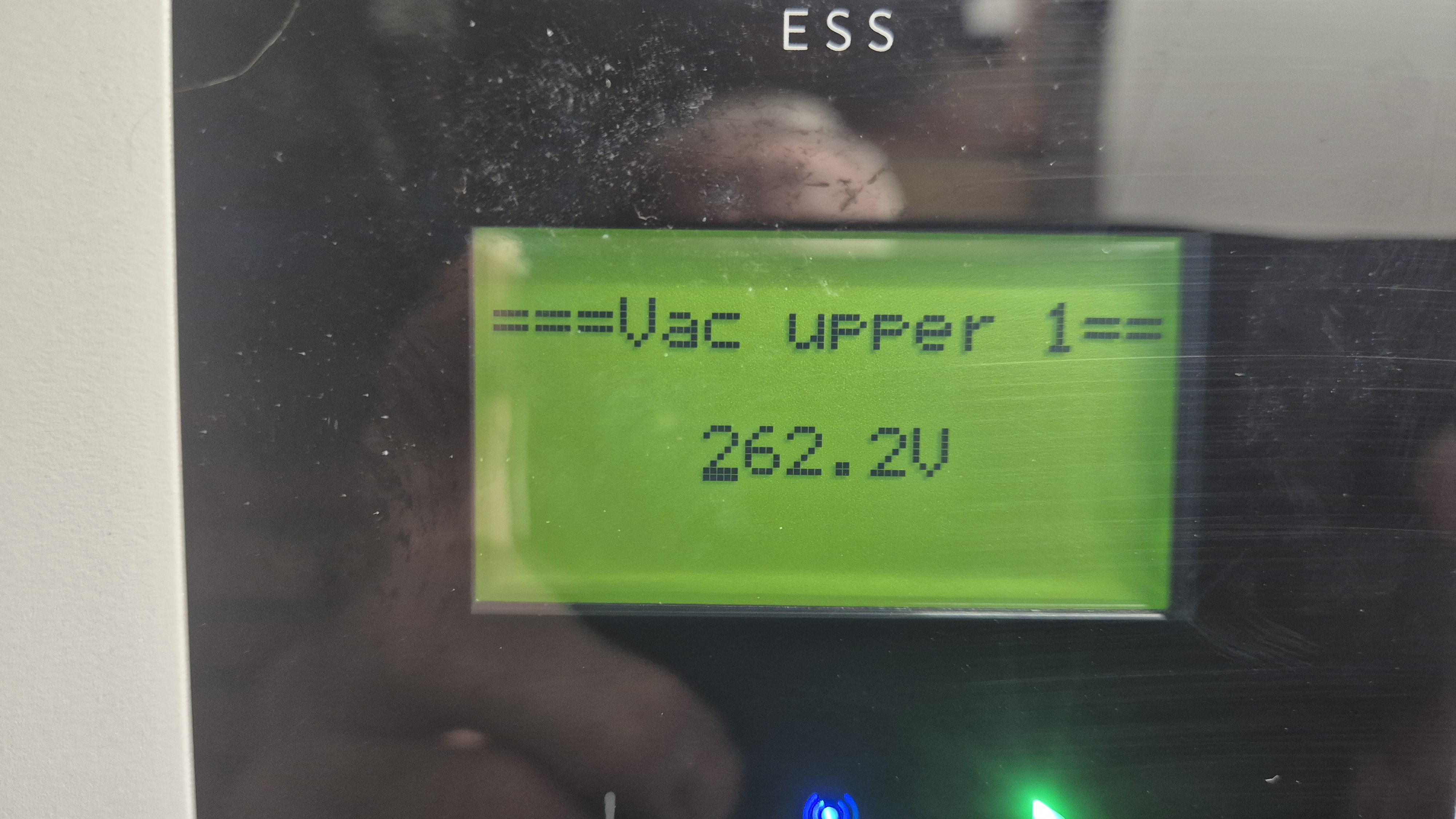

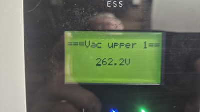

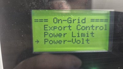

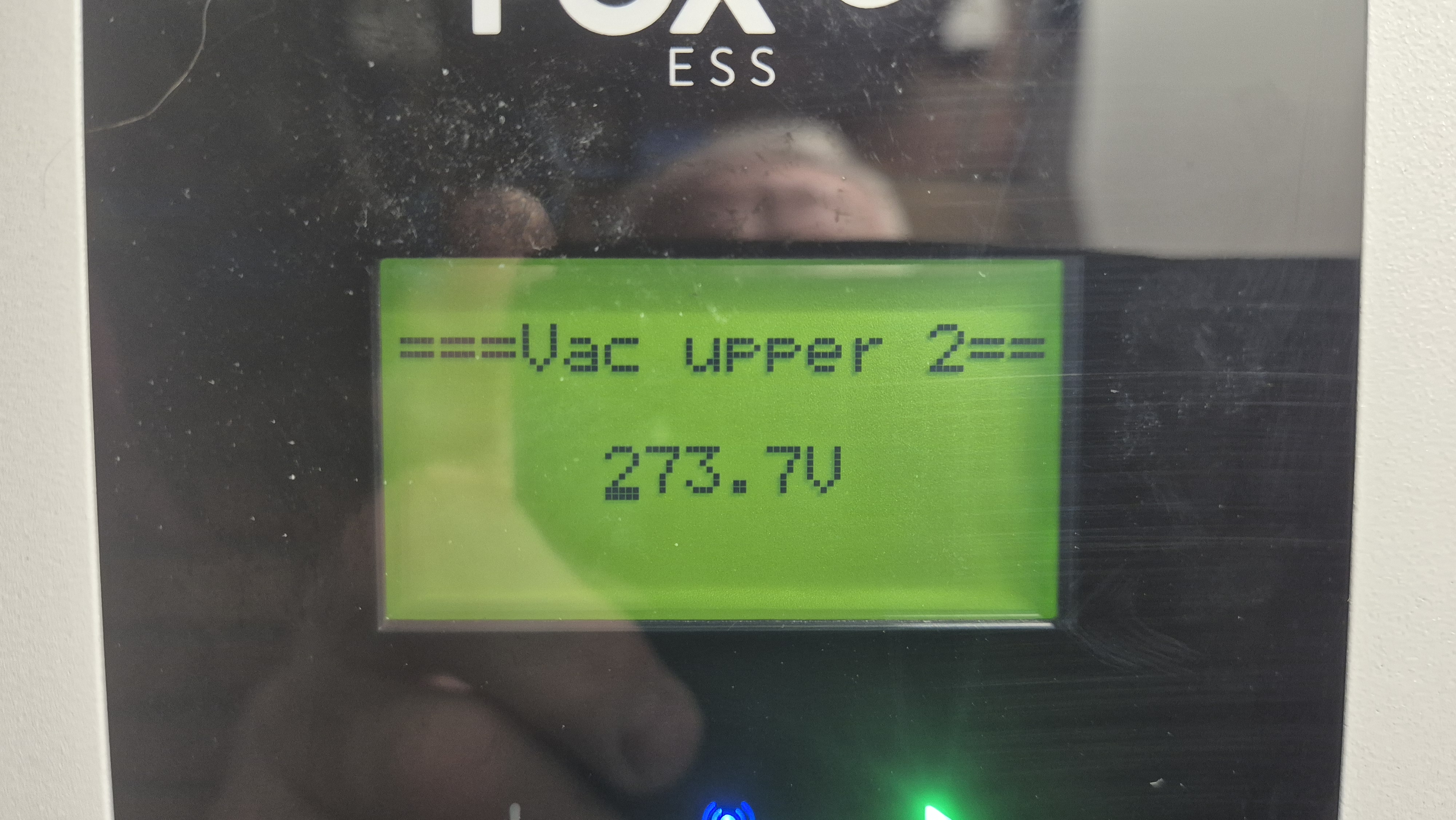

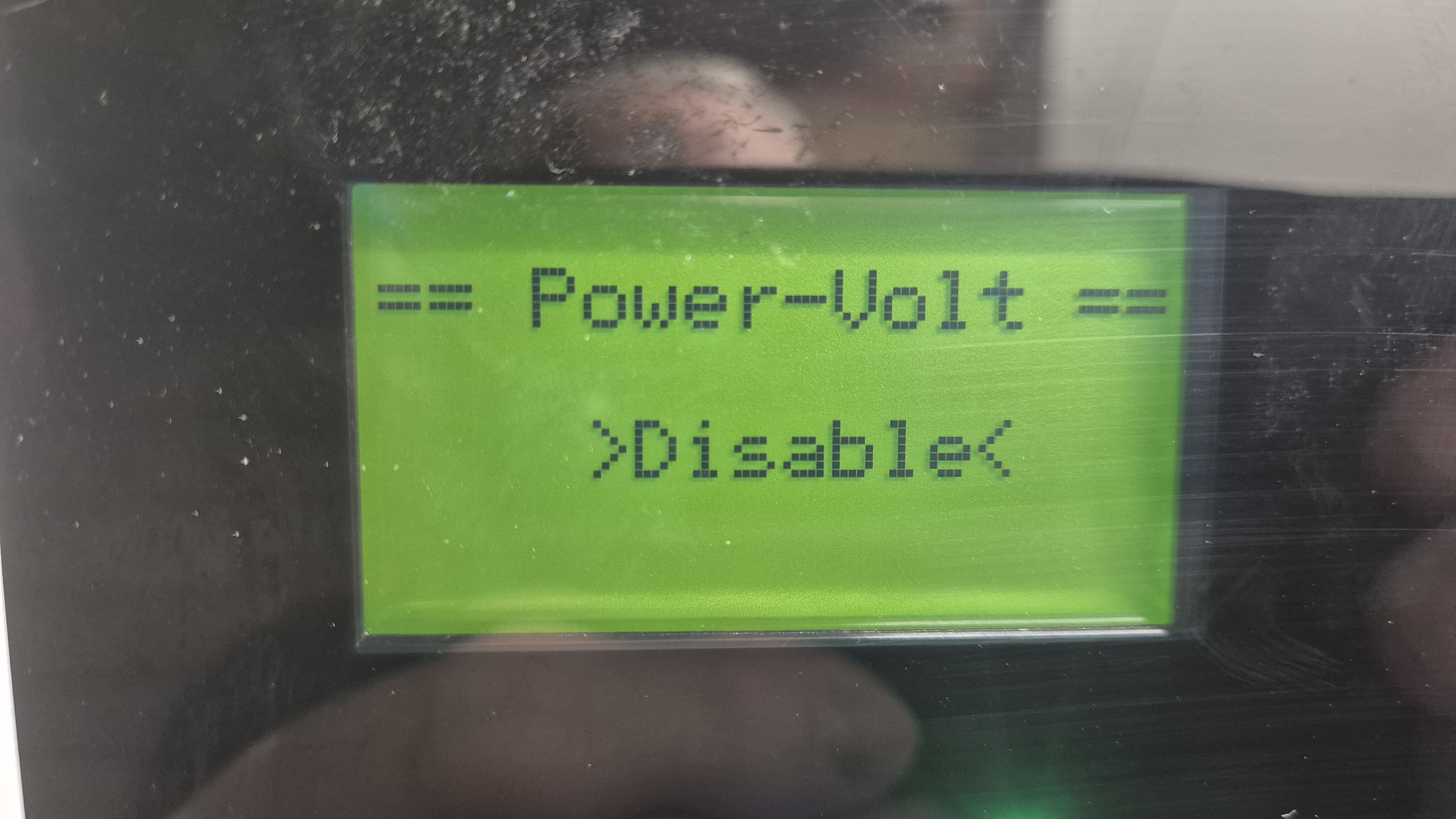

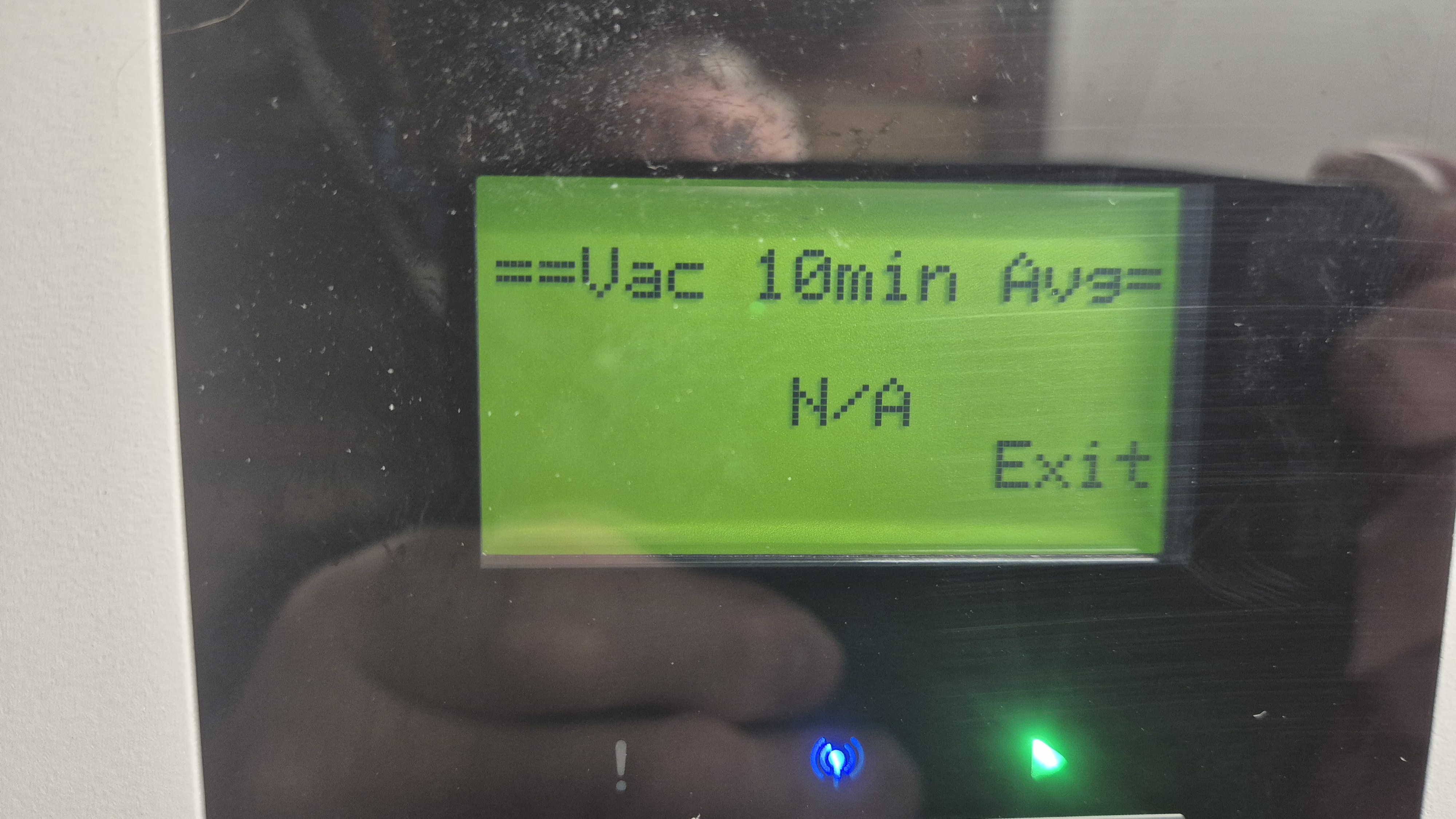

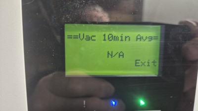

Having similar issues with out K7 inverter....the grid voltage does occasionally rise to around 257V but only for a few minutes....but thats enough to trip the K7 out where it remains until i either clear the fault log or reset the error
I found the Vac 10 min avg setting but it is set to disabled and I cant enable it

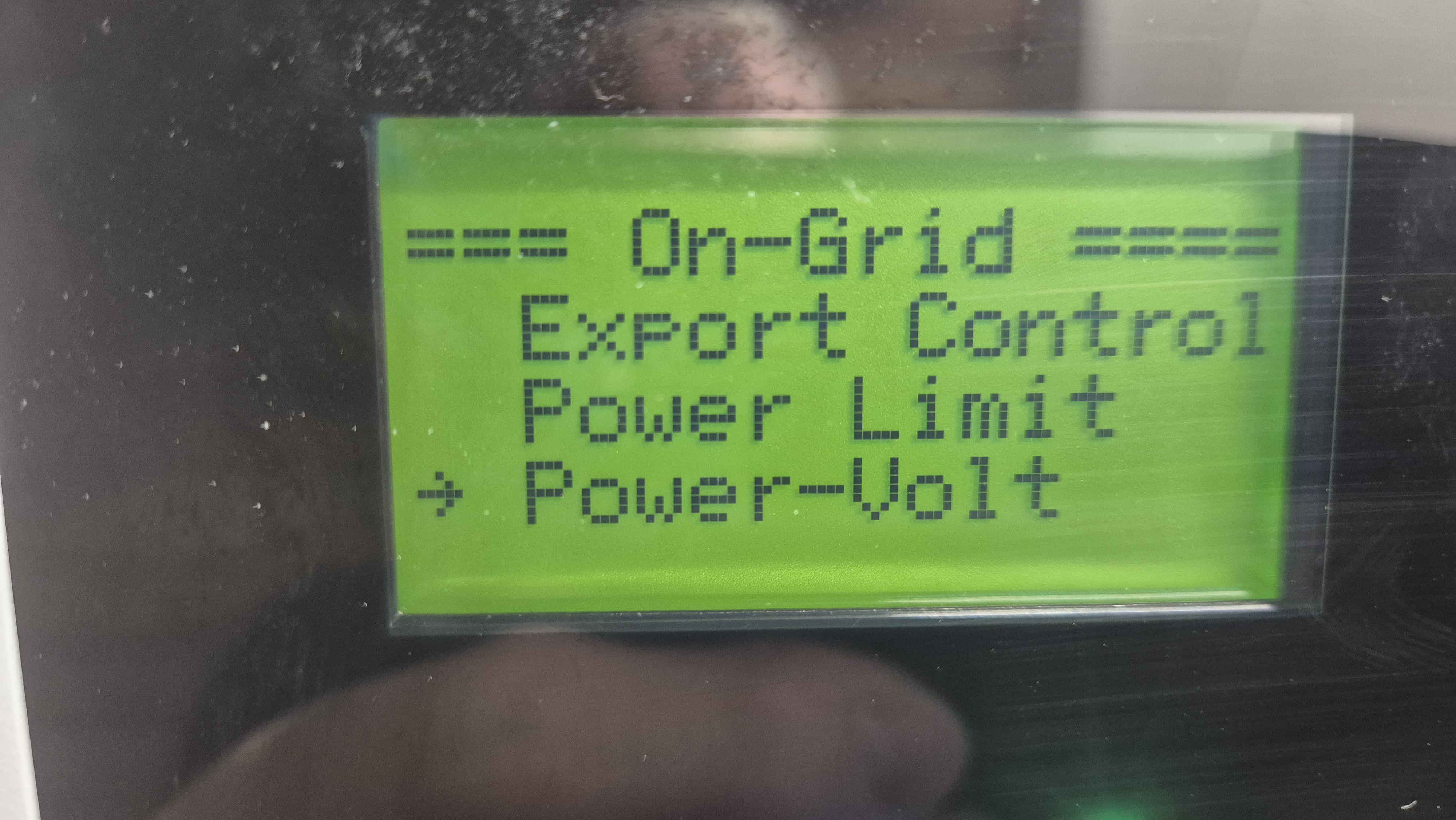

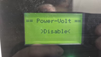

The other settings are as attached....whet exactly do they refer to ? attachment]

anyone......I cant access the 10 minute setting and it is set to N/A
