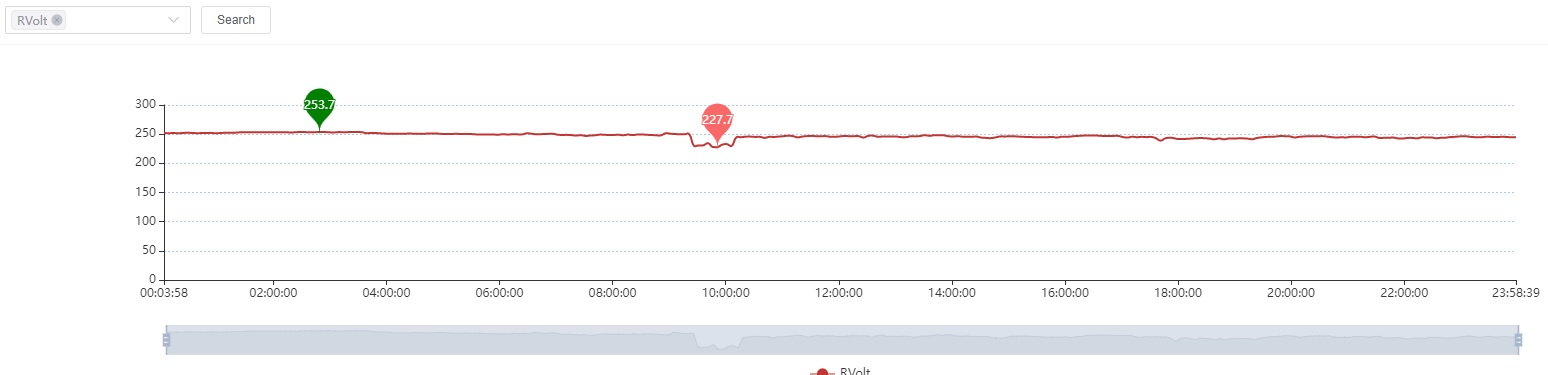

Looking at the data on the FoxESScloud website - It seems to correlate with the 'RVolt' going above 250v (max is about 252v).
Am I right in assuming that this is the grid voltage going too high, the Inverter not being happy and there is nothing we can do about it? Or - Is there something that can be done - by adjusting an Inverter setting to allow above 250v?

I have been getting multiple of these every day, and not just during daylight. The inverter was reporting RVolt at around 254V for almost an hour at 1.30am two nights ago. I have a H1 5.0 inverter.
I contacted my DNO, and they asked me to confirm the voltage with my installer. The graph from foxess shows the voltage fairly consistent at 250V or above. My only other data point is that I have a UPS in my office that shows the grid voltage. It normally shows only 216V when there's no solar generation and jumps to 250V when there is. Is there a configuration setting which can make the inverter misread the level?
The installer is bringing the batteries in a couple of weeks, but is like to know more before then

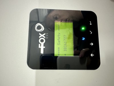

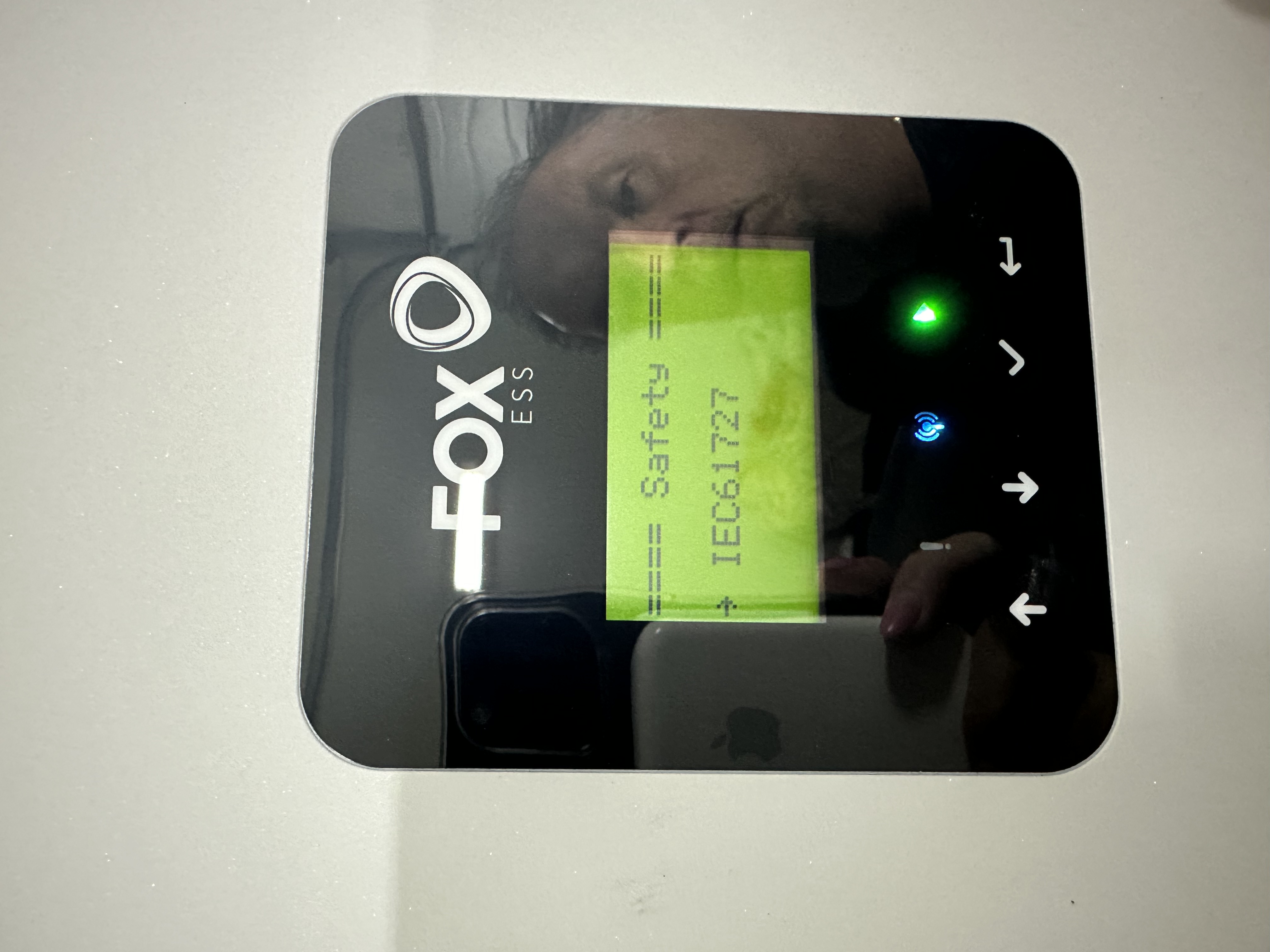

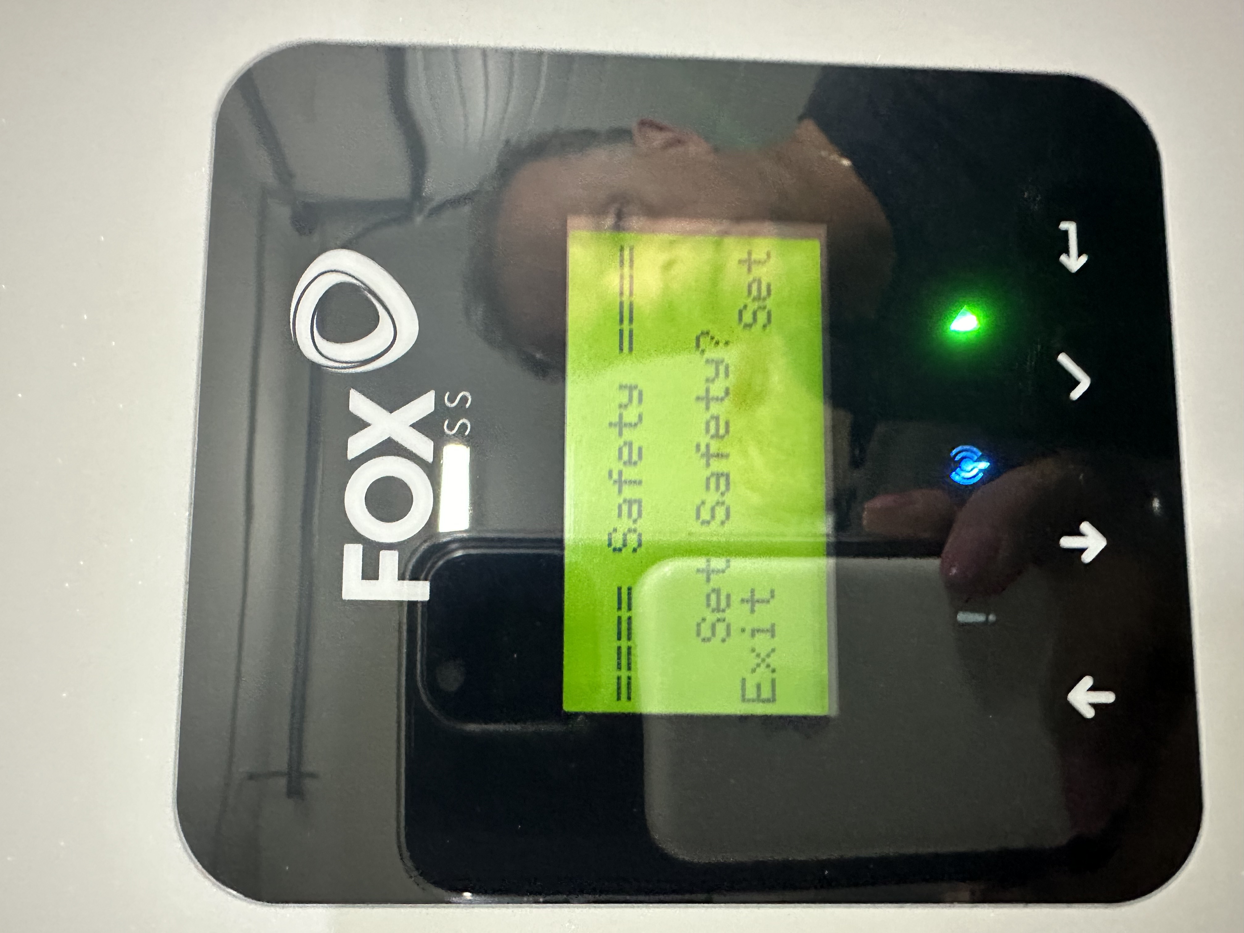

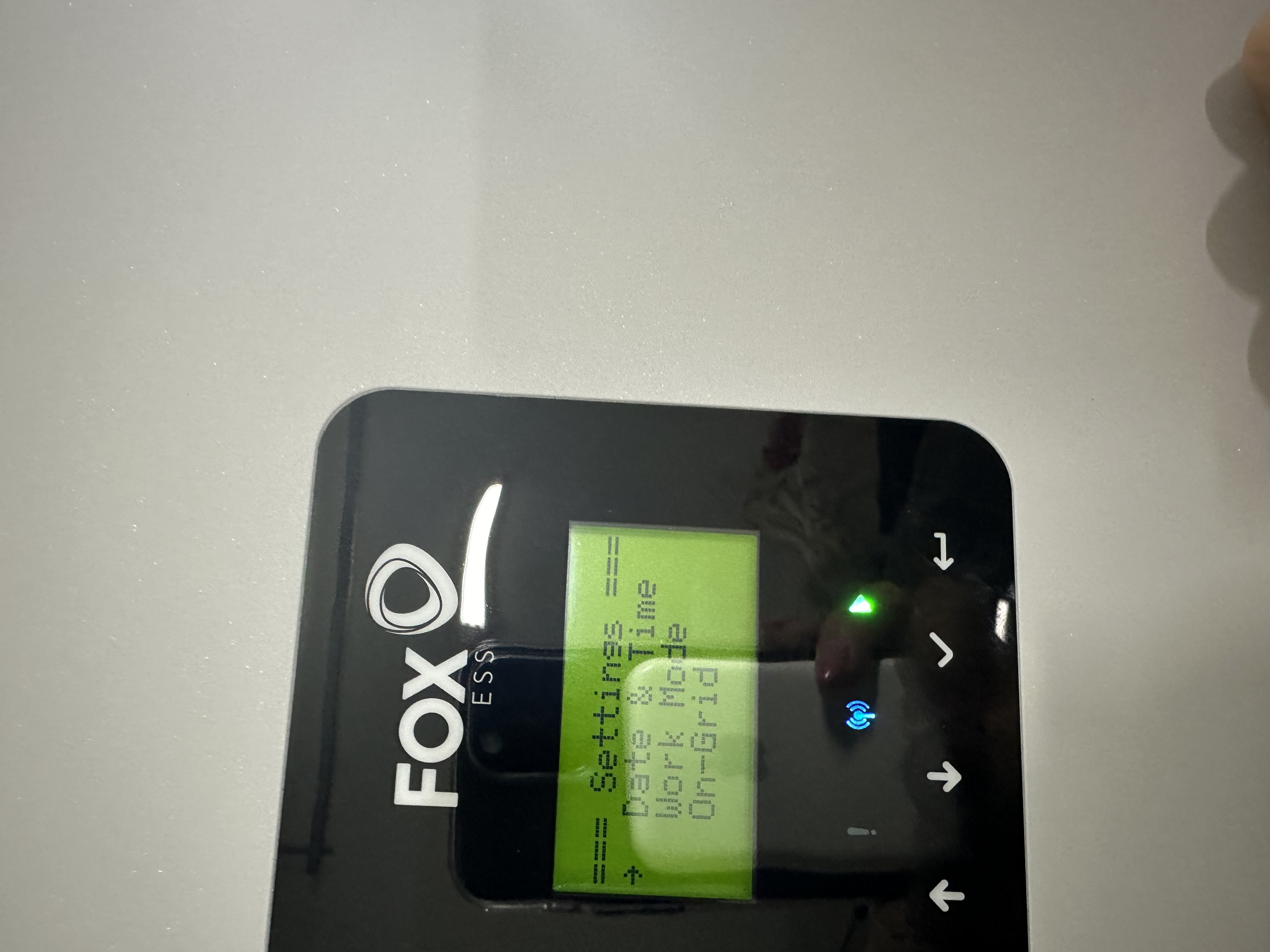

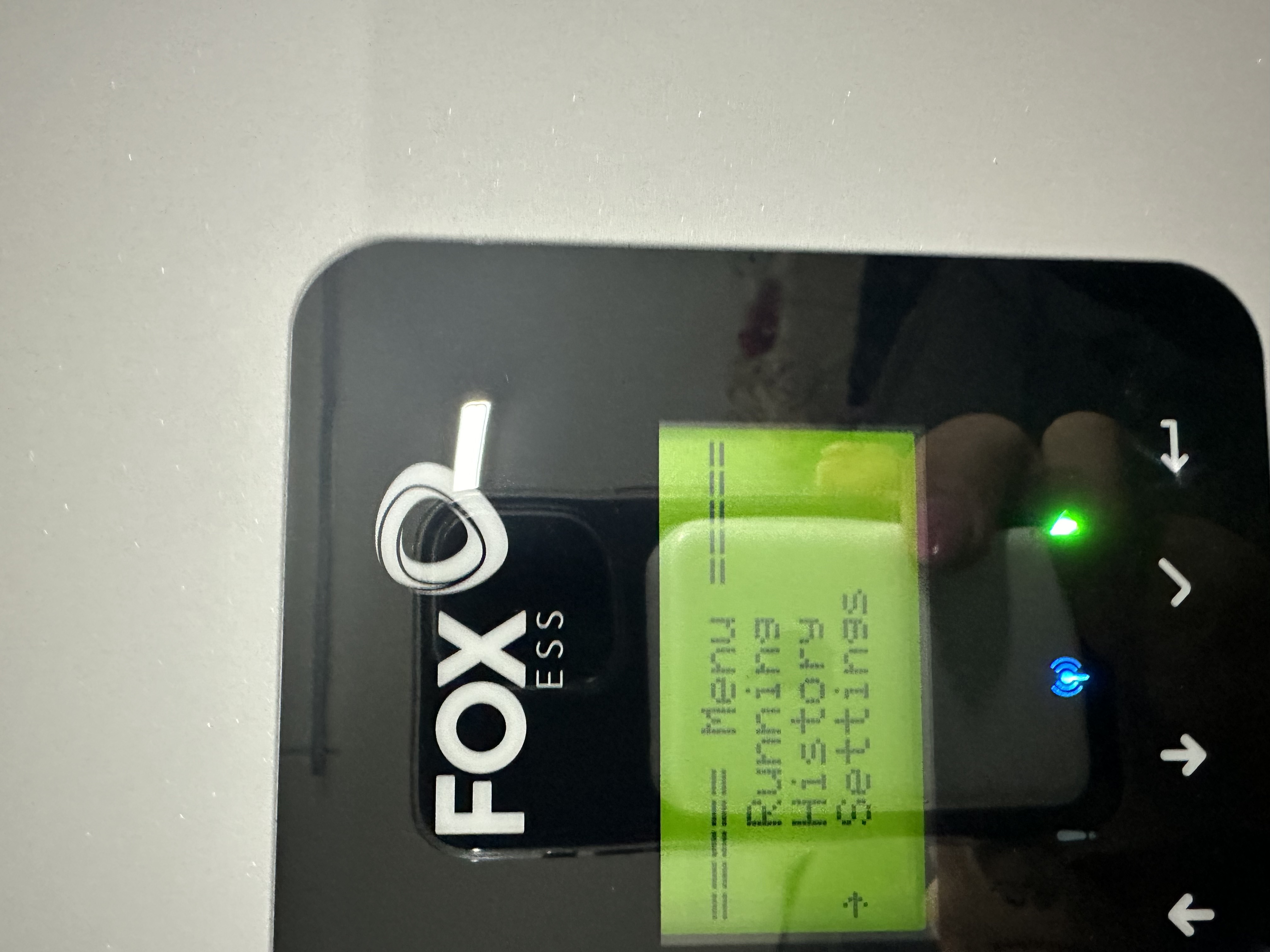

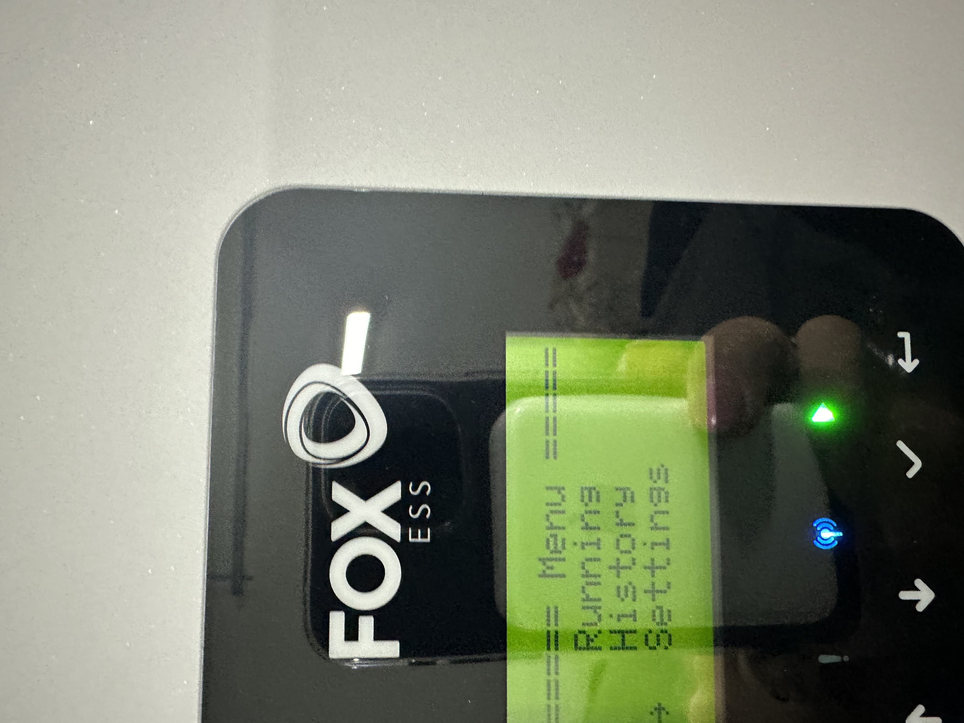

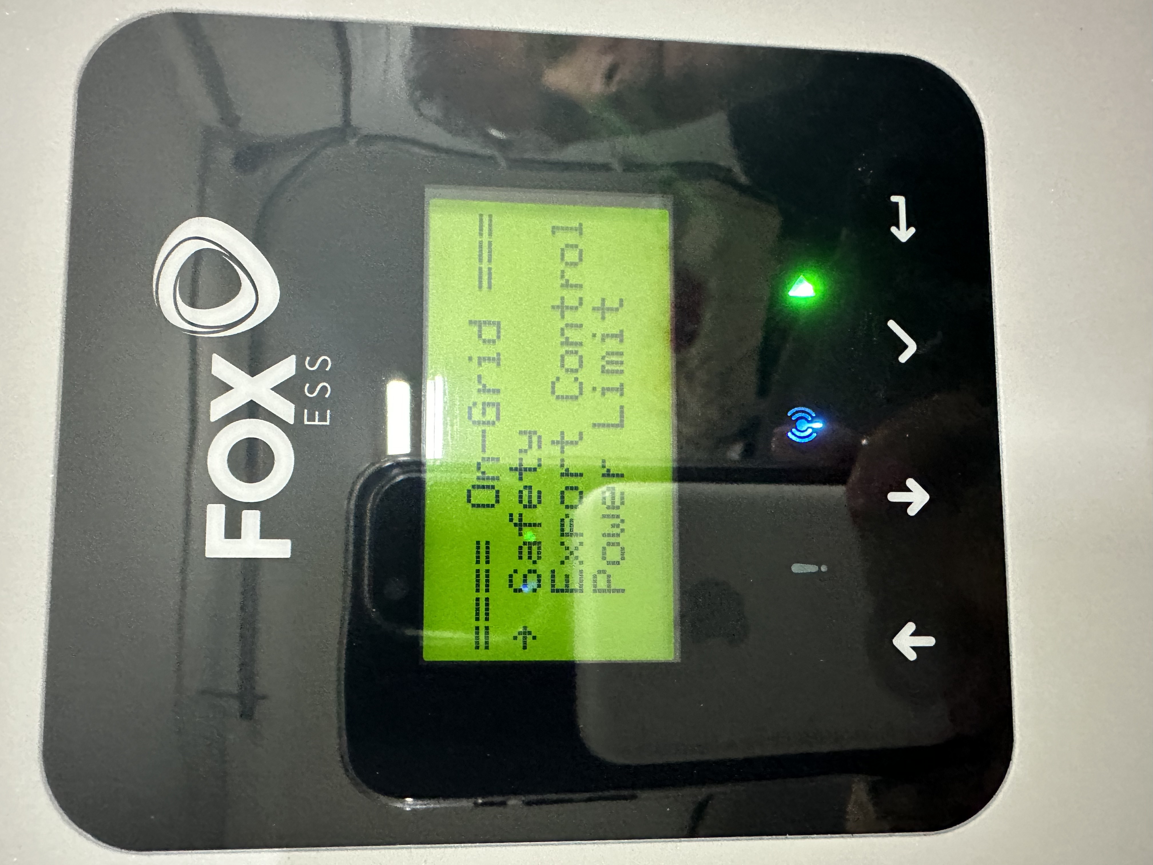

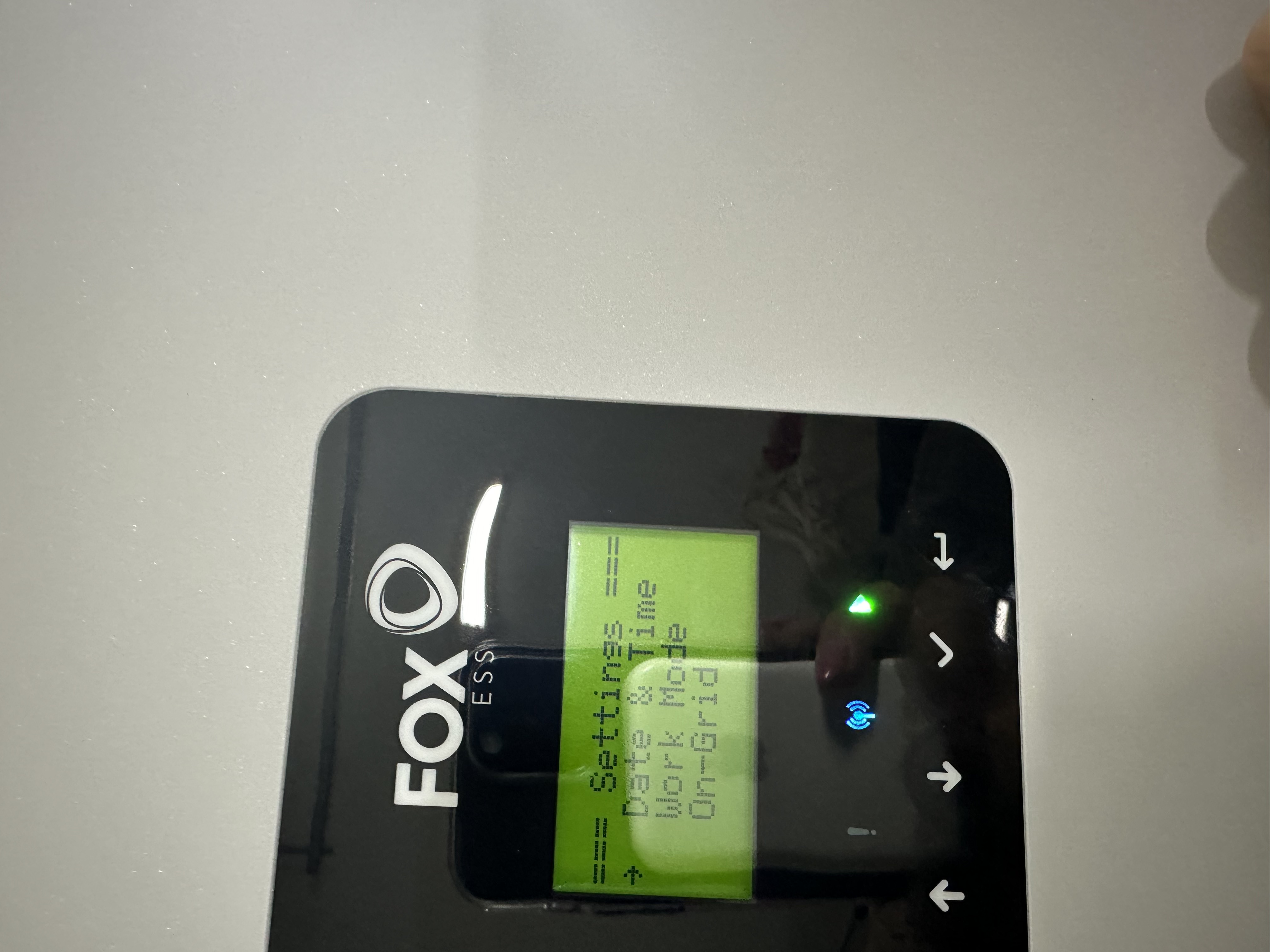

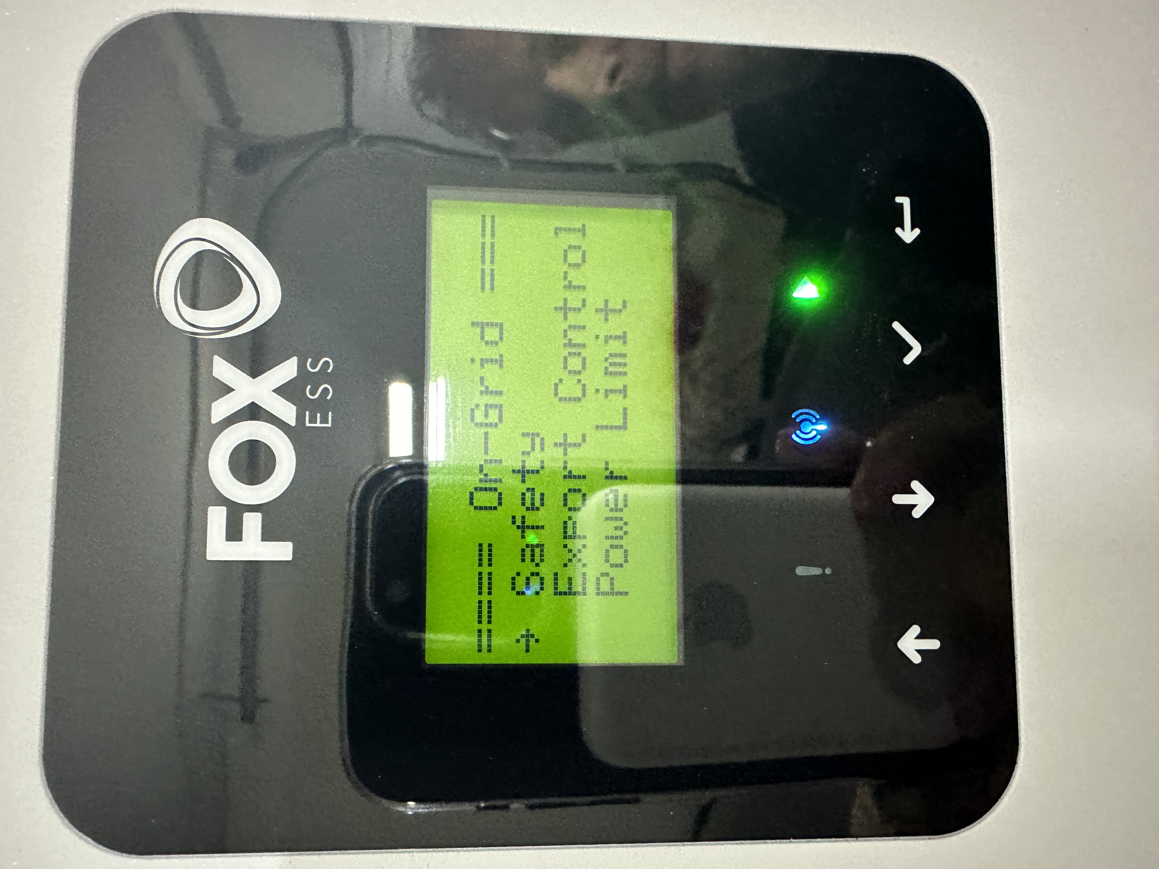

Hello, we have the same problem on H3-8-E but when we go into the menu it is totally different. Somebody an idea what to do?
Thank you.

- Joined: Fri Nov 24, 2023 12:23 pm
- Posts: 1305
thanks for the photos, very helpful - it looks like the main safety voltage parameters are not available on your H3 from the inverter panel.DianeAliseMonique wrote: ↑Sun Dec 03, 2023 10:25 am Good morning Dave, thank you for the quick response!
When I follow the steps and go to Safety I don't find what you are saying.
I put some pictures off the menu.
I am gonna call the installer.
Good idea, your installer will be able to change the settings for you on-line.
