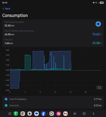

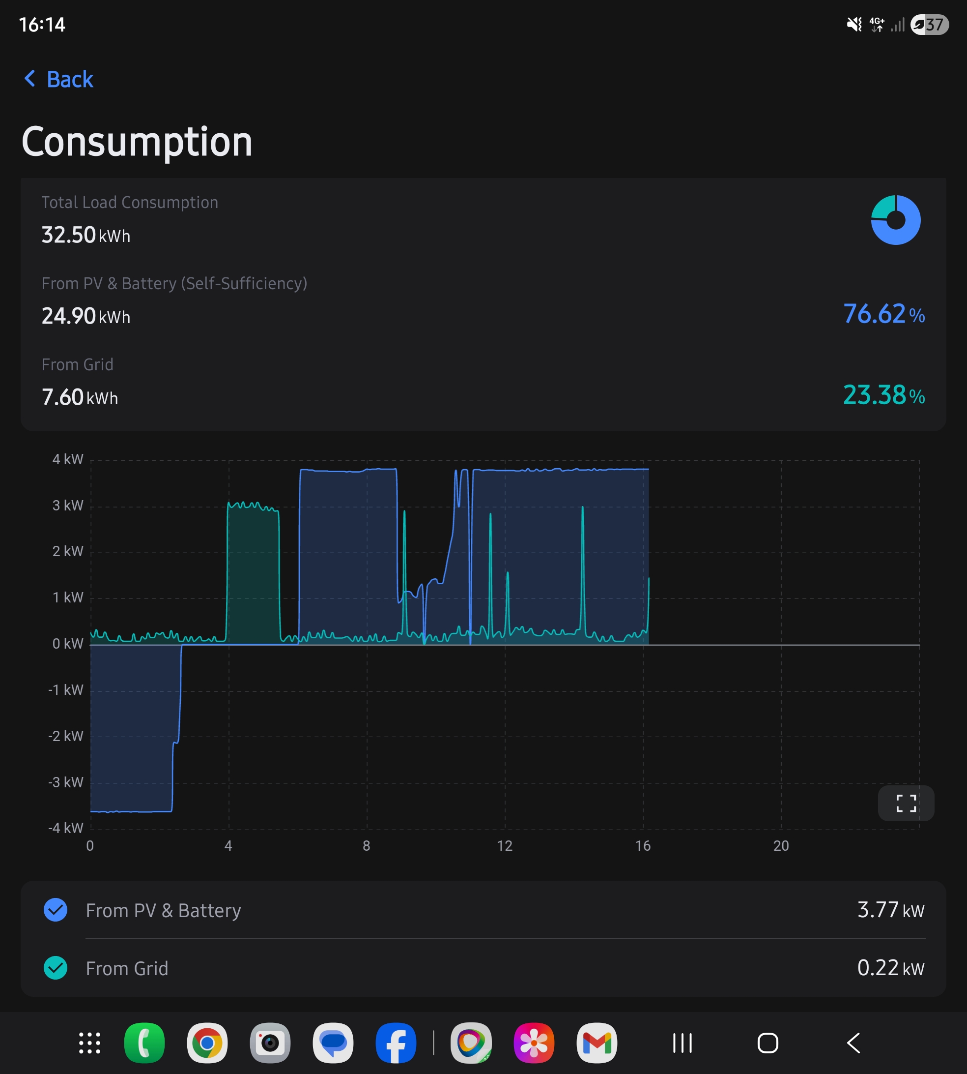

I've had the panels and a battery installed around a month ago and have waited until first bill to confirm my theory. The system seems to use the power from the panels well, however during the night and early morning the power comes from the grid but is registered as export. It best shows as we have an immersion heater to work between 4-6am. When panels don't generate power the system draws from the grid and ignores the battery and it is only dropping 1 or 2% and goes back to full after short while. Only works on forced charge/discharge.

Screenshot from the app showing immersion heater.
What does your power flow show your house load to be on the first page of the app ?, particularly when the panels are generating.

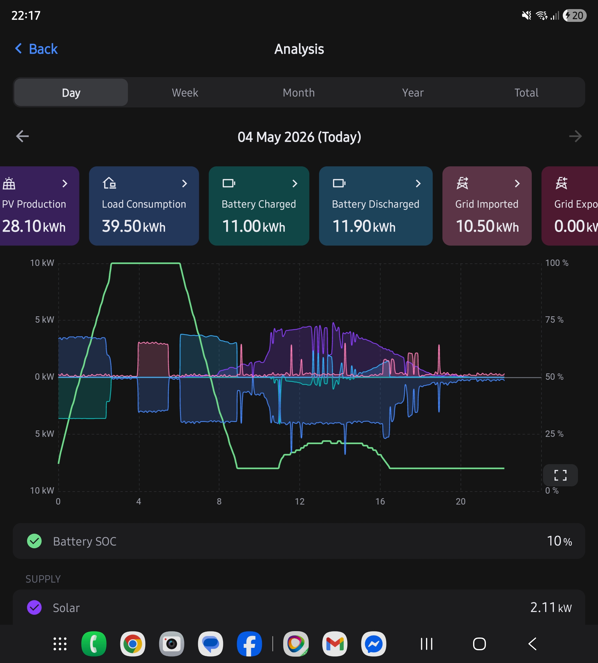

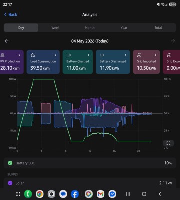

It would be helpful to see the graph you see when you click daily production off the main screen - that shows charge/discharge/pv and load together and you can also see the affect on battery soc.

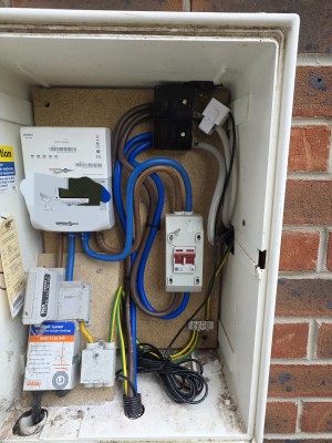

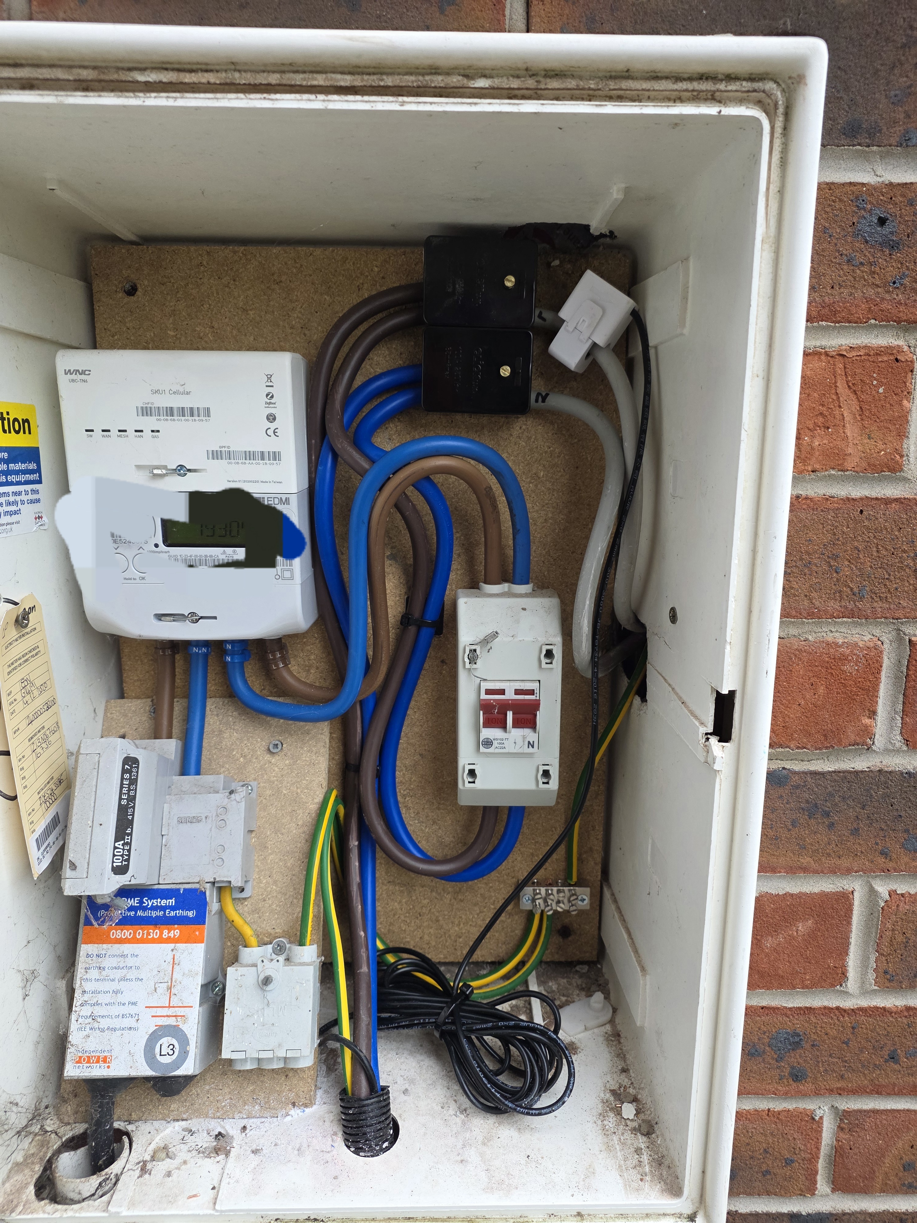

To start with the location the CT clamp should be clipped to the live feed from your smart meter and under normal conditions the arrow should be pointing towards the grid (but as already said if the cores are crossed in the connector this isn’t guaranteed), can you confirm where it is located please.
Yes, it is single phase. My understanding is that base load looks ok until battery is starting to discharge or panels starting to produce during the day. CT clamp is on the Live cable just before it goes intk the house to the fuse board. I will speak to the i staller tomorrow to see if they can send someone to have a look if it's all set up properly.
I would start by reversing the CT clamp direction again, it’s dumping the battery to the grid the moment it detects solar which confirms the direction is wrong and is wasting your energy - there is clearly another problem that is giving you negative load figures.
There’s a cable that runs out of the Henley block (black connector at the top) and down and exits the box at the bottom is that an EV charger or is it the connection to the Fox inverter ?.
Agreed get your installer back, there is an installer setting the allows the inverter to reverse the CT ‘sign’ if it thinks it is wrong and that should be disabled but the install needs to be checked to verify the power flows and CT positioning.
The black cable at the bottom is the ev charger.
