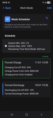

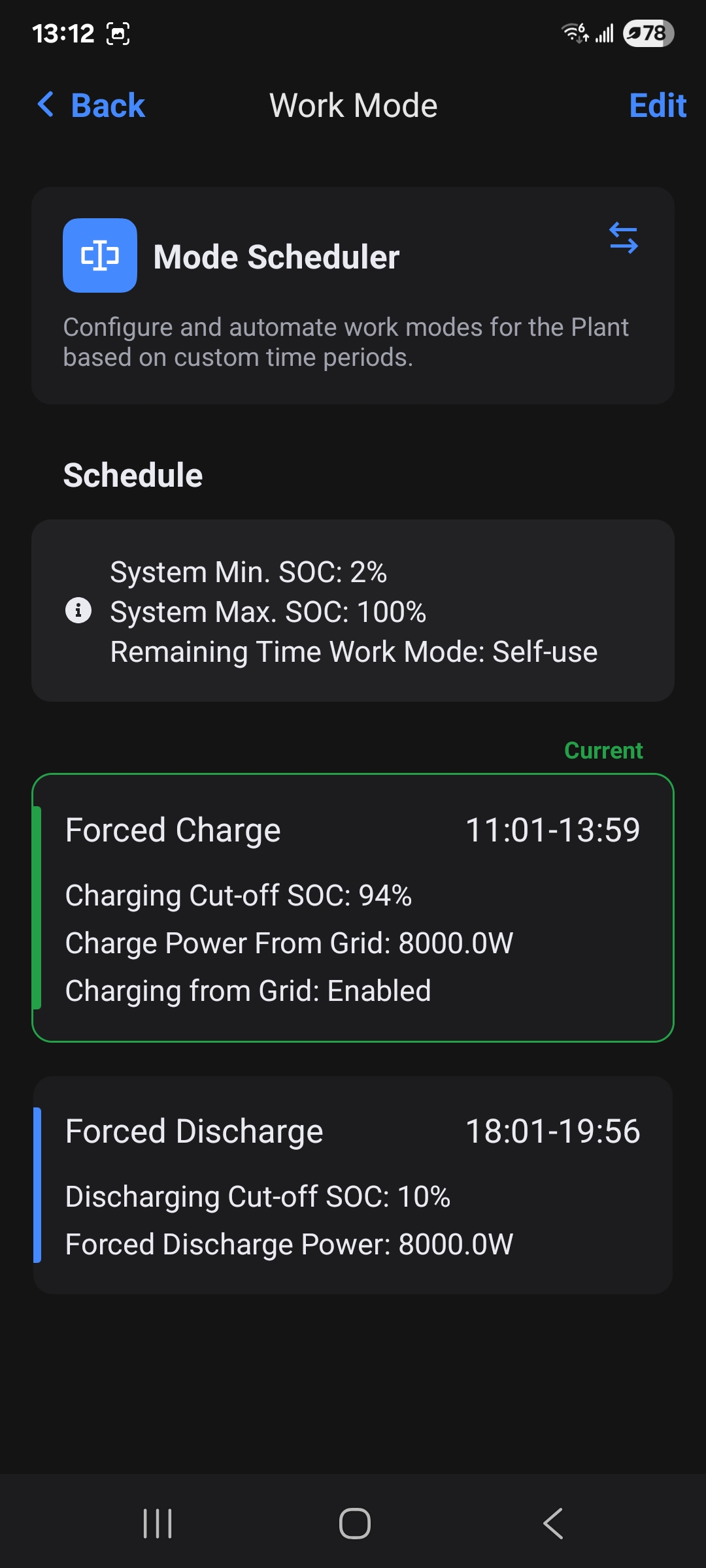

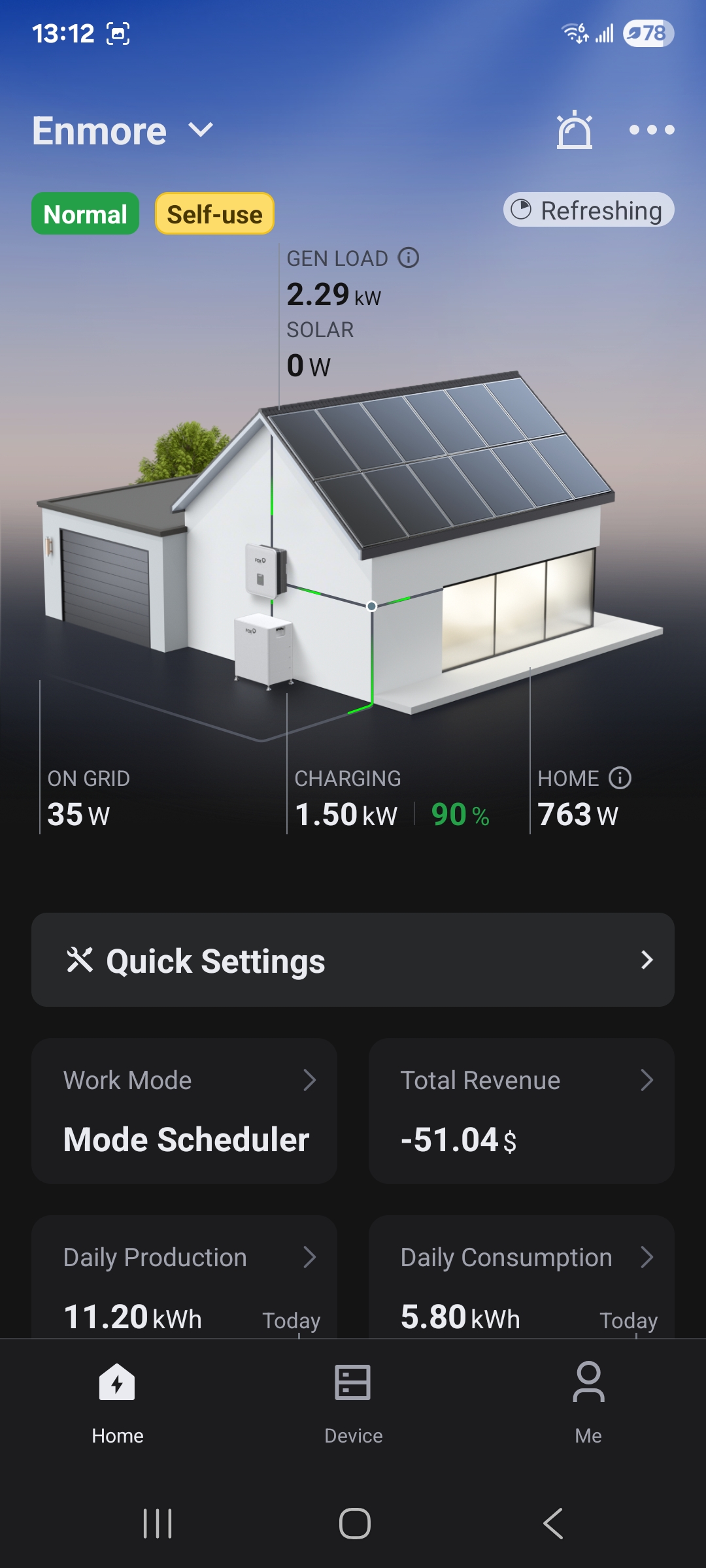

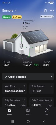

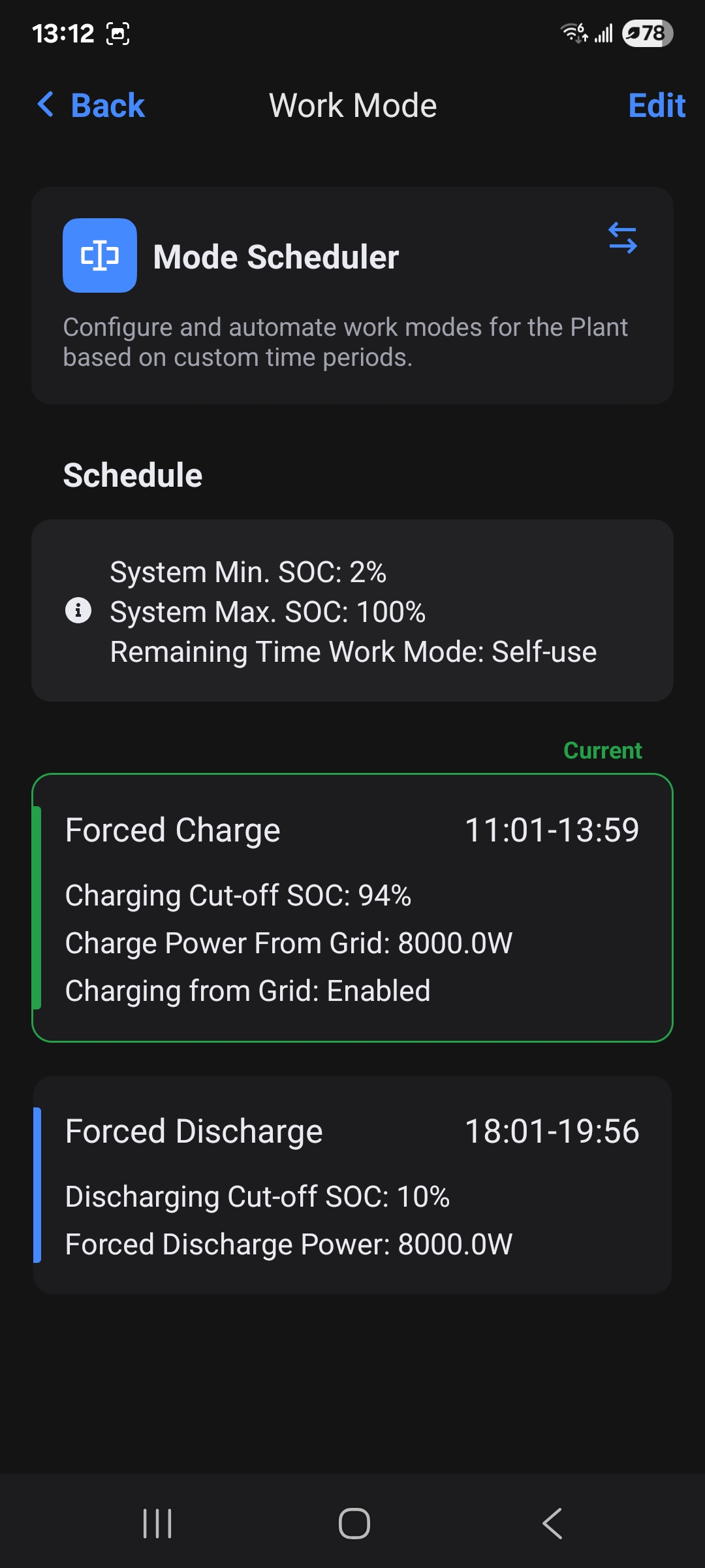

I have a force charge schedule where i have set "Charging cut-off SOC" at 94%:

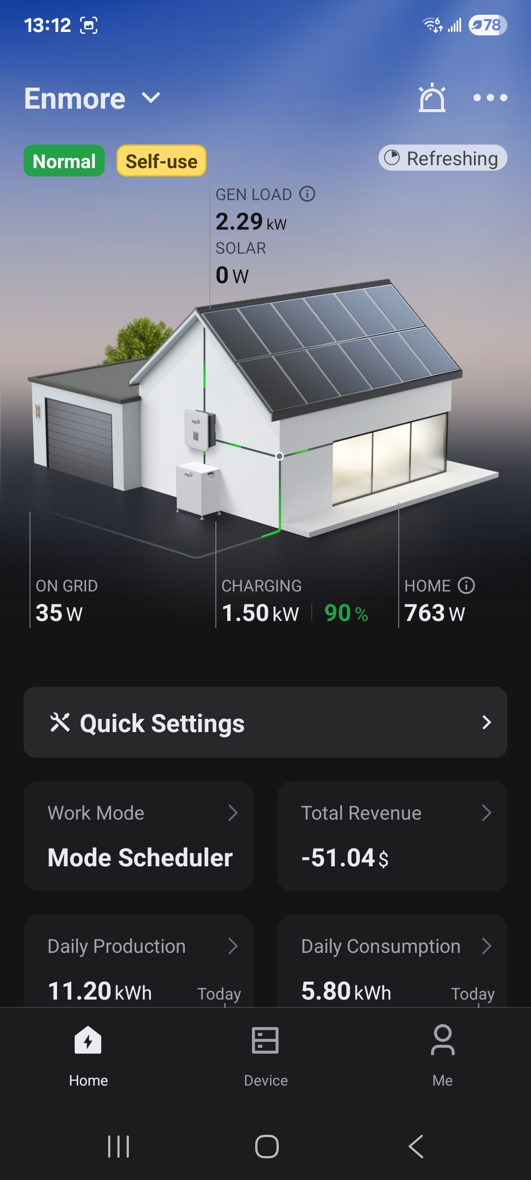

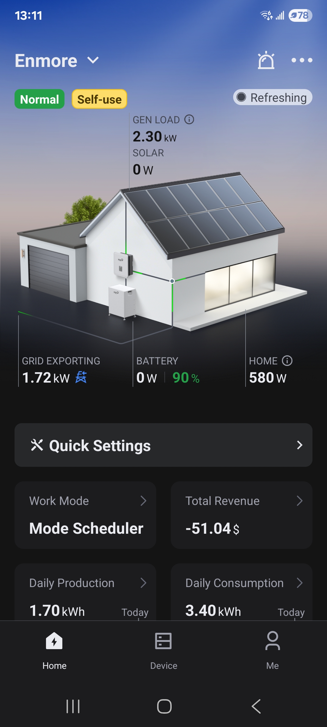

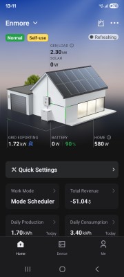

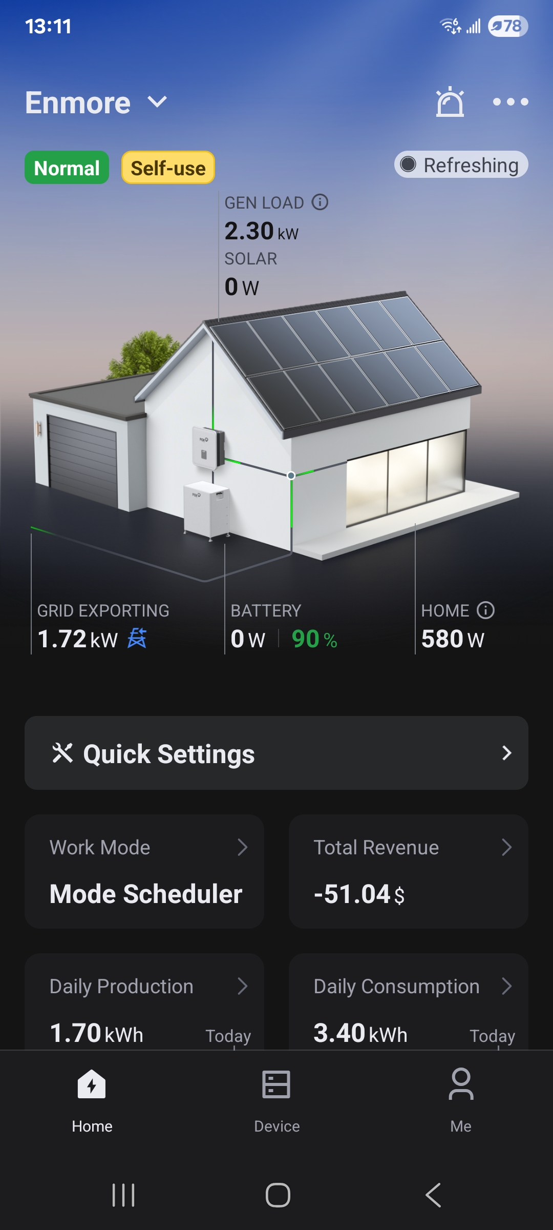

However once the battery reaches 90%, the mode scheduler stops and starts to export my solar to the grid:
It is not a temperature issue as once i turn off the force charge schedule the solar gets sent to the battery.
Any ideas why the force charge schedule is stopping at 90% and ignoring my Charging cut-off? With this limitation i am not able to hit 100% to balance the BMS properly as the solar by itself is not enough.
I have changed the 94% figure to 98%, 92%, 100% to no avail. It always stops charging from the grid and starts exporting my panel excess once the battery hits 90% and I have to manually turn off the schedule so that i can at least still charge from my panels.

First thing to check are your firmware versions, on a recent firmware update another maxsoc was added to the inverter settings but it’s not directly accessible through the app. At the inverter panel, go into Settings (password=0,0,0,0), then Battery and (depending on firmware) there may be 2 settings for MaxSoc - you may have to turn off your scheduler to change these but if present make sure they are both at 100%.
Thank you nrb501 and Dave.
I have updated that setting on the inverter itself. I also updated the minimums (was 10%) as we have the ability to set <10% in Australia but i couldn't get mode scheduler to go below <10% in force discharge despite stipulating it in the app -- now i know why!

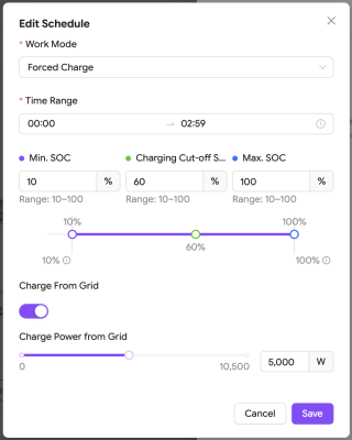

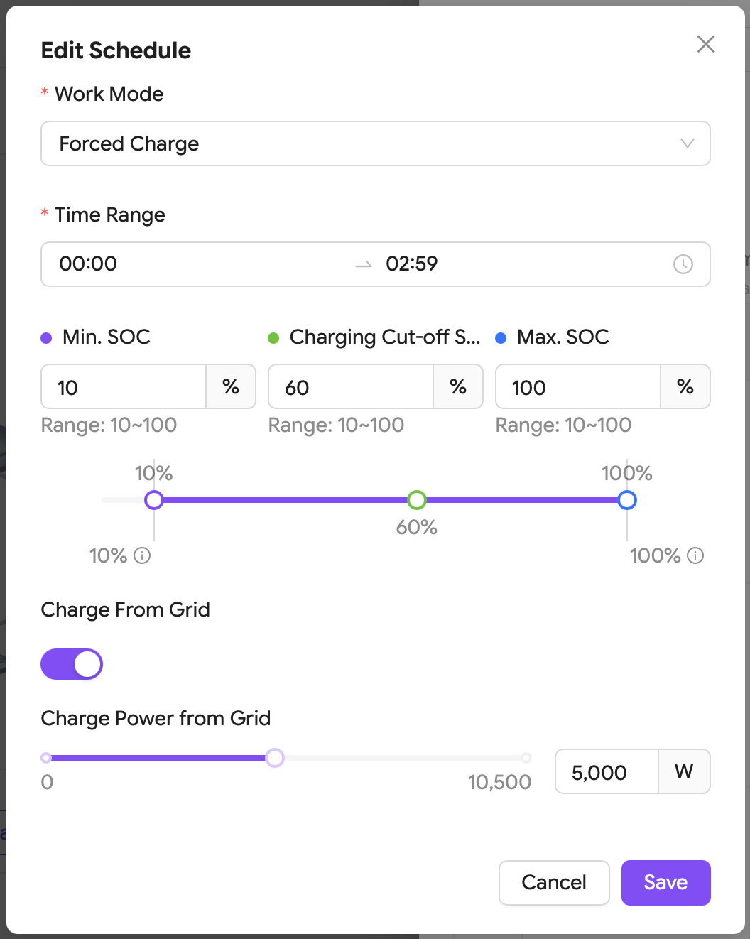

After a bit of digging it seems like the max SoC can now be set using mode scheduler via the cloud web access (not the app - yet)

Hi Dave / NRB501,
Confirming that changing the MaxSoc setting on the inverter itself has resolved this issue.
Thank you again.
