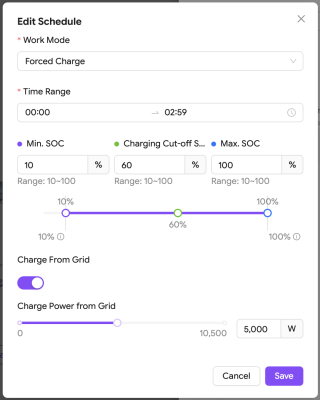

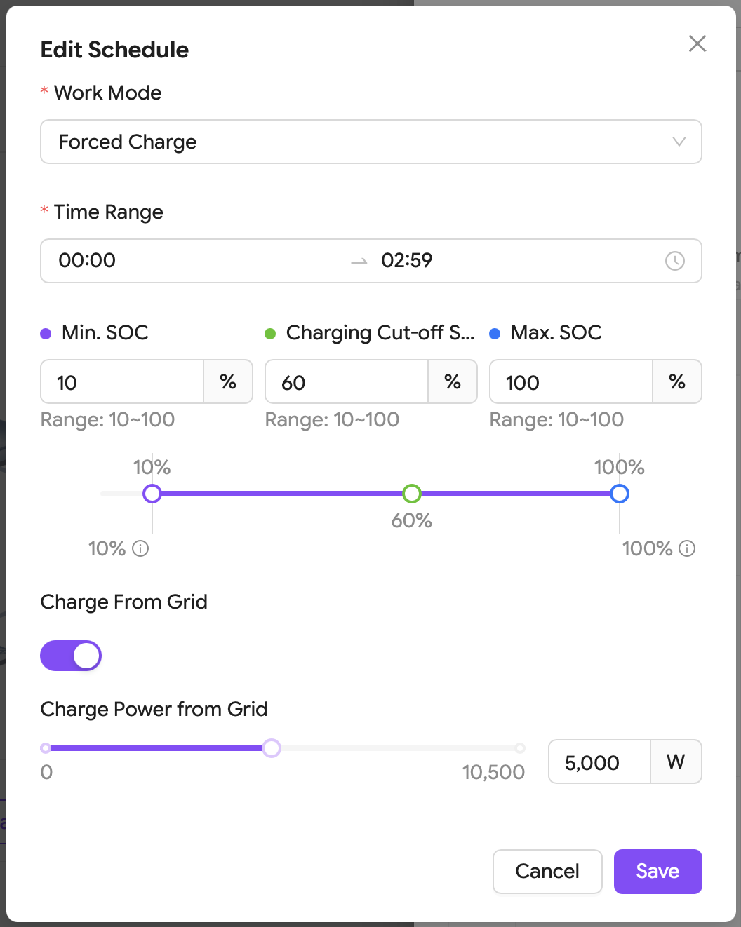

After a bit of digging it seems like the max SoC can now be set using mode scheduler via the cloud web access (not the app - yet)
