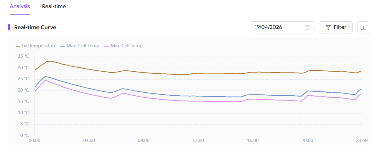

Can you check again for the date in question, and filter for the following
You should see the Bat Min Cell Temp is much lower (sorry I forgot the correct full name yesterday)
You will be able to see that the Battery Temp is much higher, as this is reading the BMS circuit inside, and the Cell Temps are much lower.
The lower line of Min Cell Temp is the one that is controlling your charge rate.
With my EP11 (1.011 FW) on a KH7 Inverter (Current based on the Battery Voltage nominal of 384V)
5.5 Amps up to 10.9°C
10.0 Amps from 11°C to 15.9°C
13.0 Amps from 16°C to 20.9°C
18.0 Amps above 21°C
