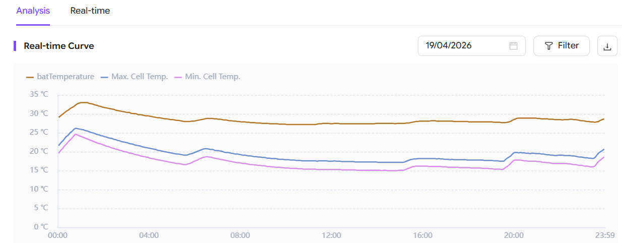

At 11am the battery temperature was 21.3C and steadily increased during the charging period so according the post from @Dave Foster would not expect any throttling of the charing rate during that time. There does not seem to be any correlation to temperature and looks suspiciously like the chargng rate is now adjusting with the SOC (50%, 80%, 90%, 95%). I'll monitor over the next few days.

Can you check again for the date in question, and filter for the following
You should see the Bat Min Cell Temp is much lower (sorry I forgot the correct full name yesterday)
You will be able to see that the Battery Temp is much higher, as this is reading the BMS circuit inside, and the Cell Temps are much lower.
The lower line of Min Cell Temp is the one that is controlling your charge rate.
