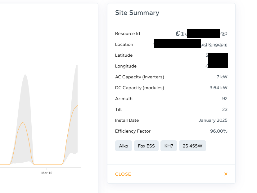

phew. glad i put in my install date - i was thinking when i first set up, why does it matter!
im actua;;y happy about the overproduction as long as its not drastic..
i use forecast to set charge limits on battery, so doing slightly more from the sun is ok for me..
It's used to predict how much the panels have degraded, and why production has reduced over time.AdamNewberry wrote: ↑Sat Mar 07, 2026 12:29 pm phew. glad i put in my install date - i was thinking when i first set up, why does it matter!
However it's just that, a prediction, and tweaking that alone can better match production with forecasts.
I'm not sure if Solcast does better in Australia because they are/were an Australian company, or that forecast.solar doesn't do as well because the site is European based, but forecast.solar can be all over the place some days, since doing lots of parameter tweaking on Solcast settings, it's pretty close most of the time, but the API limit is very limiting.AdamNewberry wrote: ↑Sat Mar 07, 2026 12:29 pm i use forecast to set charge limits on battery, so doing slightly more from the sun is ok for me..
You can tweak the panel efficiency in the solcast setup, I think it is set at 90% originally which represents a decade of degradation. Try about 96% for a new installation and see how it performs on a clear day. It's hard to compare it on a cloudy day because it's mostly the clouds which determine that day's production.
Looks like degredation defaults are by panel type
I'm pretty sure that for hobbyists accounts, solcast only gives you forecasts in kW, and you then need to turn that 30min guesstimate into a kWh number.

This is what it gives you for hobbyist accounts (this is my west array):
Note you cannot specify the cell technology, only an efficiency factor. Also, it does not seem to take the installation date into account for hobbyist accounts, since if I recall correctly, it was at 90% from the start, and I had to manually set it to 96%.

I had to set our 3kW system to 90% and the 1kW system to 80% to get matching forecasts.WyndStryke wrote: ↑Sat Mar 07, 2026 2:05 pm Note you cannot specify the cell technology, only an efficiency factor. Also, it does not seem to take the installation date into account for hobbyist accounts, since if I recall correctly, it was at 90% from the start, and I had to manually set it to 96%.
Since I'm using it in a python script I just multiply it by 0.5 for kWh, my comment was making it known that's what you get, that's all.WyndStryke wrote: ↑Sat Mar 07, 2026 2:05 pm Regarding the kW to kWh conversion, the Solcast integration on home assistant will do this for you for the overall generation, and the individual array generation.
Just have to tweak the settings properly before that will happen.WyndStryke wrote: ↑Sat Mar 07, 2026 2:05 pm From what I've seen, in the UK, solcast consistently performs significantly better than forecast.solar.
The Solcast forecast for today suggested that we might get ~20.0kWh for both systems and we've had 19.1kWh with the panels still doing a couple of light bulbs worth of power.
forecast.solar this morning said we'd get ~8kWh, although the forecast did improve as the day went on in subsequent forecasts.
