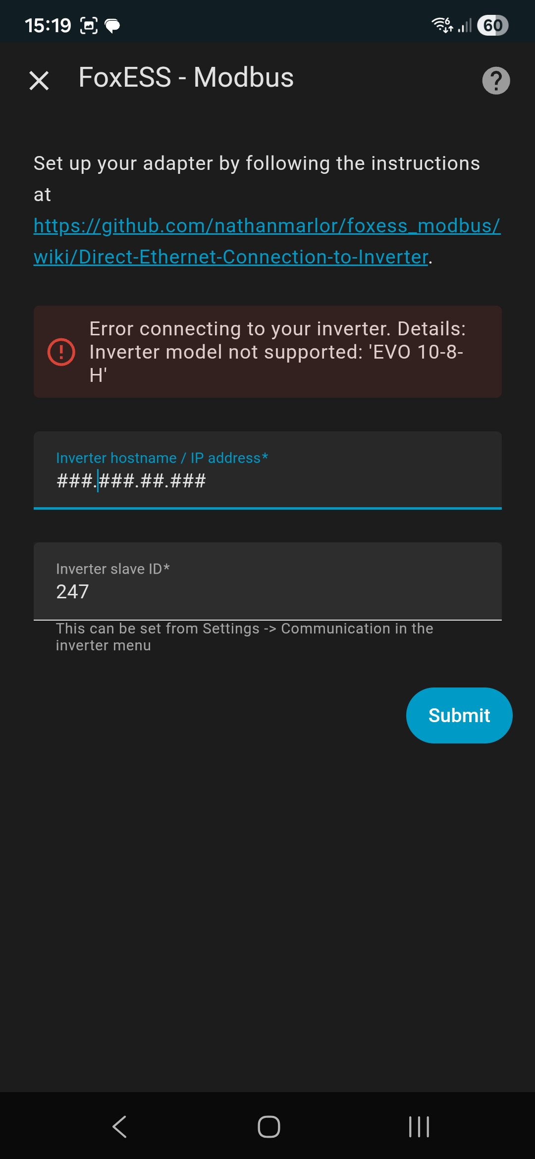

That unfortunately is the big question, which spec is it following as there are 2 very different modbus spec and a number of hybrids in between.
I’ve just seen your post on github and I would say the easiest thing to try is to intercept an existing inverter profile and test with that, i’m guessing maybe the H1 G2 is the best starting point - you’ll find the inverter models are created in the custom_components/foxess_modbus/inverter_profiles.py so for example if the model name is H1-6.0-E-G2 then it will run the H1 G2 register set.
Your post says it’s reported the model name as 'EVO 10-8-H' so if want to test as an H1 G2 then edit line 270 which is
InverterModel.H1_G2, r"^H1-([\d\.]+)-E-G2", capacity_parser=CapacityParser.H1
And change it to catch that model name - something like this should do it.
InverterModel.H1_G2, r"^EVO ([\d\.]+)-8-H", capacity_parser=CapacityParser.H1
Then restart you HA and add the adapter again and hopefully you should get a reasonable amount working - any fine tuning can come after that.

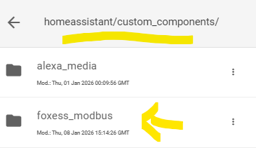

I've downloaded the zip file>extracted> copied the foxess_modbus folder and put it into: Home assitant/custom_components:
modbus in cust.png (14.02 KiB) Viewed 118025 times
I then restart but it doesn't show up in the downloaded (available) in HACS.

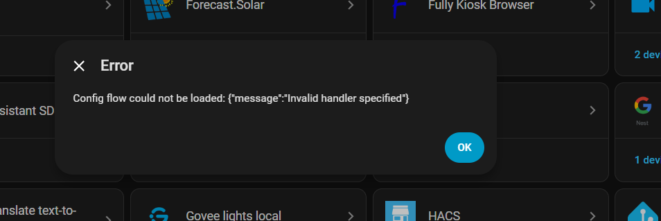

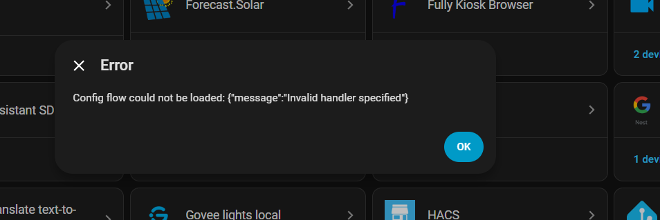

If I try to instal the integration through the normal integrations page I can select it to setup as a new integration but then it fails with an error Config flow could not be loaded: {"message":"Invalid handler specified"}:
i'm obviously doing something wrong :-(
Thought I would try and succeeding at this before buying the modbus adaptor.
Re: Fox EVO 10-8-H modbus registers
hi Steve,
maybe i made a mistake - if you manually install the folder, dont look in HACS, rather just go to add the integration on setting>devices and service page.sorry for that confusion. if thats not working, I'm running fully on GPT at this point:
Code: Select all
That **“Invalid handler specified”** almost always happens when Home Assistant **can’t find the integration’s domain in `/custom_components`** (usually because the folder got copied in the wrong place / wrong name / nested too deep).
In your fork, the integration lives under a `custom_components` folder in the repo. ([GitHub][1])
So your friend needs to copy **only the integration folder inside that**, not the whole repo.
## What to tell your friend to do
1. **Remove any existing install first (important)**
* If they already installed Nathan’s original via HACS or manual, delete it from:
  * `/config/custom_components/foxess_modbus` (or whatever folder it used)
* Restart Home Assistant once.
2. **Copy the right folder (most important bit)**
   After unzipping your GitHub ZIP, they must end up with:
/config/custom_components/foxess_modbus/manifest.json
**Not:**
* `/config/custom_components/foxess_modbus_EVO/...`
* `/config/custom_components/foxess_modbus_EVO-main/custom_components/foxess_modbus/...`
That nesting is the #1 cause of this exact error.
3. **Restart Home Assistant (full restart)**
   Settings → System → Restart
4. If it still errors, check logs
   Settings → System → Logs
   Look for lines mentioning `foxess_modbus` / `custom_components` (this will reveal missing dependency / import error, etc.).
### Why this is especially likely here
Your repo is a fork of `nathanmarlor/foxess_modbus` ([GitHub][1]), so the integration **domain is almost certainly still `foxess_modbus`**. If your friend renamed the folder to something like `foxess_modbus_EVO`, Home Assistant will try to start the config flow using the domain from the UI, won’t find the right handler, and you get **Invalid handler specified**.
If you want, paste your `custom_components/.../manifest.json` (just the JSON) and I’ll tell you the exact **domain** name your friend’s folder must use.
[1]: https://github.com/AdamNewberry/foxess_modbus_EVO/tree/main "GitHub - AdamNewberry/foxess_modbus_EVO: FoxESS inverter integration with Fox EVO support. Connect directly to your FoxESS inverter (no cloud!) for real-time status and control."
Perfect — thanks, that confirms it 👍
Your `manifest.json` is **correct** and **not the problem**.
Given this manifest, the error **must** be one of the following **three concrete causes** (in order of likelihood):
## ✅ What *must* be true for this to work
### 1️⃣ Folder name **must be exactly** `foxess_modbus`
Because:
```json
"domain": "foxess_modbus"
Your friend **must have**:
❌ Any of these will cause **Invalid handler specified**:
/config/custom_components/foxess_modbus-main/
This is the **single most common cause** of this error.
### 2️⃣ The integration is loading, but `config_flow.py` is missing or broken
Because you have:
```json
"config_flow": true
Home Assistant expects:
/config/custom_components/foxess_modbus/config_flow.py
If:
* the file is missing
* renamed
* has a Python error
* imports something that fails
→ HA cannot register the config flow handler
→ **Invalid handler specified**
📌 Ask your friend to check **Logs** immediately after restart:
They should see an error mentioning `foxess_modbus`.
### 3️⃣ There is a **domain collision** with an existing FoxESS install
If your friend previously installed:
* Nathan’s original via **HACS**
* or a previous manual install
Then HA may be loading the wrong version or failing silently.
**Fix sequence (important):**
1. Delete **all** FoxESS folders under:
2. Uninstall from HACS if present
3. Restart Home Assistant
4. Install **only your fork**
5. Restart again
## 🔎 One very fast sanity test
Tell your friend to temporarily rename the folder to something wrong, like:
foxess_modbus_test
Restart HA → the integration should **not appear at all**.
Rename it back to:
foxess_modbus
Restart → it **should appear**.
If it appears but errors when clicked → it’s **100% a config_flow.py error**.
## 🧠 Most likely root cause (based on your repo)
Because your repo structure is:
foxess_modbus_EVO/
└── custom_components/
    └── foxess_modbus/
Your friend almost certainly copied **the repo root** instead of the inner `foxess_modbus` folder.
## ✅ The exact instruction to give your friend
> Copy **only** the `foxess_modbus` folder from inside the repo’s `custom_components` directory into:
> Then restart Home Assistant.
If after that it *still* fails, paste the **first foxess_modbus error from the HA logs**, and I’ll pinpoint the exact line in your fork that’s breaking the config flow.
Thank you, yeah, that's what I tried to do 🙁 I'll have to put the hours in to try and get it working 🤣
