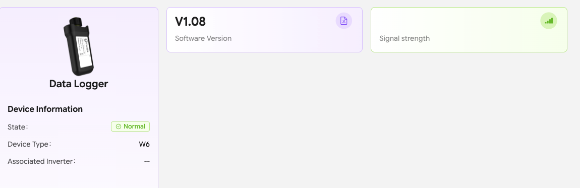

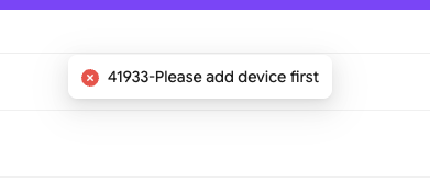

New installation with KH10 inverter and WiFi data logger. Data Logger shows associated inverter as blank. I've tried re configuring and delete / creating new plant without much help at all.
When I log into app (foxcloud 2.0), it shows the message "your device is not yet online... ".
Under devices tab, I can see my data logger and it's connected to WiFi and I can view it via my local network and also from when I'm outside (so basically the wifi module is reachable via network). But the inverter seems to have trouble communicating with Data Logger.

Below are 2 screens taken from web portal

If your plant is missing from the setup, so Inverter and battery, then you won't get much going.
I guess you can only see the datalogger and nothing else?

G’day,
Yes I can only see data logger. Inverter (and the battery) is not communicating to the data logger.
Was on call with customer support earlier and they asked to re setup (add and remove plant, reset data logger etc), but sadly it goes back to the same state.
