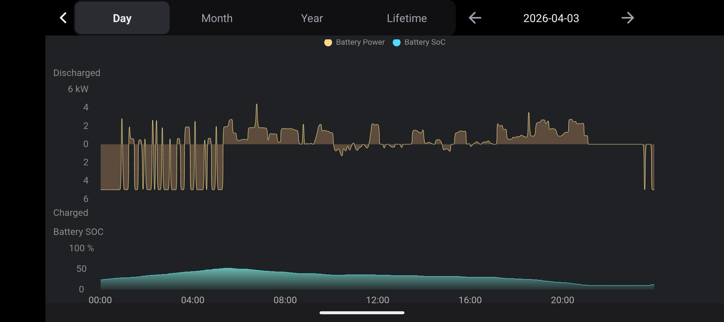

So, the saga continues. Last night, the batteries only got to 45%
I did some searching and found something that said that a flaky WiFi connection could cause this. It implied that the inverter is constantly asking what mode it needs to be in. If it doesn't get an answer then it defaults to self use until it gets told otherwise.

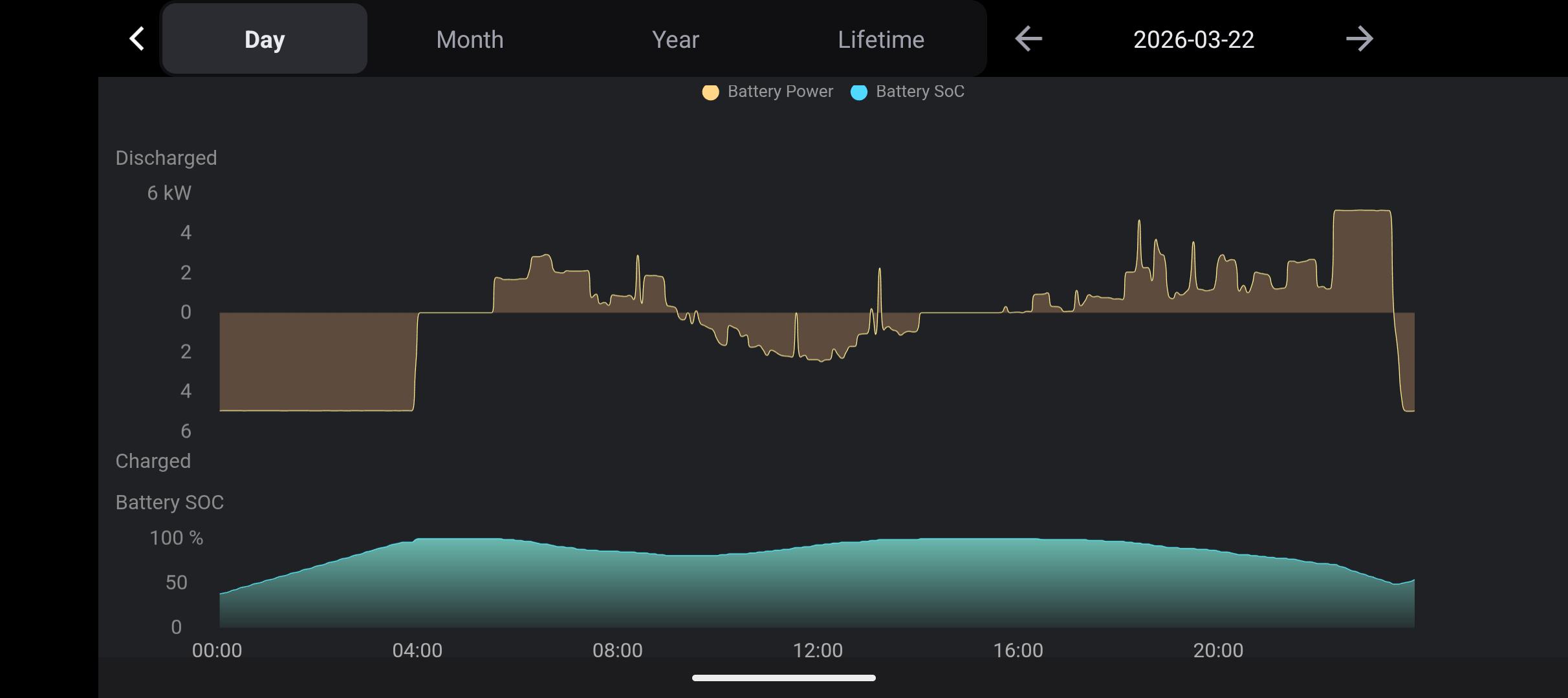

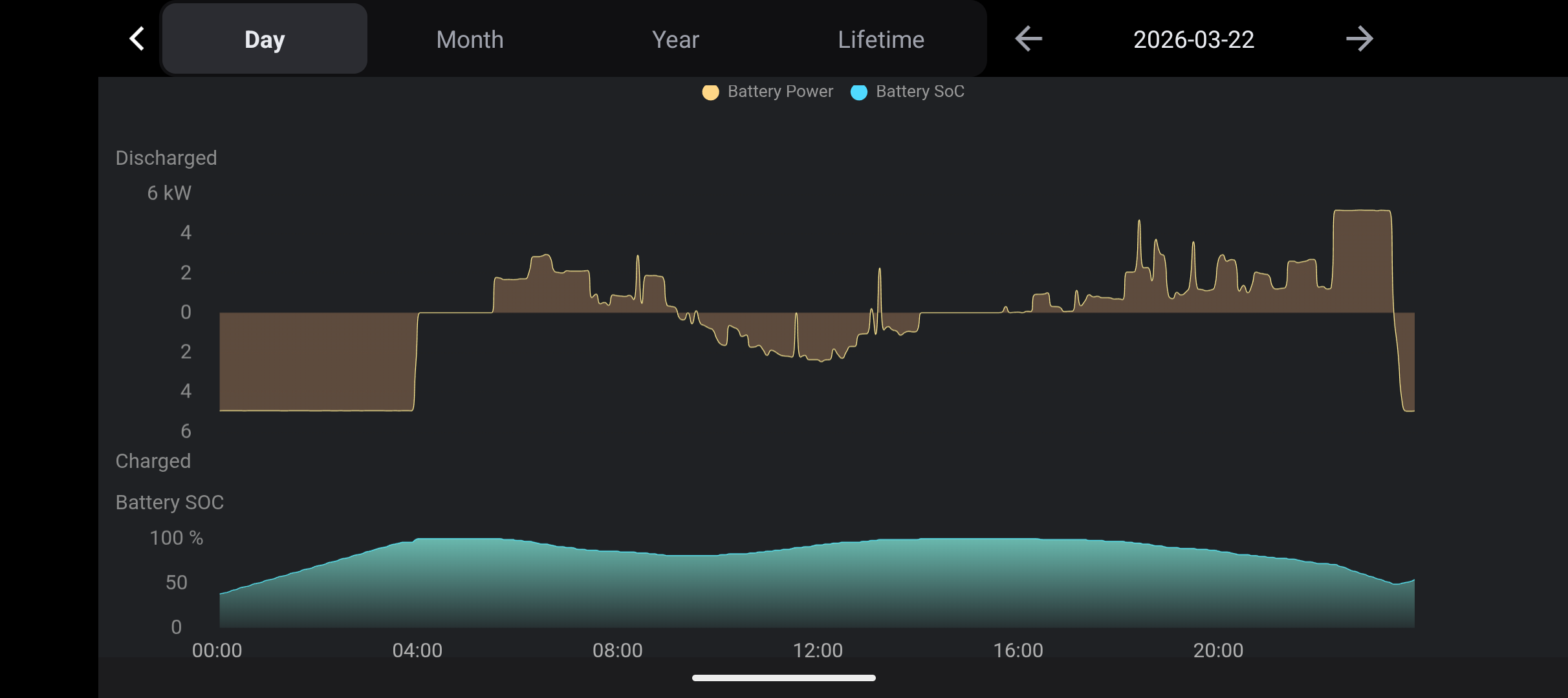

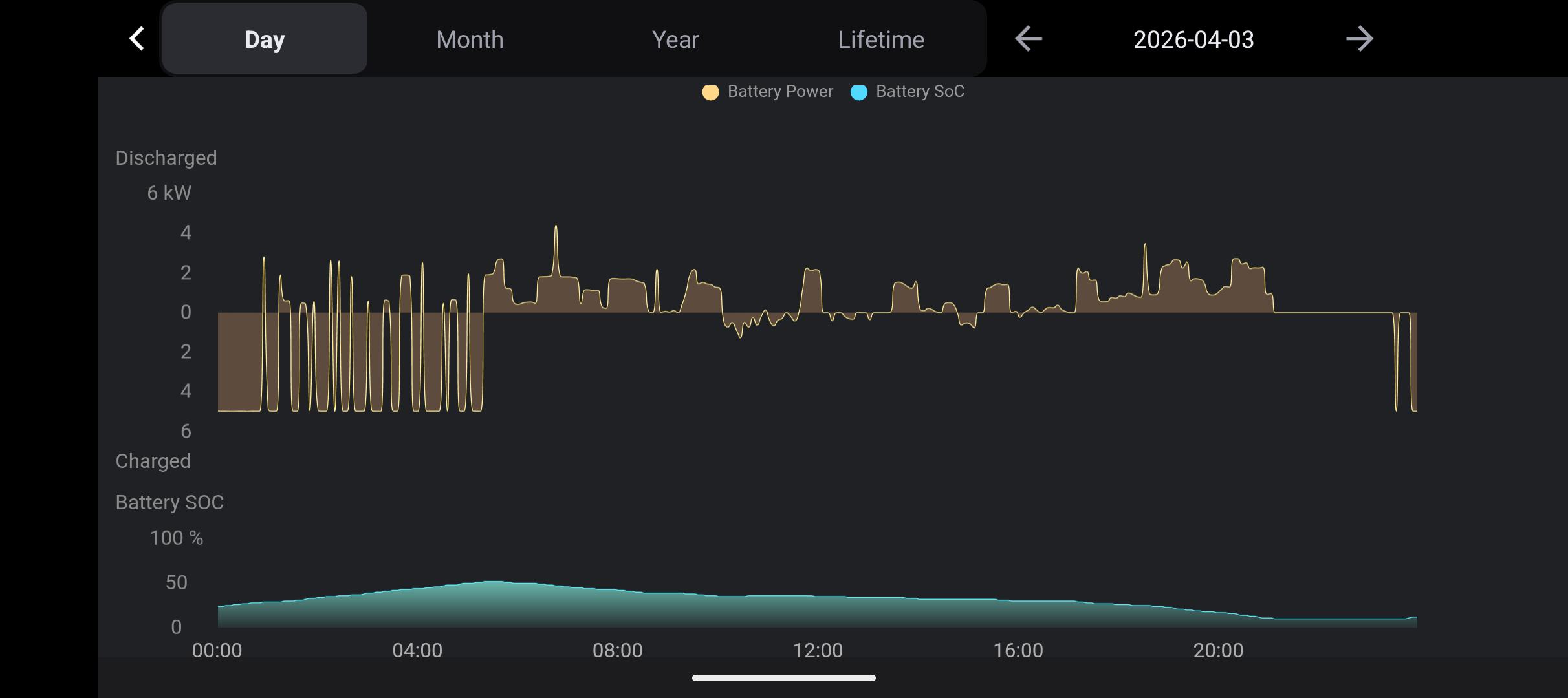

That kind of stacks up if you look at these 2 graphs. You can see that one is nice and neat over the charging period. The other seems to be charging sporadically.
This *does* tie in with me swapping the WiFi to my Dream Machine.
I'm going to swap back to the EE router but I wondered if anyone had any thoughts on this.
