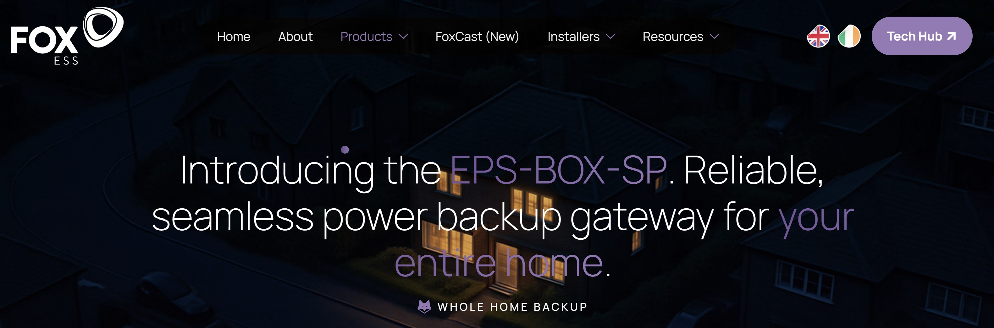

An unexpected power cut tested out the new installation today...and I am not happy
The whole point of using this expensive system was to prevent interruption of the supply to the house
The website https://fox-ess.uk/eps-box-sp-backup-gateway/#eps-more makes a point of, and clearly states that it provides uninterrupted power, changes over instantly, seamlessly and without interruption
I quote:
Whole home backup for residential storage installations
The Fox ESS EPS-BOX-SP is a single-phase whole home backup gateway that provides uninterrupted power during grid outages. Designed for single-phase installations, it automatically switches between on-grid and off-grid modes to keep your essential (or all) household circuits running without interruption.
How it works
The EPS-BOX-SP sits between your Fox ESS inverter, utility supply, and household circuits.
Normal Operation – When the grid is active, power flows normally from your solar and grid supply.
Power Outage – The EPS-BOX-SP instantly disconnects from the grid and switches to your battery and solar supply, maintaining power to your home.
Grid Restoration – When the grid returns, it seamlessly reconnects and resumes standard operation.
...except that it doesnt....when the power cut happened the whole house went off, then a few seconds later (!!!!) the supply to the house resumed from the battery......when the power came back again the same thing happened
I later ran the test again this time using the supply isolator switch to give a clean break and exactly the same happened.....router died, NAS offline, CCTV offline, PC shutdown potentially with open files then went offline etc. etc
Even this says the switchover time is only 20mS
https://www.google.com/search?q=fox+kh7 ... fId=ChxjMe
This is exactly the scenario I was hoping to avoid!

The wording in the page you link to is somewhat misleading, the EPS Box has a transfer time of "less than 3 seconds" according to the user manual https://theecosupermarket.co.uk/wp-cont ... 9VBc9c.pdf. As it uses an electromechanical changeover switch there is no way it can achieve a 20mS break.
The 20mS changeover is only mentioned in the inverter documentation for the EPS output.
So if I've read it correctly, the only way to achieve a 20mS maximum break time is to run the inverter as a UPS, directly feeding the load from the EPS output, with the EPS output set to operate in UPS mode.

That makes the EPS output act as a UPS output BUT it is only connected to the load by the EPS box in the event of an incoming mains failure being detected by the changeover relay in the EPS box, hence the delay.

Their UK website is very clear on what it can do, they have been cheeky when it comes to reality.
From reading around here and there, it seems there maybe a difference in markets, though I could be wrong. For example some get 3s switchover, others get 20ms or such.
It will be interesting to hear what Fox has to say on this matter.

nothing is ever going to be done in a fraction of a second. That short delay is normal because your inverter is constantly monitoring the grid. When a power cut happens, it doesn’t switch instantly—it usually waits a fraction of a second to confirm the outage is real, not just a brief fluctuation or spike from the grid.
Once the inverter has confirmed there is a power outage, it disconnects from the grid and then prepares back up mode. This is always going to take a few seconds and usually a maximum of 5 seconds.
Fox have used the term ‘uninterrupted power’ very loosely, and it would be more accurate to say that your system has a swift switch over to backup so that you can continue with whichever activity you were doing, rather than having to stop completely until the power comes back on. It seamless and automatic in the sense that you do not have to manually instruct the system to go into backup mode.
There is no system out there that will complete the backup switchover in a fraction of a second, it is just not possible.
Fact remains that Fox are stating it is immediate and without interruption

Fox have replied....its not ambiguity it is clear mis selling and downright lies
I can see there is some ambiguity in the website content. What this is referencing is the automatic switchover - seamless in the sense there is no manual intervention.
A true UPS (zero-break) is not possible with equipment of this type - no manufacturer can offer this. A home battery system will detect outage, open the contactor, form grid and then resynchronise - so there is a short delay This is something we communicate to our installers during training so that they are informed when selling to customers - we demo the switch over with lights showing the 1-2 second delay. This is also referenced of page 1 of the product manual. The assumption would be that this is a known limitation of the technology, but we have instructed to web team to change the wording to avoid confusion like this.
For IT loads to have true UPS, a small plug-in UPS for critical devices is usually installed to bridge the short delay.

Definitely porkie pies, would recommend you print the webpage to PDF before they make adjustments.
I am sure that my own eyes, and Will's posted video do proove otherwise that it can be nearly instantaneous.
You are going to have to change the box over as it's not fit for your needs, or fit some small UPS's back to your kit again.

well well well... their website https://fox-ess.uk/eps-box-sp-backup-gateway/#eps-more has literally just been updated to add
"A short interruption (typically 2–3 seconds) occurs during transfer" ... but that wasnt the case when I bought it !
