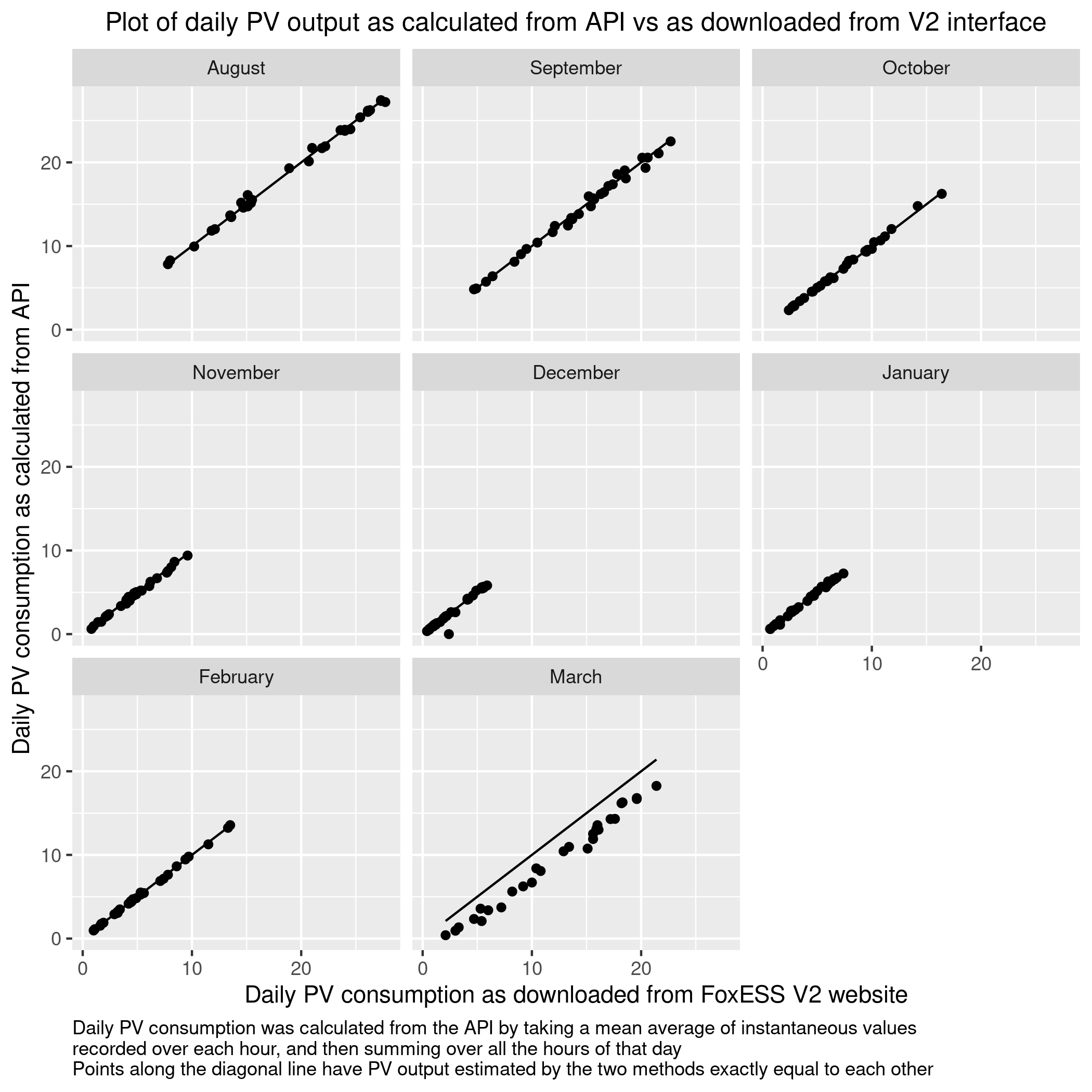

I think the problem is shown pretty clearly in the attached graph, in which the 2 sources of daily output data are plotted against each other by each month since last August. You can see that the values agree very closely indeed in every month except March (apart from just 1 day in December when something weird seems to have happened, but I'm not going to worry about a single day), and March is clearly different.

Thank you! That explanation fits perfectly with all the observations, so I'm sure that must be the correct answer.
I checked the volts and amps, and before the change, they matched up exactly with the reported power. Now they don't. Though the difference is more than the 80-100 W that you mention: I have 2 circuits (PV1 and PV2), and the difference is more like 150 W per circuit, so 300 W in total.
Not sure if that's just normal variation from one system to another or if I need to get my installer to check why my inverter is so power hungry?
I also noticed another change that happened at the same time, which all of a sudden makes sense. Previously, if I looked at the solar generation, flow to or from the battery, flow to or from the grid, and the house load, they didn't quite add up. I assumed that was something to do with the power the inverter itself was taking. Since the change, the figures add up perfectly. If the losses to the inverter are now taken into account in the reported power generation (and I agree it's not the most intuitive way to do it) then that completely explains why that behaviour changed.
