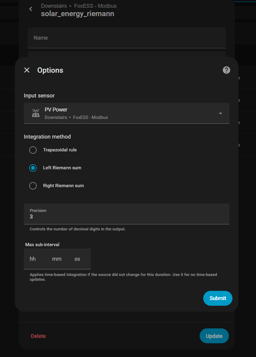

I have a Riemann integral which provided a more precise value for solar generation today, but ever since the firmware updated, it has been underreporting by about 10% compared to the 'solar generation' (total and today) sensor, and I think this is because sensor.pv_power is low.
The definition is here:

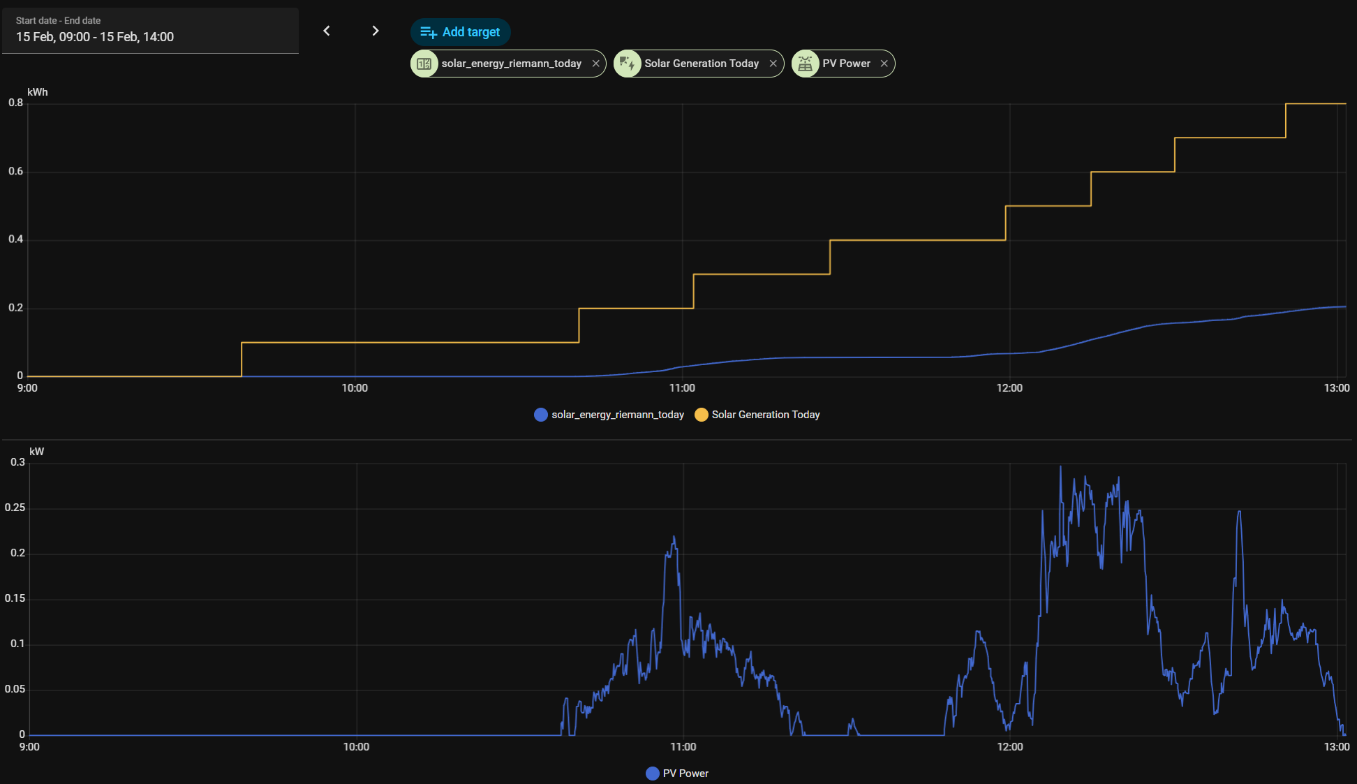

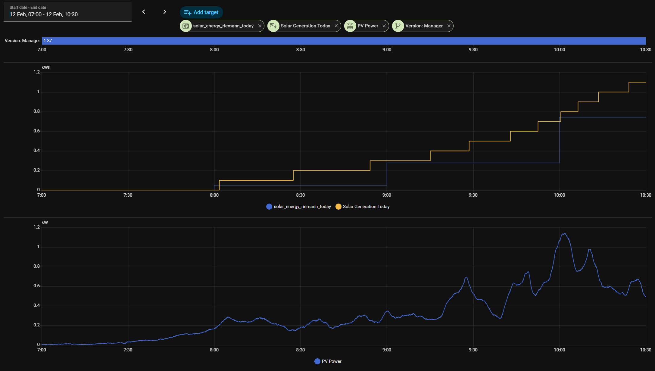

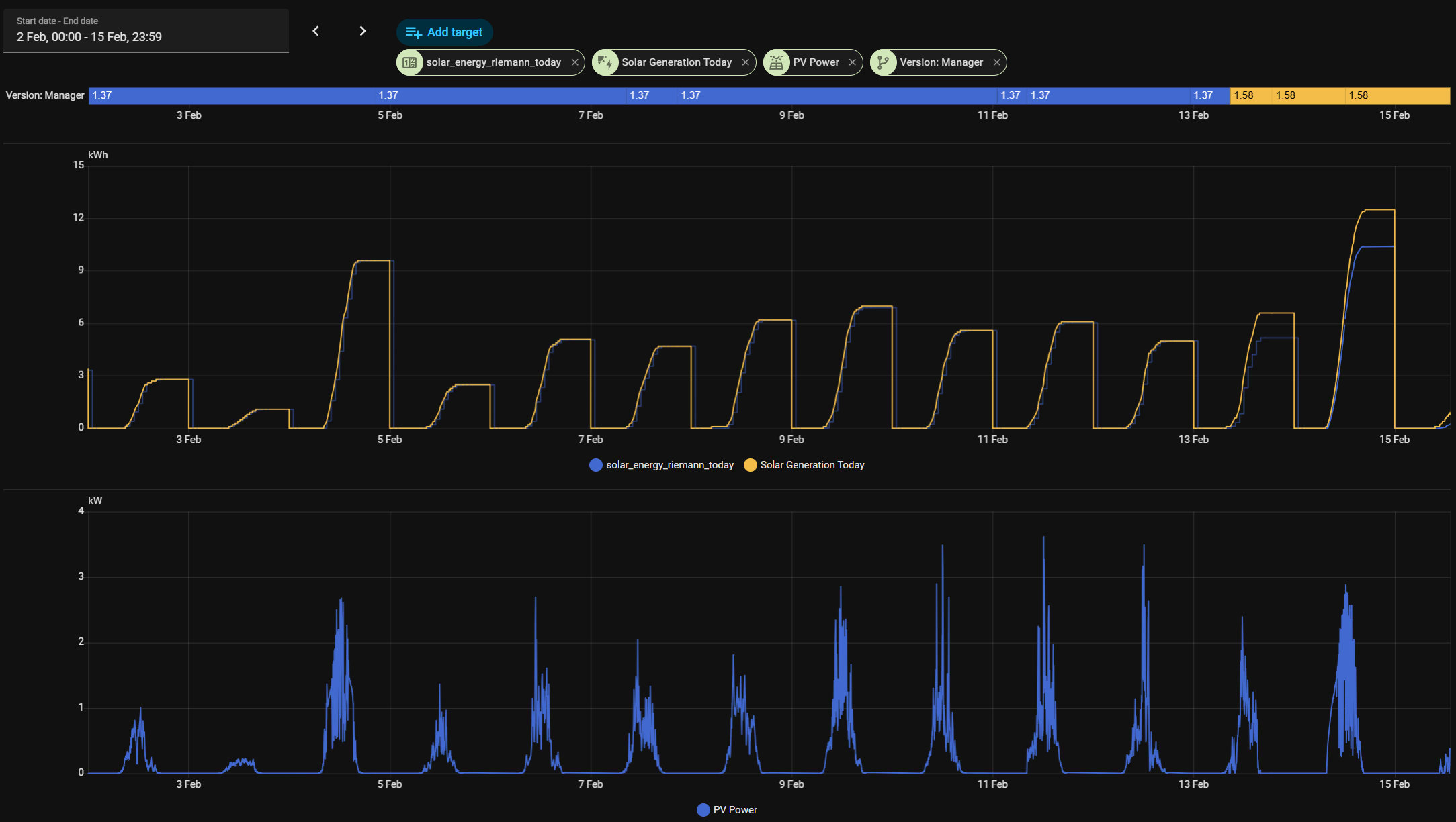

Here it shows before & after the update, note that the Riemann tracks the solar generation today sensor quite well prior to the update (although I do purge it into long-term-statistics after a day or two)

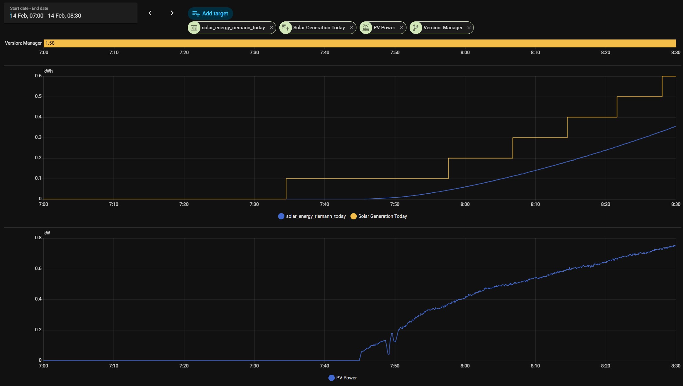

So in this example, note that pv_power is reporting zero, while the solar generation today sensor is already starting to increase.

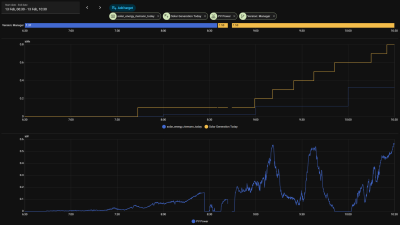

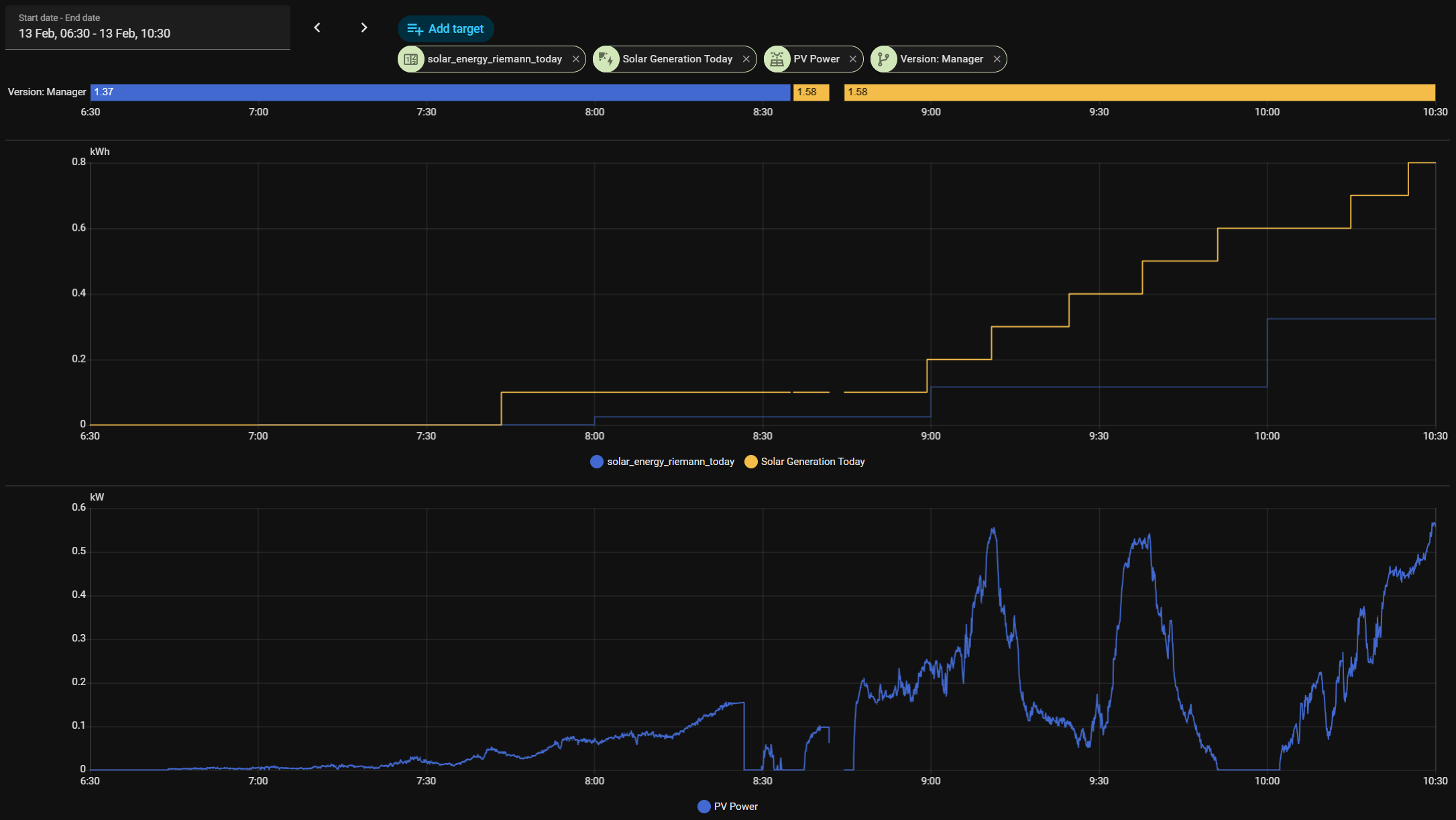

Another 'before'

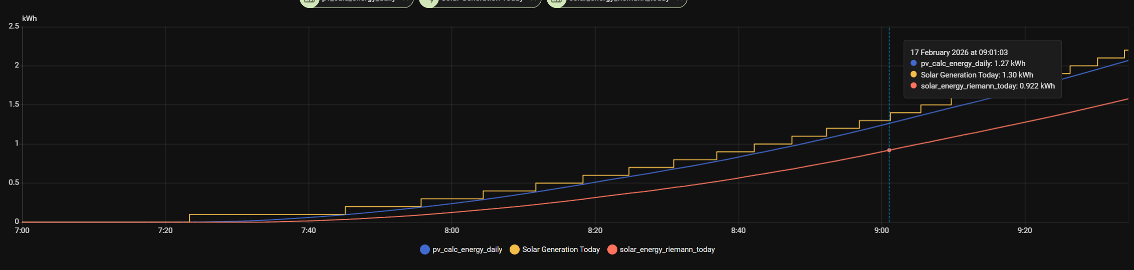

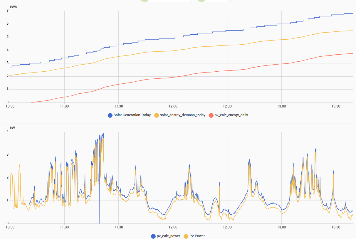

It looks like calculating power from sum(voltage*current) gives about 80w higher than the pv_power sensor. As far as I can see, calculating it from voltage*current results in the same energy figure as from the Solar Generation Today sensor, while the Riemann sum directly on the inverter power sensors gives a significantly lower reading.

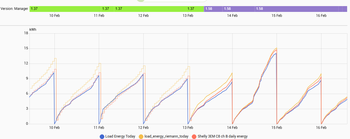

I wonder if they have moved the parasitic load overhead of the system from the load sensor to the pv sensors. I had noticed something similar with the load power vs the load energy sensors on the old firmware, where the Riemann sum on load power gave a different result to the load energy sensor.
For Load Energy, the Riemann is closer after the update than before.

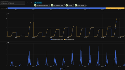

Here is the Solar Generation Today sensor (yellow), versus the Riemann sensor on sensor.pv_power (red), versus a Riemann sensor on sum(volts*amps, blue)
