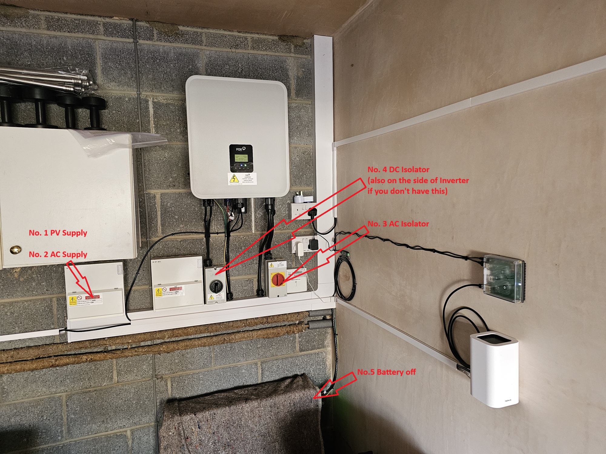

You should give this a go yourself, and if it does not work then you can call someone in (better would be forum!)
Just wait for when you have cooked, and you don't need the power.
5. Battery off
Wait for your Inverter screen to go blank.

The settings will be saved, do not worry about that being lost.

Battery tip, mine is an EP11, and you will find a silver power button on the side where the wires enter. As yours are different, they should have a similar on/off button I suspect.
