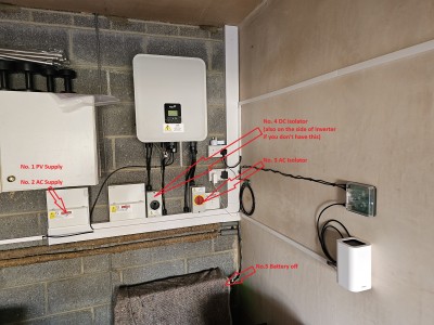

You should give this a go yourself, and if it does not work then you can call someone in (better would be forum!)
Just wait for when you have cooked, and you don't need the power.
5. Battery off
Wait for your Inverter screen to go blank.
5. Battery off

The settings will be saved, do not worry about that being lost.
Thank you , really helpful. Will go into battle tomorrow as totally had enough of it tonight.
My batteries are in a stack Its covered by a big box for insulation . I might just some pics of everything and send them your way if you don't mind before attempting it.
