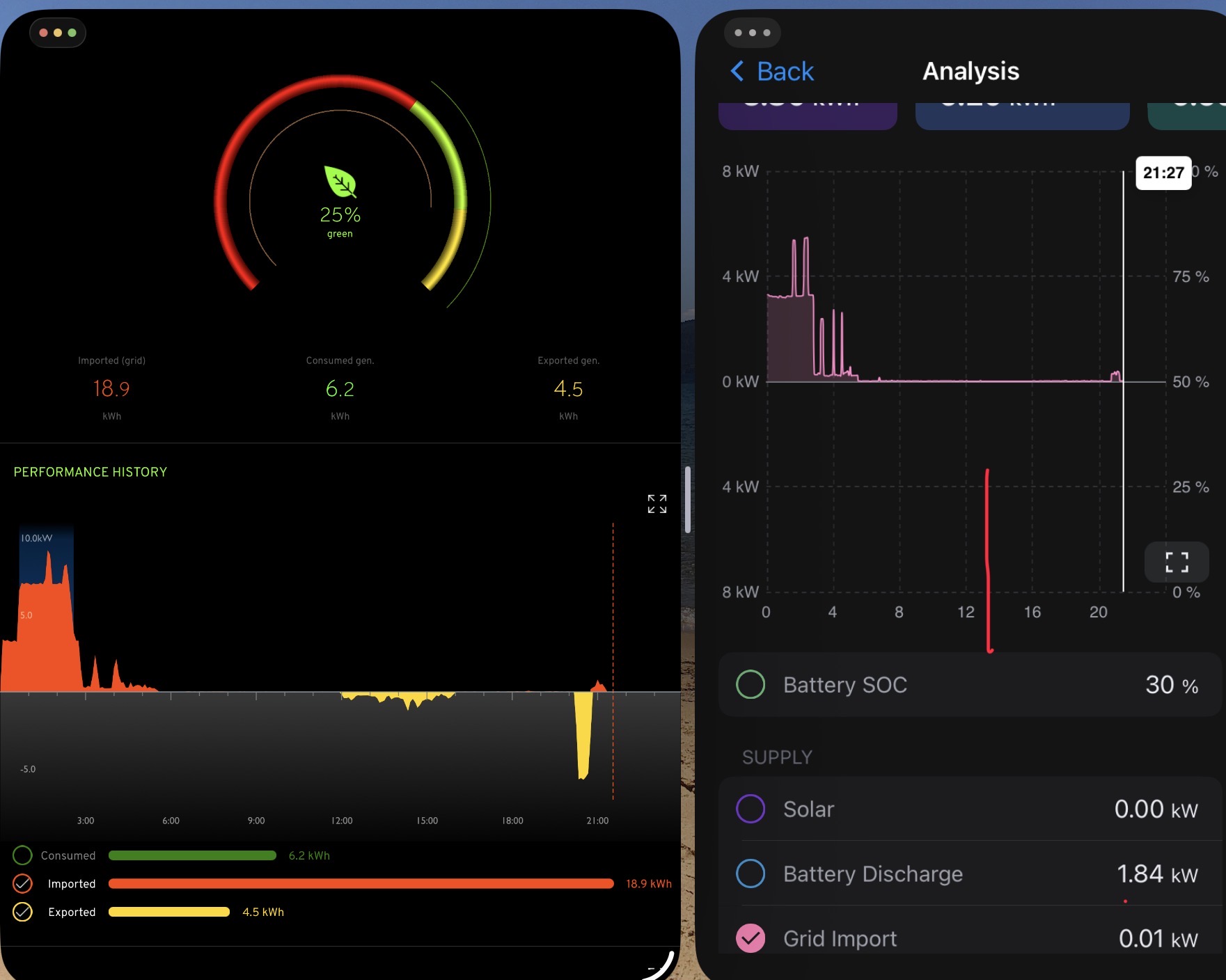

I’ve now noticed a pattern each day after FD.
The system now discharges to set FDSOC, then draws from grid for approx 10mins before falling back to self use on the battery.
The image shows this behaviour as logged on the myenergi app and the Fox app, it’s just clearer on the myenergi app.
It’s happened 4 nights running when the battery has hit the set FDSOC of 30%.
So there’s some work for Fox to do to get the system running as it should be.
