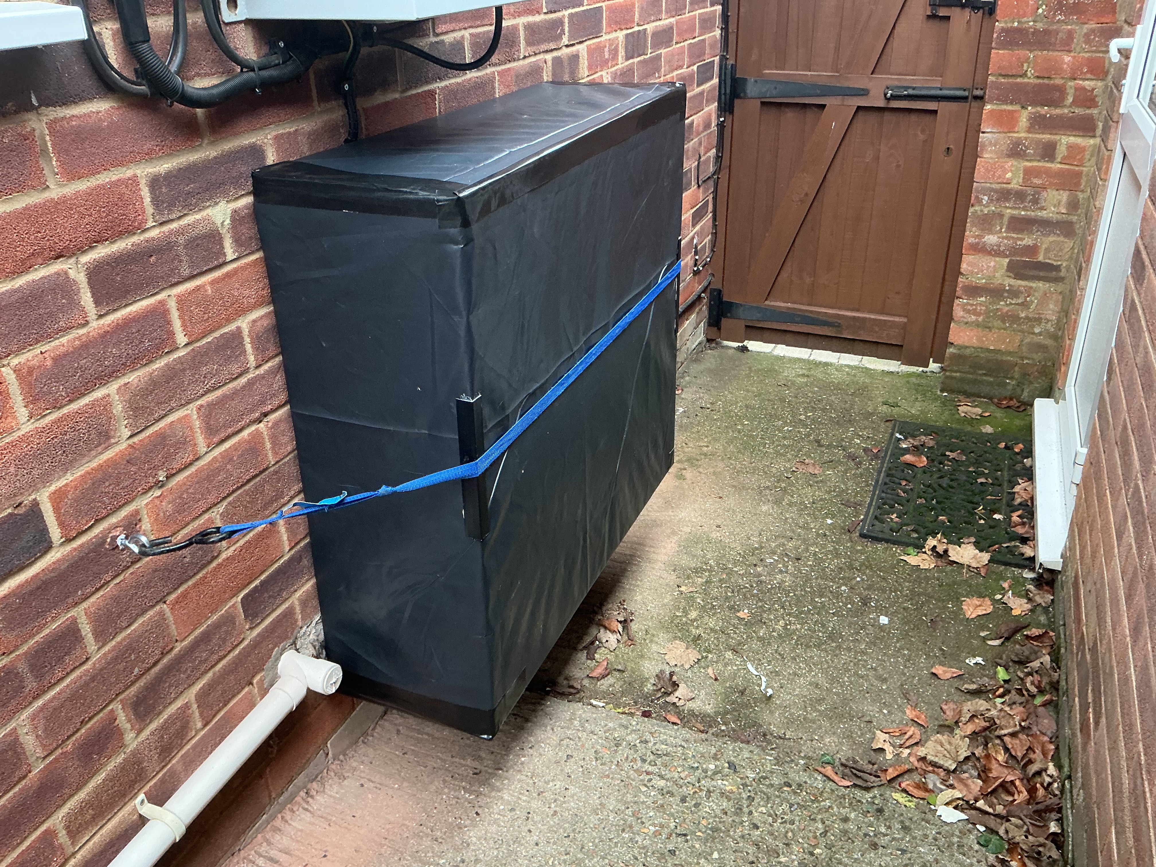

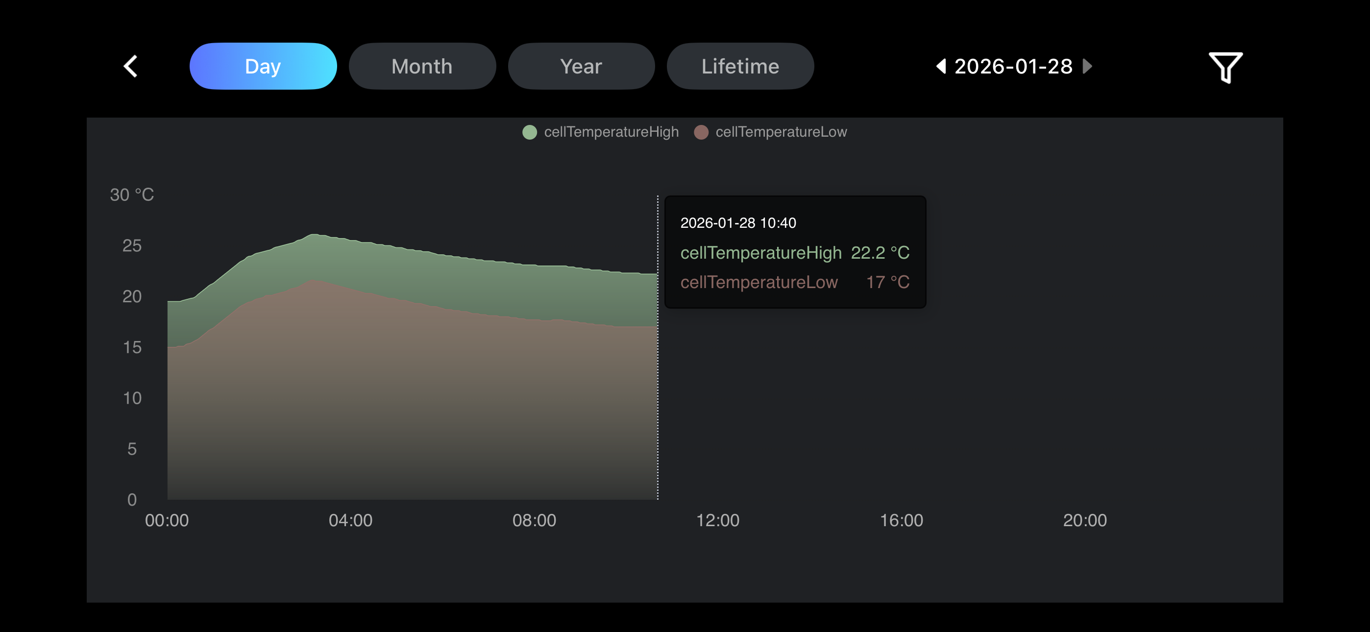

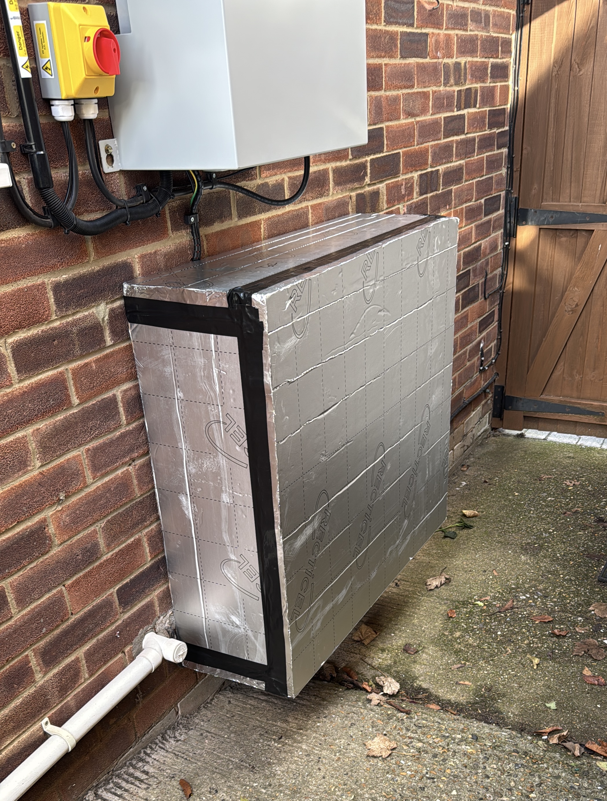

Just to add, having an heated EP11 outside, once I built a 50mm insulated box around it, the lowest cell temp has never dropped below 10C, and the heater has not had to kick in.
My friend with the same battery but having the heater issues, where its stops working when the heater tries to kick in, got me to help him build a 50mm box 2 weeks ago, and for the first time this winter has a working battery 24/7 and that’s with battery heating disabled until Fox roll out a fix fully.
So conclusion is, insulated box is all you need, even outside.
Thanks for that. It's reassuring to know.CDubbs wrote: ↑Tue Jan 27, 2026 6:06 pm Just to add, having an heated EP11 outside, once I built a 50mm insulated box around it, the lowest cell temp has never dropped below 10C, and the heater has not had to kick in.
Is there any chance that you could post a picture of your insulated box? It's something that I may just do anyway - especially if there are any more shenanigans!

This cover is over a metal cover I had made for the battery, so it’s bigger than the one I made for my friend, that one went straight over the battery.
Picture before and after waterproof membrane attached.

To help others that might be looking to do the same as you/similar, what sort of temperatures was you seeing in the past compared to now? As you may know, mine is inside the garage with a blanket over it, and has not done a single heating cycle for around 3 weeks, and after last night it is at 12.5°C.
Many thanks for posting the pics. That's a big help.CDubbs wrote: ↑Tue Jan 27, 2026 10:25 pm This cover is over a metal cover I had made for the battery, so it’s bigger than the one I made for my friend, that one went straight over the battery.

I was dipping into the single digits
So battery heater was kicking in at 9 and going 15
Now never gets that low, so heater not kicking in
Currently outside temp 2C lowest cell is 17
Pic of current overnight temps from midnight and current max/min cell temps
On warmer nights recently have seen max cell temp at 25 in the morning 6 hours after grid charge has stopped

Perfect!CDubbs wrote: ↑Wed Jan 28, 2026 10:46 am I was dipping into the single digits
That will be really helpful for those needing to know if it is worth doing.
Also, being above 20°C, the charge and discharge rates are 100% max, handy if you did need a full draw on your system.
