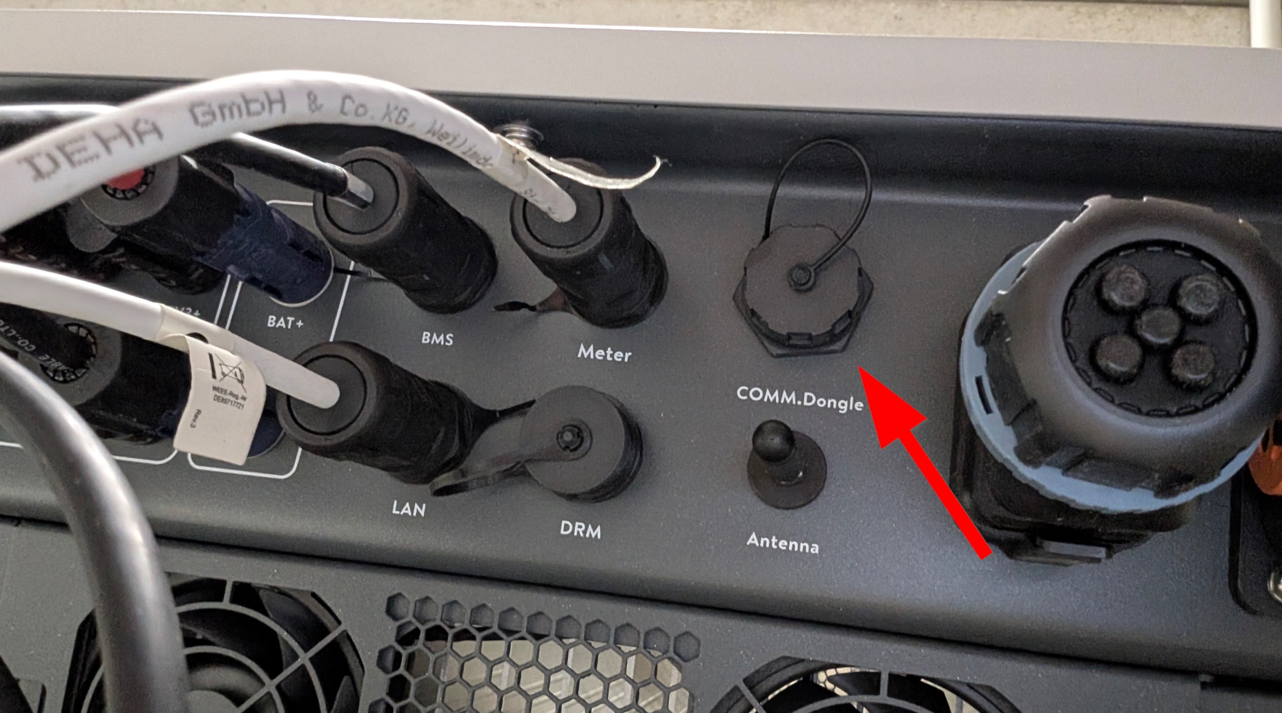

You mean this one?
Re: H3-12.0-Smart Modbus Connection
No that's where the datalogger plugs in and Fox have un-helpfully labelled it the COMM/Dongle port

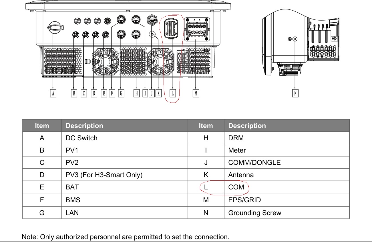

This is the COM port

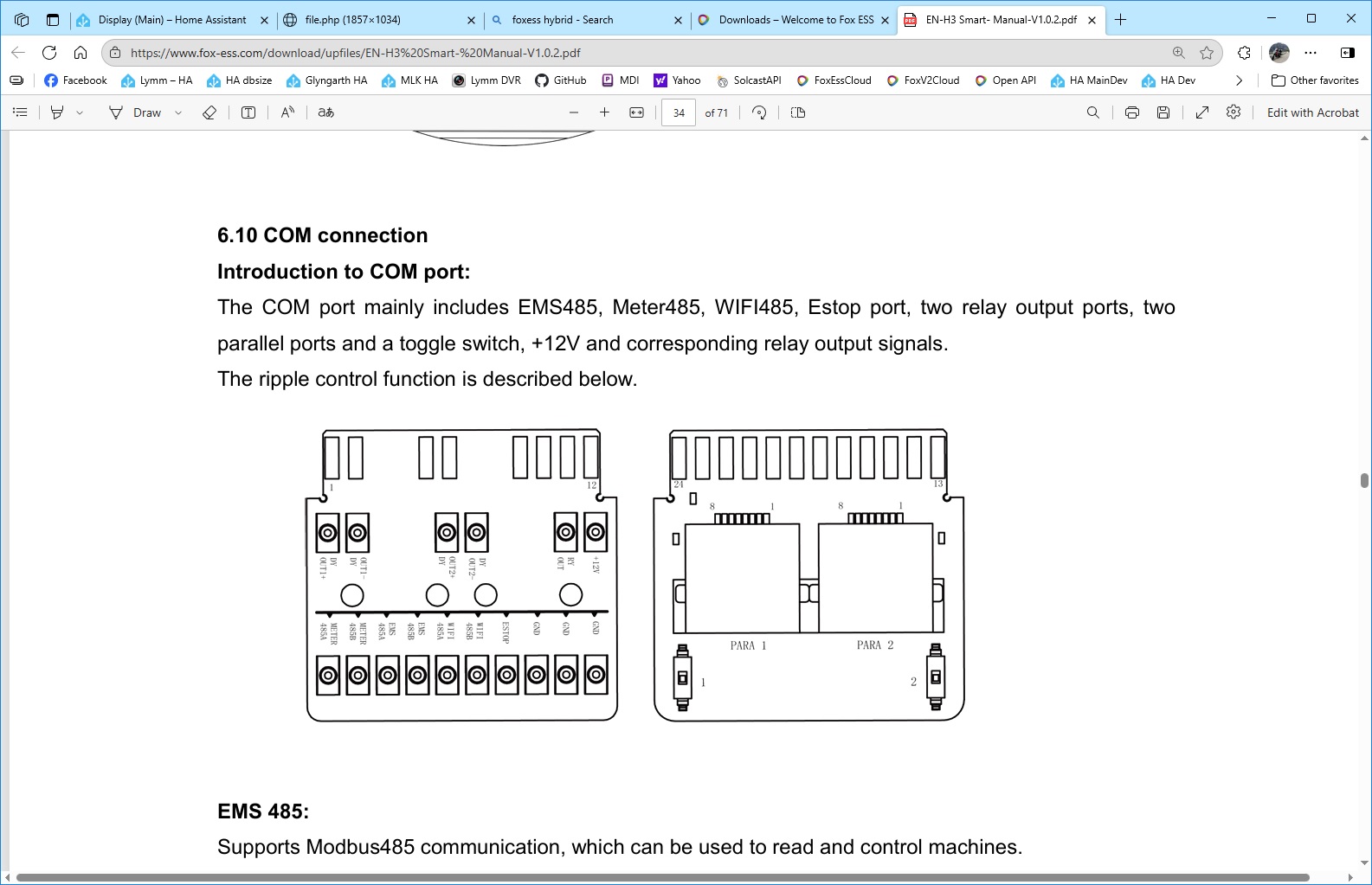

And these are the pin outs for it.

I would like to ask you about the wiring of the COM connection. I am looking at the COM port at the inverter and I see 24Pins (as mentioned in the manual for the H3-12.0 Smart). I am confused by where to connect any wires for the 485A and 485B since in the manual under 6.10 are only 16 slots shown and named. Is it possible that there should be a plug for the COM port that has a different pinout then the COM port directly at the inverter through which I need to connect the Elfin wires?

If you are connecting by RS485 by modbus, you need to wire to the EMS485A/B pins
But with the H3 Smart you can connect directly to it without a modbus device as it has a built in modbus server on the wifi logger, try connecting to the inverters IP address using the integrations direct LAN mode.
