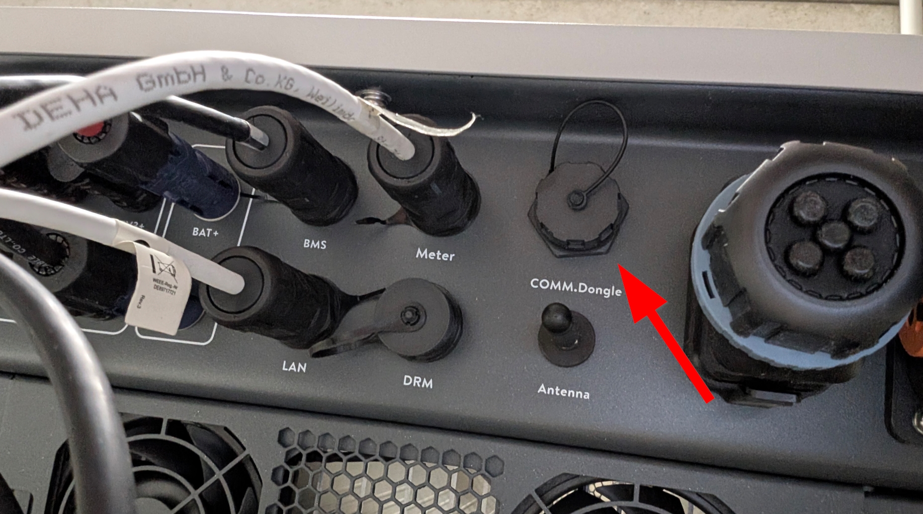

You mean this one?
Re: H3-12.0-Smart Modbus Connection
No that's where the datalogger plugs in and Fox have un-helpfully labelled it the COMM/Dongle port
This is the COM port
And these are the pin outs for it.
