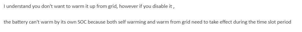

I am honestly losing the will with Fox, their latest comment seems to go against the video Will posted only a month ago .. https://www.youtube.com/@iameccles/videos ... where he states that the battery can heat from itself if above 40%
Fox are saying ... that it is "only" possible if you also have the "warm from grid" enabled .. then it can do "what it wants" .. either from battery or grid ..... At peak electricity time, I do not want to pull from grid

albie999 wrote: Thu Jan 15, 2026 7:16 am I am honestly losing the will with Fox, their latest comment seems to go against the video Will posted only a month ago .. https://www.youtube.com/@iameccles/videos ... where he states that the battery can heat from itself if above 40%

I have seen it many times pull PV power to warm up... but NEVER seen it work on a dull day, so the self-consumption to heat has never worked for me, and this is when SoC is always above 90%.
So it can use PV outside of the grid window, but the self-consumption is broken on 1.009 and 1.011
