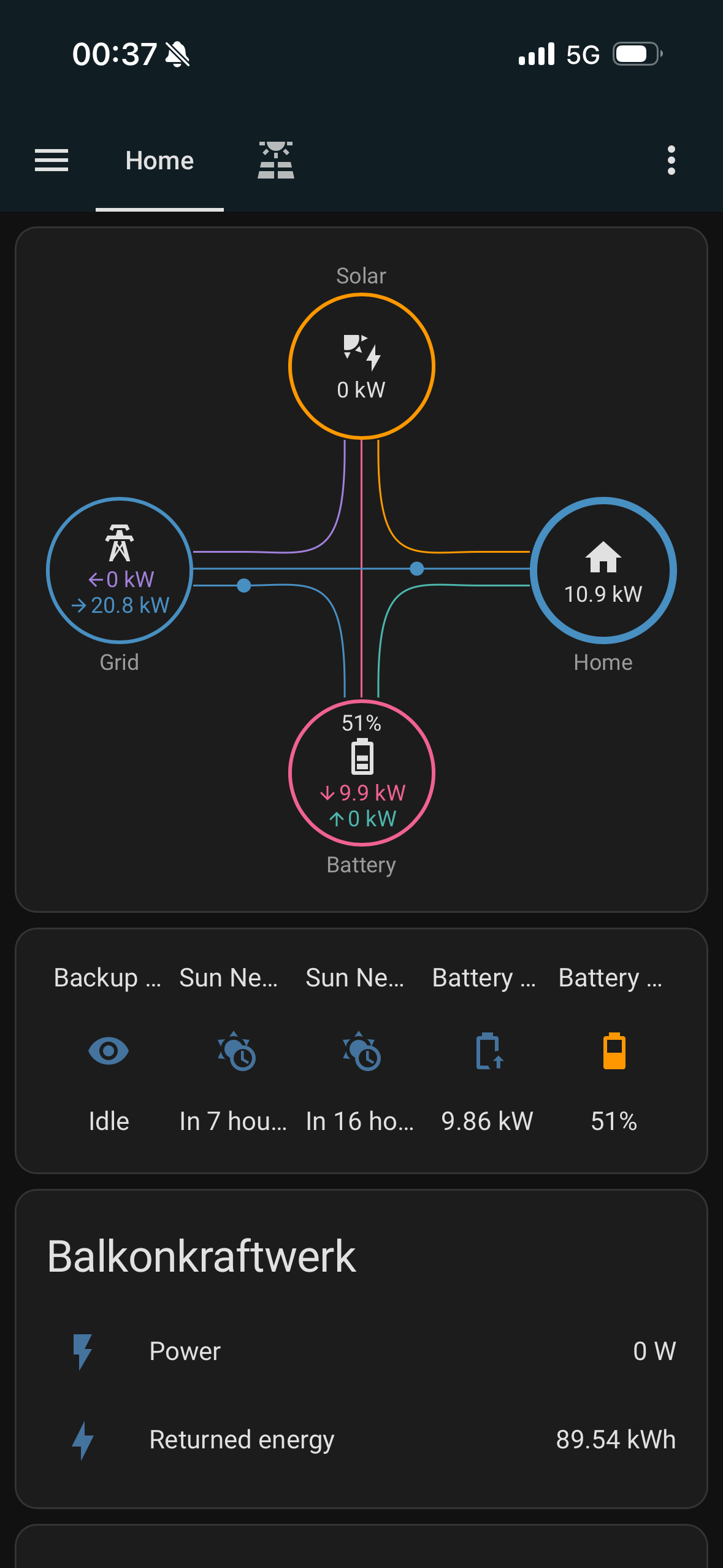

I'm trying to charge my battery (mode scheduler) and my car at night. I mentioned that when the cars charges(11kw), the battery will not charge. I tried several setups What I found out was. The battery only charges if the load is under 11kw. So lets say, if I set the car to charge with 7kW, the battery was charging with almost 3 kW. When I raise the charging power of the car, the battery charge drops. When I stop the charging of the car. The inverter starts to charge the battery with 9-10kW. What ever i set, the load sticks at 11kW.
For me It seems there is a "hidden" settings in my inverter. On the panel I already set the MaxImportCurrent to 50A. But nothing changed. There is no "MaxImportPwr" on the panel. I phoned the FoxESS Hotline but they could not help me, because they could not find a setting wich would fix the behaviour.
