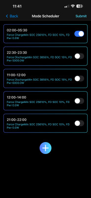

I've been happily using the Mode Scheduler function in the Fox mobile app to force charge/discharge whenever my energy provider gives an hour or two of free electricity, until today.
When I went to set and turn on the schedules, I noticed that the app had some strange values in the Minimum SOC field (3855%) and also wouldn't allow me to alter, add or delete any of the existing schedules.
Has anyone else experienced this, or knows how I can resolve the issue? I'm at a loss!

I had recent weird errors with scheduler changing values, seems a weird bug occurring between my Android phone and my son's Apple.
viewtopic.php?t=2363
Might not be related to this at all, but could apply.
Given the values are somewhat stupid, I would restart system.
Then see if the values are sensible range, 10%-100%
You may also need to have the firmware updated, and probably not a bad idea.
A few people have complained about this today, some were able to change the values back to sensible numbers, some couldn’t - but i’m hearing that it may have been sorted by Fox in the cloud, can you confirm ?

I submitted a support ticket and happy to report that Fox were super quick and have sorted the issue now.
Thanks for the replies.
