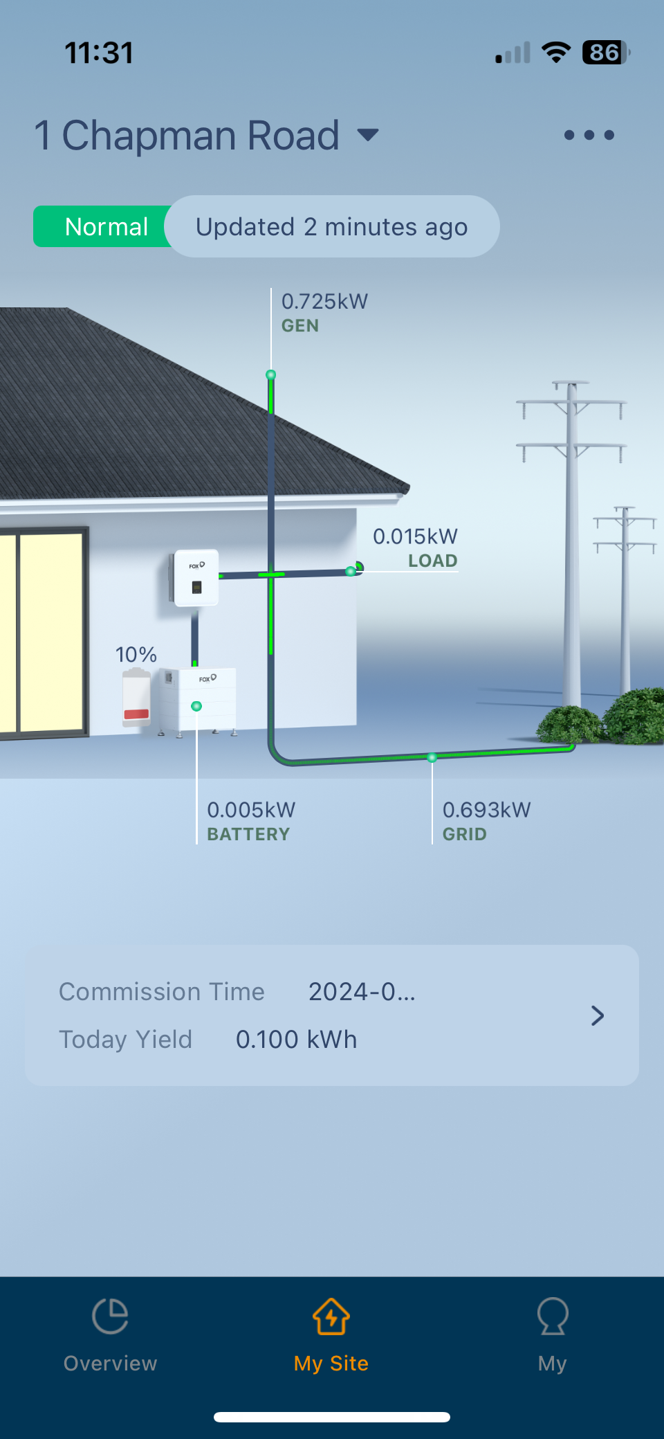

Hi All, please can someone help me. I have a fox battery system connecting to x9 solar panels. The thing is sometimes the system exports to the grid even when the batteries are not full. Is there a way to stop exporting to the grid?
For example currently the batteries only have 10% and it’s exporting to the grid. Please help.

Hi Dave,
Thankyou so much for the help. A little background on my situation. I brought a house that already had 9 solar panels and an inverter that only exported back to the grid.
I then saved really hard and got the 9.5kWh Fox Ess battery system and it was connected to my solar panels.
The mode is set on ‘Self Use’ and what tends to happen is that the very rarely the battery charges above 15% and most often it seems like it’s feeding back to the grid instead of charging the battery up.
The way I would like to have the system is to only export to the grid when the battery reaches 100% full. This does not seem to happen and instead what I get is the battery feeding the load and then feeding back to the grid.
Do you think I should stop the system from exporting to the grid all together? Is this a safe thing to do?

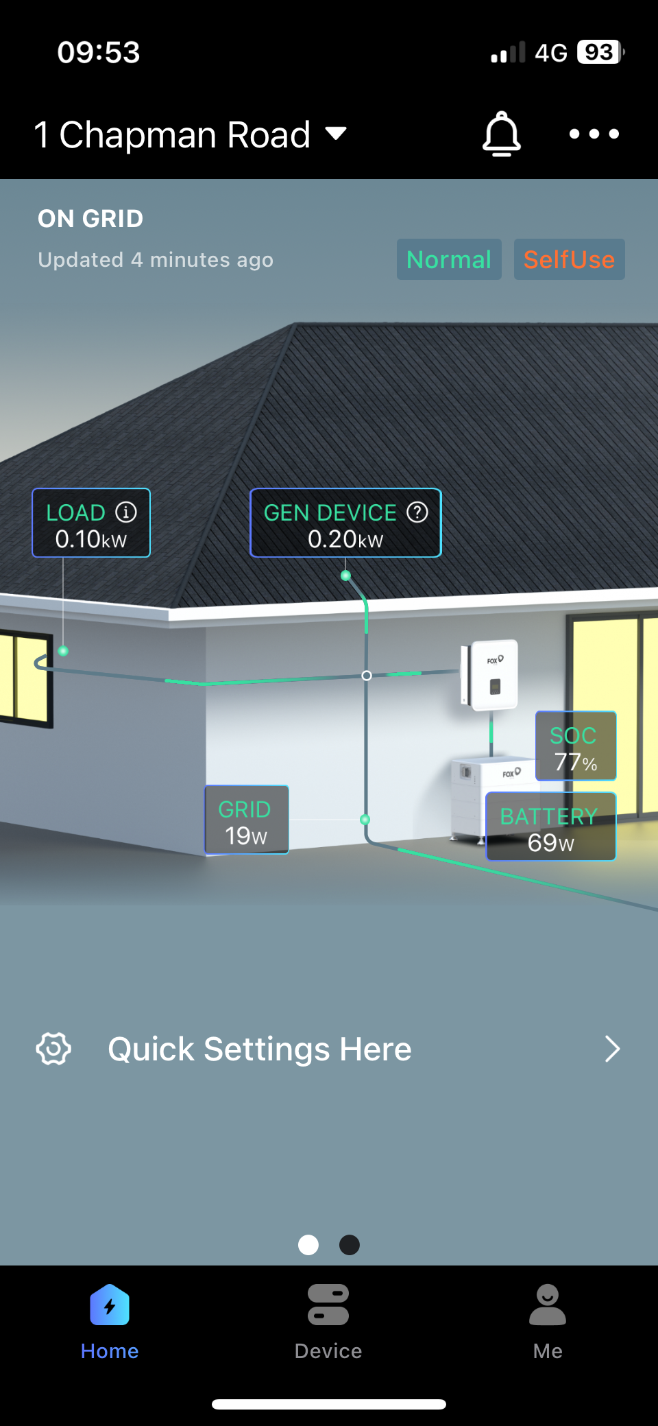

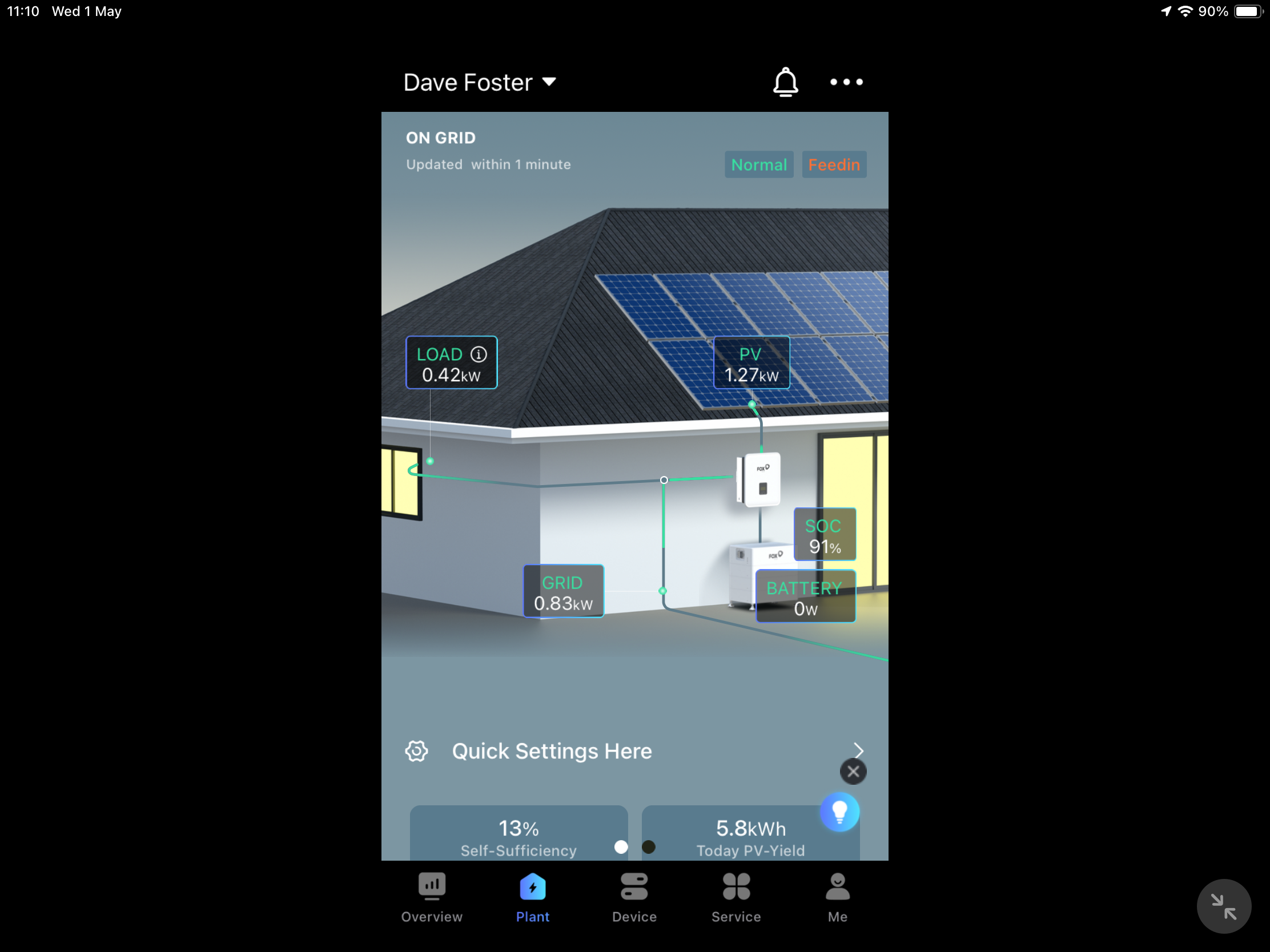

Can you post a picture of the power/energy flow from your app, the one that shows how much power is going where.
It looks like this
It looks like this
Hi Dave
Here is a current photo, many thanks
All grid tied systems will pull a small load from the grid in order to confirm it's still connected - if they can no longer draw that power, they shut down to avoid energising the grid and potentially electrocuting anyone working on the power lines.
At the same time, your inverter is constantly balancing how much power it's converting to AC from the DC power that comes from the batteries and panels, or if you have enough generation, how much of the DC from the panels goes to the batteries, vs going to loads or the grid.
If you turn on a large load, there is a split second before the inverter adjusts where power will be pulled in from the grid. Similarly, if you turn off a large load (eg when the kettle has boiled or the toaster pops up), the inverter continues to produce more AC than it needs to for a split second.
The data on the app is not real time - it's a snapshot of an instant taken at 5 minute intervals. This is enough to show the overall amount of power used, generated or exported, but it doesn't show the fine detail of the adjustments the inverter is making. If the snapshot coincided with the 200ms where the inverter was exporting 700W to the grid, you'll see that for 5 minutes until the next snapshot, and this can be misleading.
I log the grid power (coming or going) at 5 second intervals via HA on my H1 and it basically fluctuates +/- 20W, unless there is some large load going on or off.
