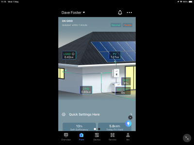

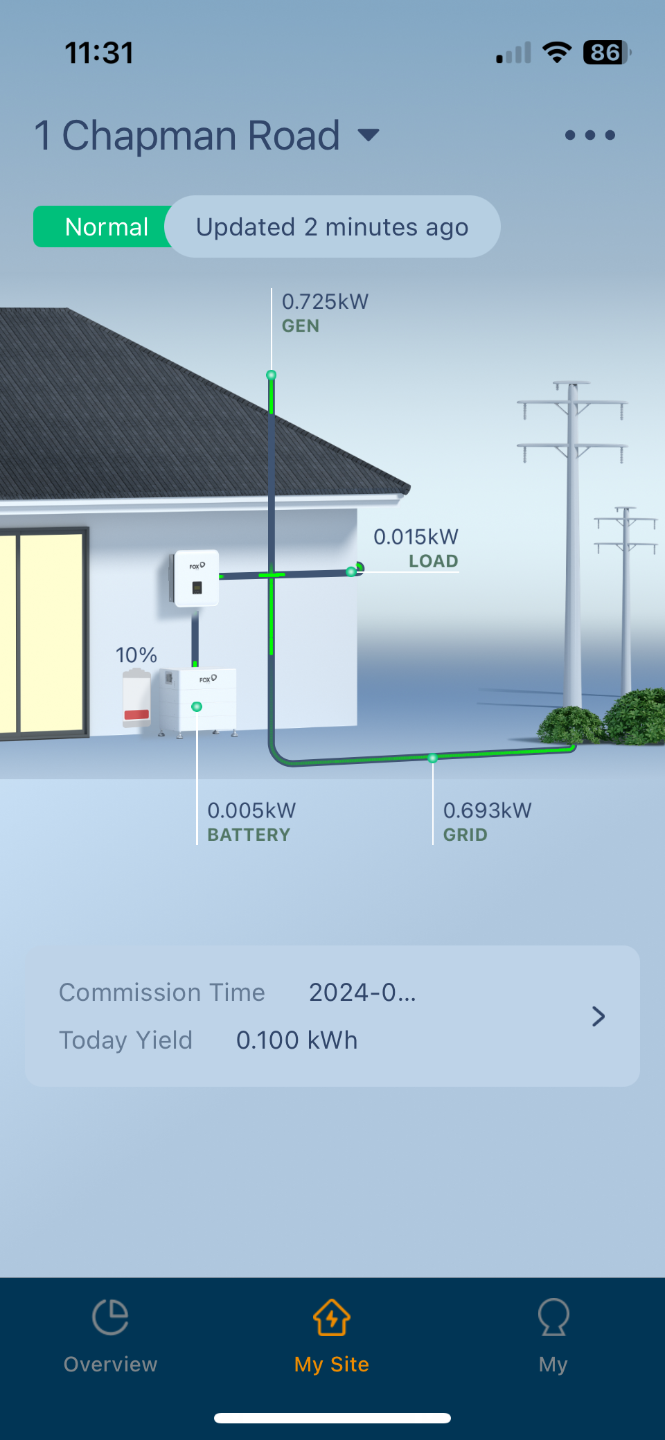

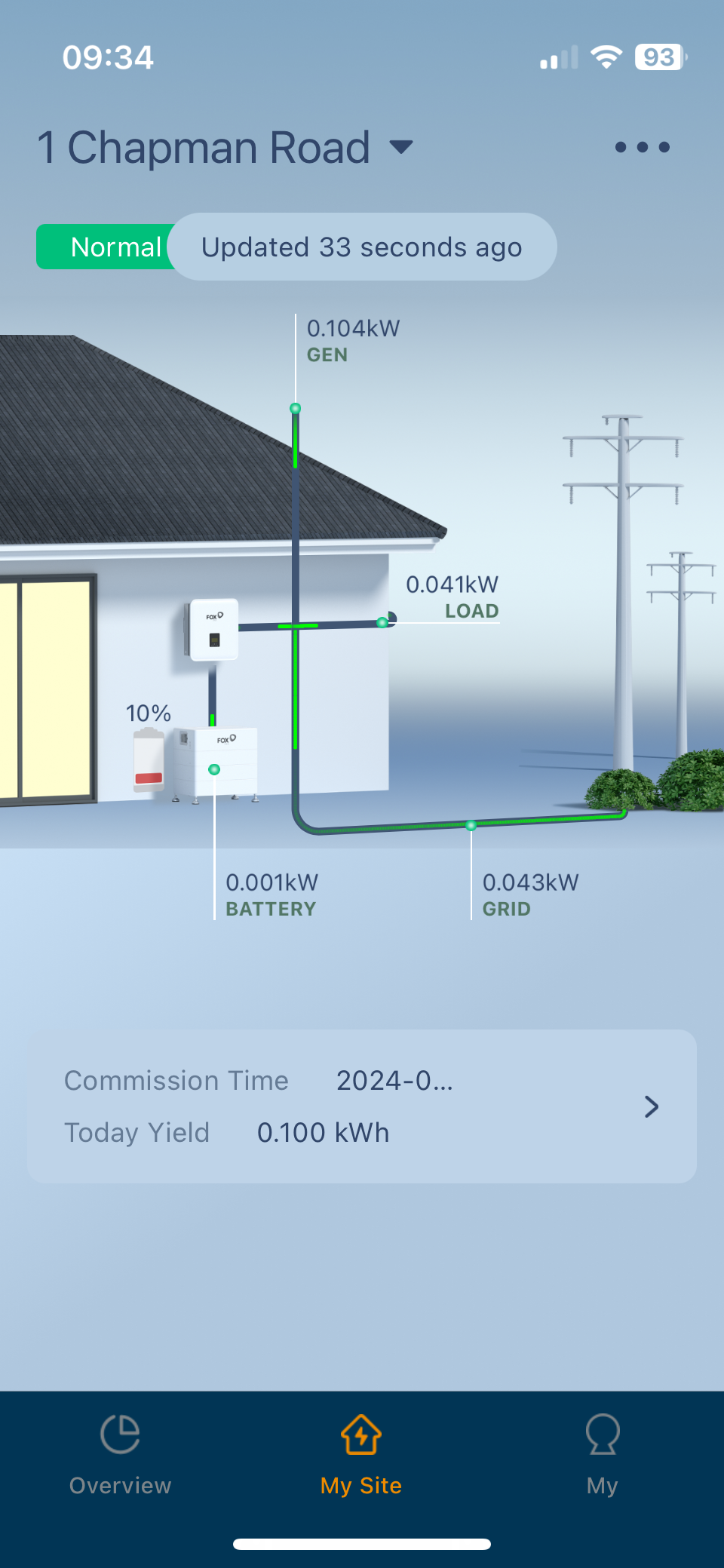

- Posts: 1786
Can you post a picture of the power/energy flow from your app, the one that shows how much power is going where.
It looks like this
It looks like this
All grid tied systems will pull a small load from the grid in order to confirm it's still connected - if they can no longer draw that power, they shut down to avoid energising the grid and potentially electrocuting anyone working on the power lines.
At the same time, your inverter is constantly balancing how much power it's converting to AC from the DC power that comes from the batteries and panels, or if you have enough generation, how much of the DC from the panels goes to the batteries, vs going to loads or the grid.
If you turn on a large load, there is a split second before the inverter adjusts where power will be pulled in from the grid. Similarly, if you turn off a large load (eg when the kettle has boiled or the toaster pops up), the inverter continues to produce more AC than it needs to for a split second.
The data on the app is not real time - it's a snapshot of an instant taken at 5 minute intervals. This is enough to show the overall amount of power used, generated or exported, but it doesn't show the fine detail of the adjustments the inverter is making. If the snapshot coincided with the 200ms where the inverter was exporting 700W to the grid, you'll see that for 5 minutes until the next snapshot, and this can be misleading.
I log the grid power (coming or going) at 5 second intervals via HA on my H1 and it basically fluctuates +/- 20W, unless there is some large load going on or off.

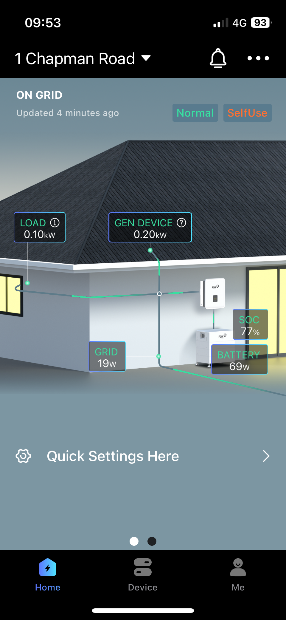

I have a very similar issue so I have not generated a new post.
I have an installation which was installed about lunchtime today. Initially the batteries were about 50% and it is a nice day so they received from the grid until about 1 hour ago, when I set up the timers using the old v1 app because the v2 app will not allow me to set up the timers.
Now I am exporting to the grid and the battery is discharging at a small rate 54w the charge going out to the grid is currently .75kw but was 1.5kw on the previous refresh (5 mins ago)
Work mode is self use, mode selector is disabled, BRC and System min SOC are both 10%Charge time has two time jones which reflect my overnight cheap rate
23:31 - 5:30 charge from grid enabled and 5:31 to 23:30 charge from grid disabled.
I am using the latest version of the app v2 and I get """Perameter does not meet expectations""" when I click on the grid charge time settings screen - Whatever I enter in there gives that error.
I can only change the times in there if I use the older v1 app.
When I remove the time then the battery starts charging again as expected at this time of the day.
But I want the battery to charge to full overnight using my cheap rate electricity but as soon as I put times in the the battery stops charging from the PV system and I start exporting the generation again.

- Posts: 1786
I’m not quite sure I understand the charge going to the grid, if you are generating solar power and the battery is full the solar would then be exported.
I’ll start with the charge periods, if we get those set correctly we can then see if there are any problems.
Using the old app you should set the charge period from 23:30-05:30 with charge from grid switch on.
The second charge period you have set should be deleted, that’s instructing your battery to ‘not discharge’ between 05:31 and 23:30 - it should be set to 00:00-00:00.
The V2 app has a problem with wrap around midnight times if you want to set 23:30-05:30 on that you have to set charge period 1 to 23:30-00:00 and then charge period 2 00:00-05:30
If you get your charge periods set up correctly, what you should then be seeing is the battery covering the house load until it reaches 10%,.
If you are generating solar it should first cover the house load, then charge the battery, then export to the grid (when set to self-use).
