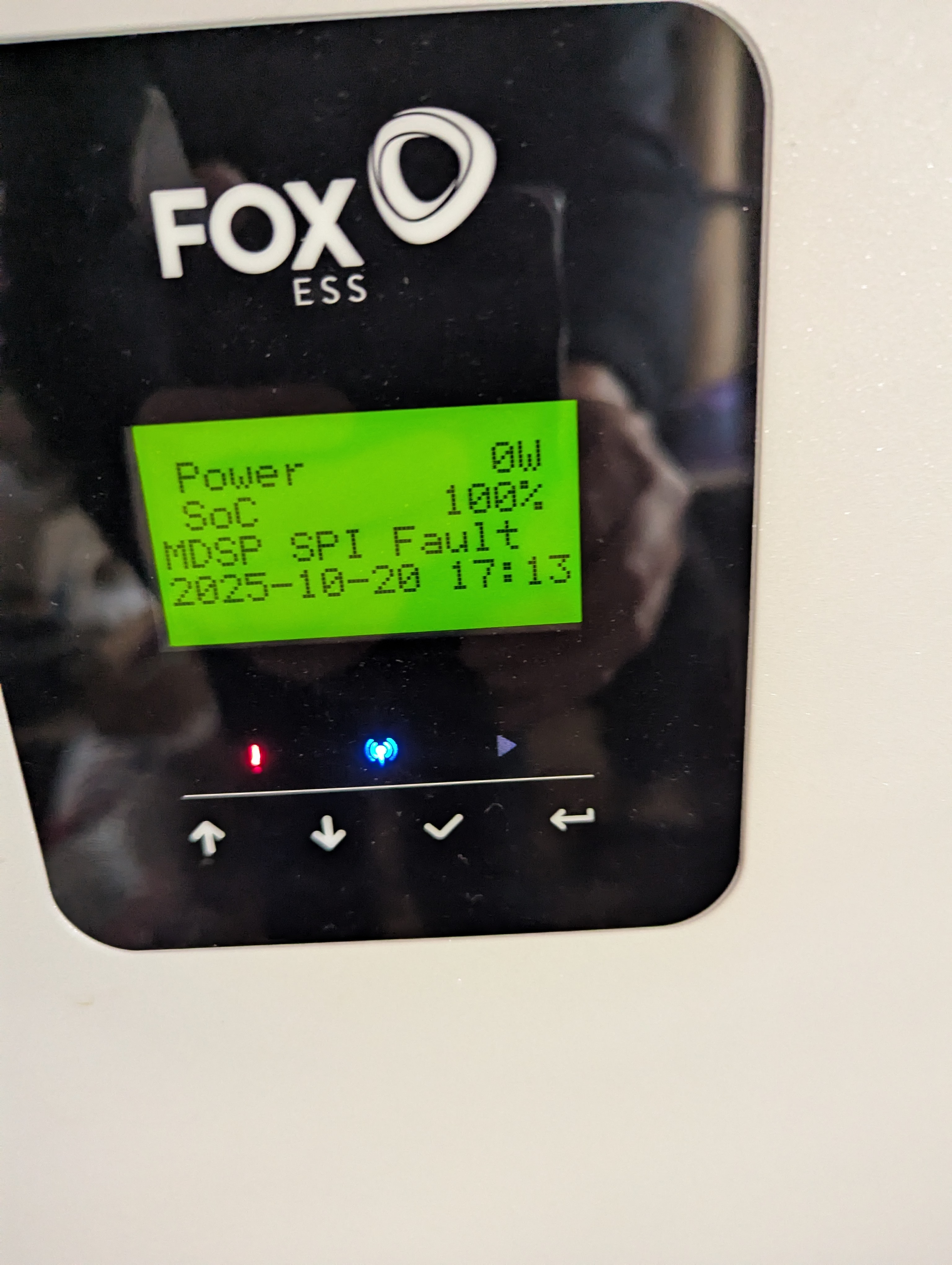

I was having issues with the data logger registers freezing when making updates to the Mode Scheduler. So contacted Fox support. They created a ticket said they will upgrade the inverter which was 3hrs ago and looks to have failed. At the moment the versions on the app are showing as:
Master : 1.50 Slave : 0.00 Manager : 1.51
I think elsewhere on this site that these versions are not compatible with UK hardware? viewtopic.php?t=1927
I have an error message on the display of MDSP SPI Fault I haven't had a reply on the ticket yet. Is there anything else I can do to fix this?
The slave firmware has failed and will need to be resent and installed remotely again by Fox or your installer.

Thanks Will, hopefully they will get back to me on the ticket.
Just a quick update. This was working again at 8:05am the next morning, with a notification from Fox Support, so all good. Hopefully the update will help with the mode scheduler update issues...
