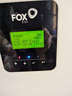

I was having issues with the data logger registers freezing when making updates to the Mode Scheduler. So contacted Fox support. They created a ticket said they will upgrade the inverter which was 3hrs ago and looks to have failed. At the moment the versions on the app are showing as:
Master : 1.50 Slave : 0.00 Manager : 1.51
I think elsewhere on this site that these versions are not compatible with UK hardware? viewtopic.php?t=1927
I have an error message on the display of MDSP SPI Fault I haven't had a reply on the ticket yet. Is there anything else I can do to fix this?
Re: KH8 Inverter Firmware update seems to have failed :?
The slave firmware has failed and will need to be resent and installed remotely again by Fox or your installer.

Just a quick update. This was working again at 8:05am the next morning, with a notification from Fox Support, so all good. Hopefully the update will help with the mode scheduler update issues...
