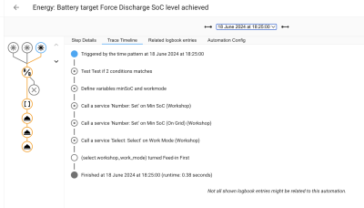

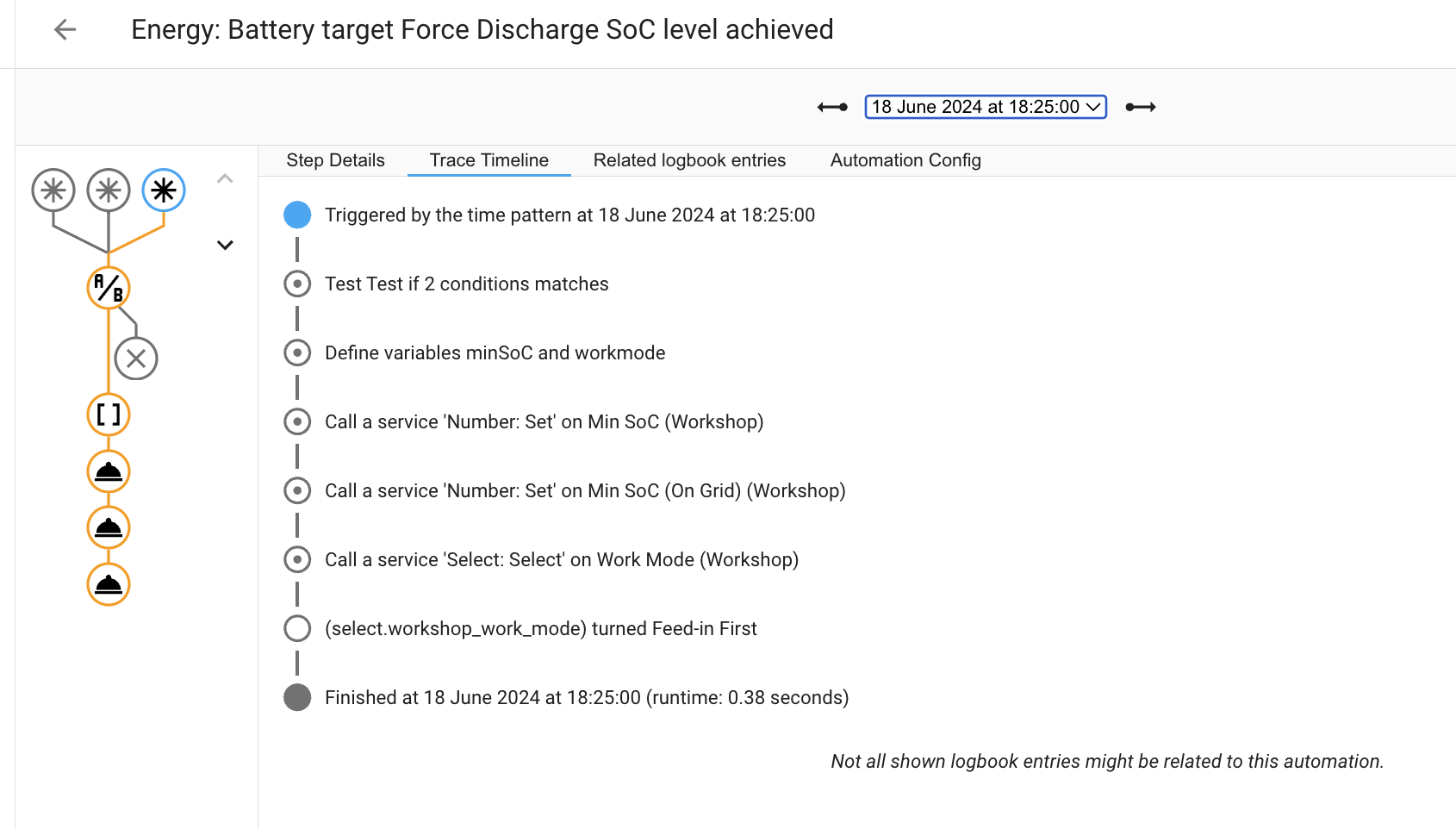

The polling every 5 minutes against a condition works a treat, great idea! :idea: I don't think the trigger was firing at all on the state...
If it helps anyone else trying to achieve similar this is what I've gone with
Note: tweak vars with entity "workshop" and introduce input_number.min_soc_peak and input_number.min_soc_day similar to max SoC automation
Code: Select all
alias: "Energy: Battery target Force Discharge SoC level achieved"
description: >-
  Sets the Min SoC to lower 'day time' level and work mode back to Feed-In First
  - it 'polls' every 5 minutes during the 16th, 17th & 18th hours to check
  condition
trigger:
  - platform: time_pattern
    hours: 16
    minutes: /5
    hours: 17
    minutes: /5
    hours: 18
    minutes: /5
condition:
  - and:
      - condition: template
        value_template: "{{ states('select.workshop_work_mode') == 'Force Discharge' }}"
        value_template: >-
          {{ states('sensor.workshop_battery_soc')|float(0) <=
          states('input_number.min_soc_peak')|float(0) }}
action:
  - variables:
      minSoC: "{{ float(states('input_number.min_soc_day')) }}"
      workmode: Feed-in First
  - service: number.set_value
    target:
      entity_id: number.workshop_min_soc
    data:
      value: "{{ minSoC }}"
    target:
      entity_id: number.workshop_min_soc_on_grid
    data:
  - service: select.select_option
    target:
      entity_id: select.workshop_work_mode
    data:
      option: "{{ workmode }}"
mode: single
cheers
Marcus
