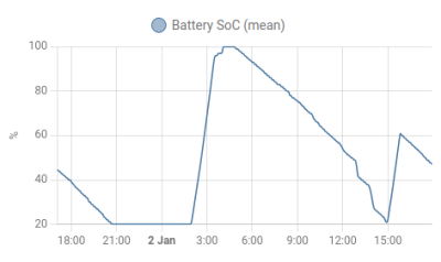

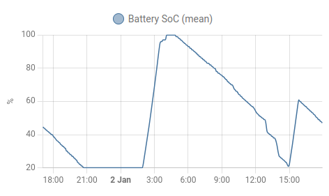

During 2am - 5am I want to top up to 100% at the cheapest rate.
If there's not been much generation through the day and the battery is low, I want to top up at the day rate before the more expensive peak rate cuts in between 4pm and 7pm, not to 100%, but enough to avoid grid consumption at the highest rate.

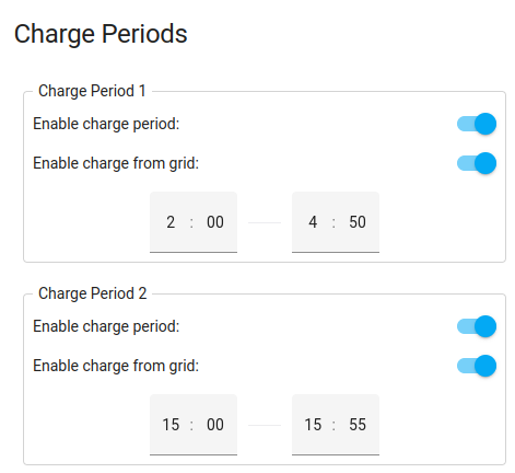

Before automation & Modbus I played with different "charge 2" settings on the Cloud/App, experimenting with different durations around a window before 4pm, but obviously this was all in an attempt to get to a level which is what I've now done. i.e.

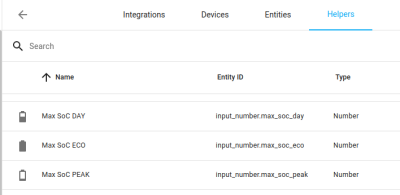

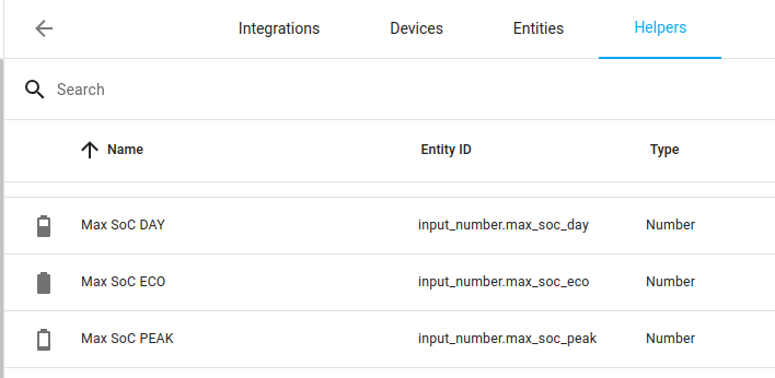

Created 3x helpers for the levels -
  • input_number.max_soc_eco
  • input_number.max_soc_day
  • input_number.max_soc_peak

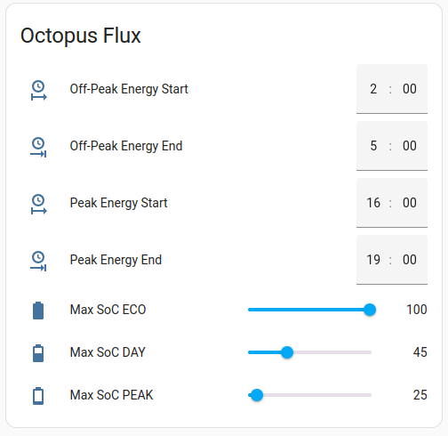

Added them to a card on the dash so they can be set easily, (I can imagine during summer you'd reduce even ECO right down depending on needs)
