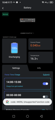

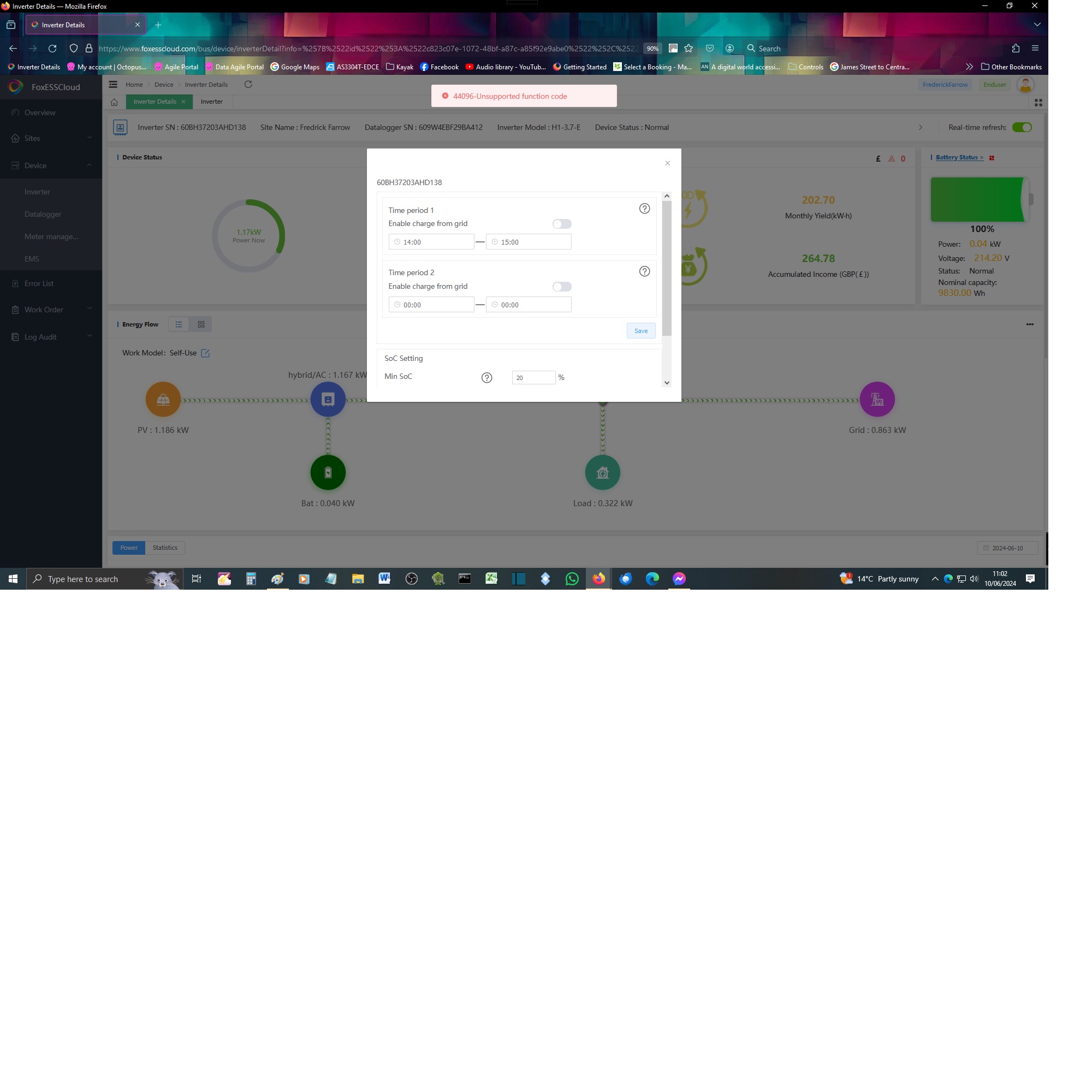

I have a H1-3.7-E inverter and as from last night I have been unable to alter the Force Charge settings on my Fox by the Android version 2 app, the web pages and even via the on unit keypad. Has anyone else had this problem?
I get Error Code 44096 Unsupported function code.
Does anyone have a solution?

I've heard a few people have had this issue over the last few days - not sure if this helps but have you got any schedules set ?, you can't have schedules and charge periods running together at the same time - if you have schedules set, use the website to disable them and then set your charge periods.

This is usually the answer to this question
Dave Foster wrote: ↑Mon Jun 10, 2024 5:19 pm I've heard a few people have had this issue over the last few days - not sure if this helps but have you got any schedules set ?, you can't have schedules and charge periods running together at the same time - if you have schedules set, use the website to disable them and then set your charge periods.
Make sure you have no schedules set, the charge periods do not work if you have any active schedules (including the agile integration)

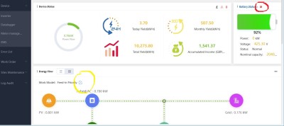

You can find a similar screen on the website but it's not the easiest to find it - go to the inverter details screen (which looks like the attached) - to get to mode scheduler click the item ringed in yellow, to get to the quick battery charge settings go to the item ringed in red.
Note you can't use scheduler and quick charge settings at the same time (it's one or the other)
