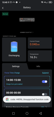

I have a H1-3.7-E inverter and as from last night I have been unable to alter the Force Charge settings on my Fox by the Android version 2 app, the web pages and even via the on unit keypad. Has anyone else had this problem?
I get Error Code 44096 Unsupported function code.
Does anyone have a solution?

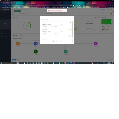

Hi - Am getting a "40257, Parameters does not meet expectations" error on my Fox 2.0 APP. I am also not getting the force charge option on the foxcloud inverter details settings. I am concerned the battery will charge to 100% and then discharge to my EV in the charge window.
- Posts: 1790
If you are trying to set the charge times in the V2 app they cannot cross midnight i.e. 23:30-05:30 is not allowed (although bizarrely it can be done in the V1 app).4TR wrote: Thu Sep 26, 2024 9:31 am Hi - Am getting a "40257, Parameters does not meet expectations" error on my Fox 2.0 APP. I am also not getting the force charge option on the foxcloud inverter details settings. I am concerned the battery will charge to 100% and then discharge to my EV in the charge window.
Instead set charge period 1 to 23:30-23:59 and then charge period 2 to 00:00 to 05:30 (or use the Energy Stats app which will let you cross midnight)
Thanks - that seemed to accept it , but i have lost the "Force Charge" option. (It was there yesterday). I have an electric vehicle and want to avoid the battery charging it during the period 23.30 - 05.30 while i am drawing the lost cost energy.
Its not on the app or the Foxcloud website (unless i should be using a different url). I am a new customer and got this installed on Monday so apologies for any dumb questions

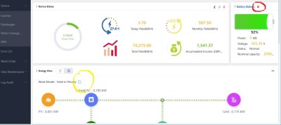

You can find a similar screen on the website but it's not the easiest to find it - go to the inverter details screen (which looks like the attached) - to get to mode scheduler click the item ringed in yellow, to get to the quick battery charge settings go to the item ringed in red.
Note you can't use scheduler and quick charge settings at the same time (it's one or the other)
