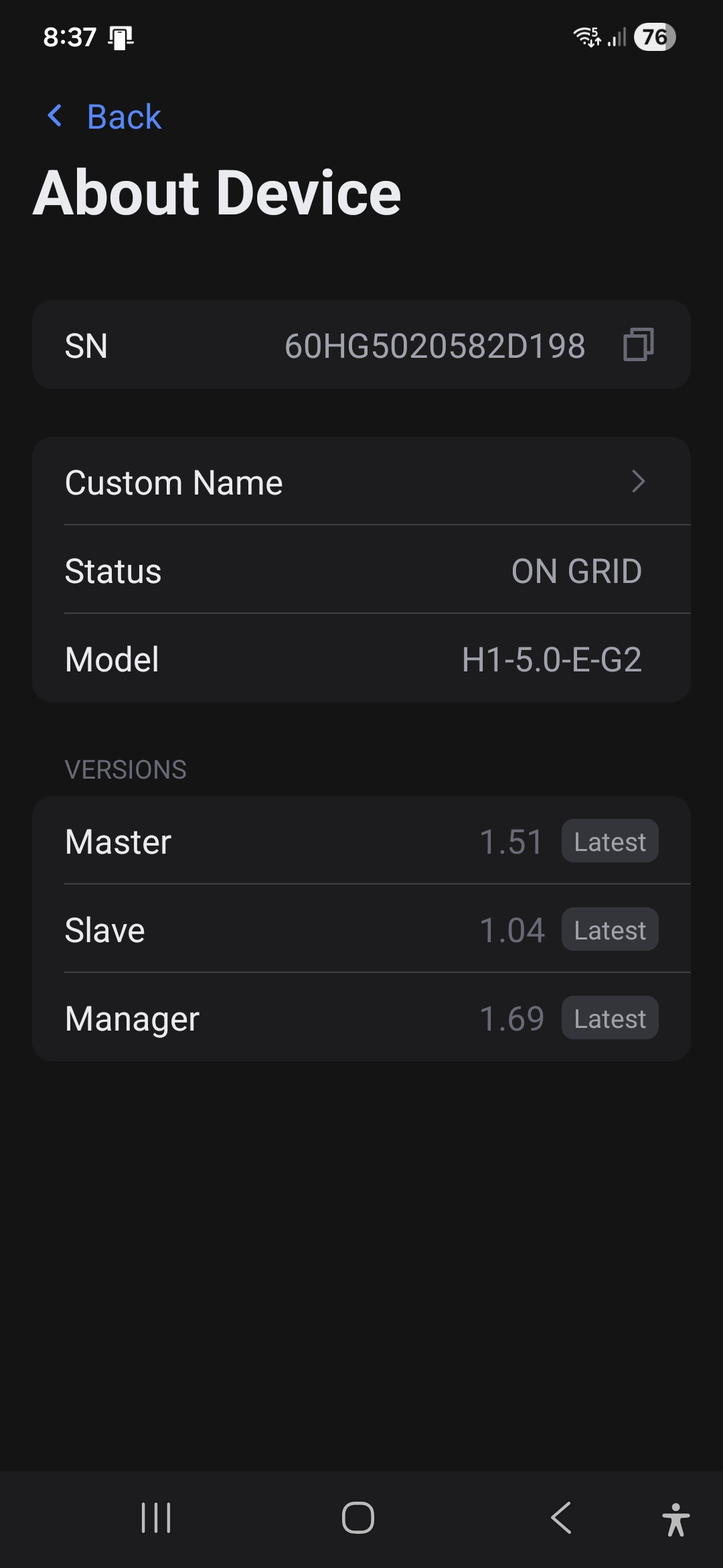

New user. Please be patient!
1 x H1-5.0-E-G2 inverter with 2 x 5 panels
1 x F3000 inverter with 1 x 6 panels
4 x ECS2900-2 batteries
Installed Jan 2025
Installed Jan 2025
