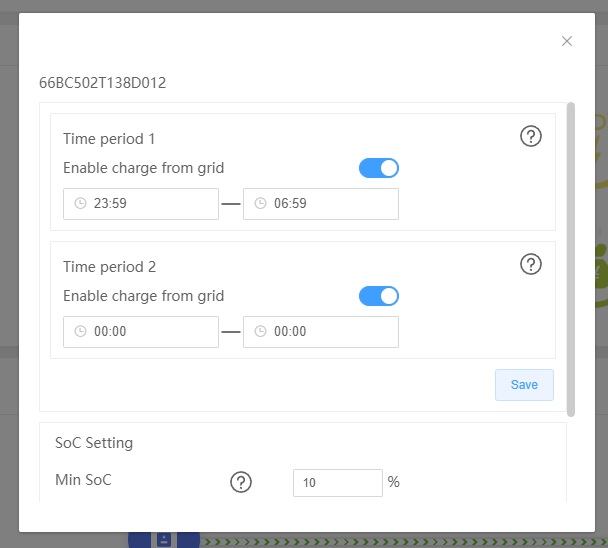

Hi, Can you tell me please how to accomplish this with the newer software for iPhone that has changed the options. As it’s getting nearer to winter it will soon be time to charge the EV overnight as apposed to the solar panels through the day and I don’t want to discharge the batteries. Thank you.
The app has removed the 'Force charge' switch however if you set a time period and leave the 'charge from grid' off then it will be the same as having the force charge switch on.Skip62 wrote: ↑Mon Aug 28, 2023 8:18 pm Hi, Can you tell me please how to accomplish this with the newer software for iPhone that has changed the options. As it’s getting nearer to winter it will soon be time to charge the EV overnight as apposed to the solar panels through the day and I don’t want to discharge the batteries. Thank you.
i.e. If you set a time period with charge from grid switched off, the batteries will not be charged from grid, they will allow charge from solar and will not allow any discharge (not feed the house).
For Grid Charging it is simpler than it used to be as now you only have to set a time period, turn the Enable charge from grid on and the batteries will charge between that period.
If you want to charge from the grid over midnight e.g. start at 11:30 pm and end at 5:30am then you set 2 periods.
Time Period 1: 11:30pm - 11:59pm, Enable charge from grid on
Time Period 2: 12:00am to 05:30am, Enable charge from grid on
If you want to charge from the grid from 2am to 5am then set 1 period
Time Period 1: 02:00am - 05:00am, Enable charge from grid on
Dont' forget to press the first 'Save' button immediately below the time periods

If you enable "Charge from grid" along with setting a start and end time, the system will charge until the battery is full or the defined period ends. If you don't enable "Charge from grid" but you only set a start and end time, the system will pull from the grid and not discharge the battery during that time.
If you set both start and end time to 00:00, that charge period is deactivated and the system will supply demand from the battery, subject to SoC and inverter capacity.

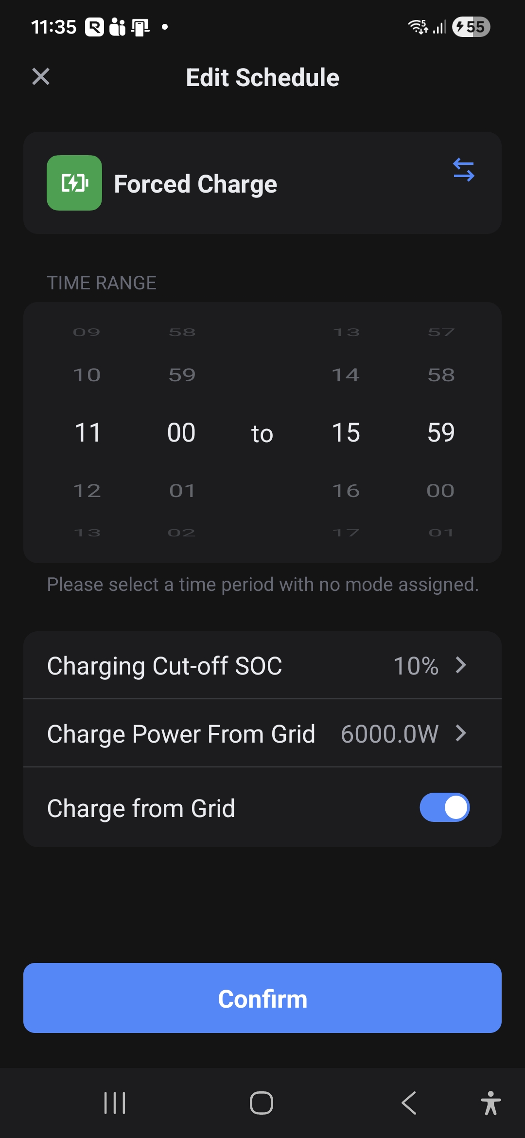

Hi Will. Firstly - thanks for making the effort to post your helpful and descriptive videos.
I am using FoxCloud2.0 on an Android. It is significantly simpler (better?) than the old app.
Unfortunately, all videos I have watched about Forced Charge assume you will force charge at night. I want to Force Charge in the daytime when the input rate in very low. Where I live, the only cheap electricity is 11:00-16:00.
The reason for doing this is to supplement a small (probably inadequate) 6kW of panels.
Here is my problem - during the Force Charge, when SOC reaches 100% it essentially switches off the panels, and powers the load from the battery. I would prefer that the system falls back to Self-Use after the battery is full, so that it power the load from solar if available.
Example:
Forced charge is configured 11:00-16:00
11:00 - Forced charge starts. It is a sunny day. Battery is at 50%. Panels are producing 6kw. Solar goes mostly to Load. Grid goes mostly to Battery.
13:00 - It is still very sunny. Battery is at 100%. Panels are producing 0kw. Solar stops. Grid stops. Battery powers the load.
16:00 - Forced charge stops. It is still sunny. Battery is at 90%. Back to Self-Use. Solar powers the load.
Result - 13:00-16:00 I have lost 3 hours of solar production

Yes this has been observed many times by users when the battery is full (or limiting charge).mikeincairns wrote: ↑Sun Feb 15, 2026 1:25 am Hi Will. Firstly - thanks for making the effort to post your helpful and descriptive videos.

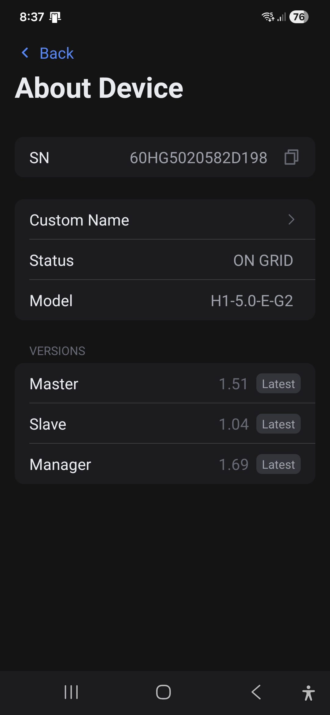

What inverter do you have ?, I know that there has been an update for the H1-x-WL which stops the PV shutting down - I think a good start would be to check your inverter firmware versions Master, Slave & Manager(ARM) and refer to the firmware page on here to make sure they are up to date; if they are not definitely get them updated - and go from there.

If you open the app, click on ‘Devices’, Inverter, then click on the serial number below the picture that will show you your Inverter firmware versions, i’m guessing they may be a bit behind - If you have the very latest firmware you may have the option in there to update your own firmware, but as that is a really new option only just being rolled out, I think you’ll have to go the traditional route and either ask your installer to update the master, slave, manager firmware (they can do it remotely), or failing that contact your local Fox support let them have your inverter serial number and they can push out the updates.mikeincairns wrote: ↑Sun Feb 15, 2026 10:14 am Thanks for the reply Dave.
I am completely ignorant about firmware updates. Is that something I can do, or something the installer does? On some posts it says it is done by an "agent" and others it suggests it can be done by an end-user. TBH - I am pretty confused.
Thanks for the instructions Dave.
This is what I see in the app. No idea if "latest" is true or not.
According to this https://fox-ess.tech/firmware-release-notes/ I have the latest.

ok, thanks - yes that's the latest so it's not a firmware issue, so it'll be a waiting game to see if Fox correct it on the KH.
Might be worth raising a ticket in the app 'Me', Contact Us, Support - so you add your voice to the others experiencing the same problem.
